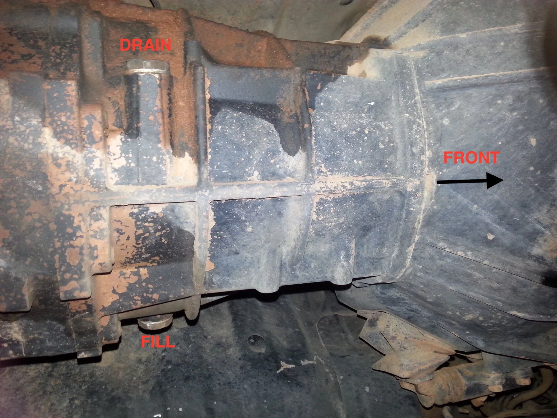

It should be the same; it is on my 105. Are you sure you're looking at the right things on the transmission? I'll try to get a photo of mine when I get a chance.

RangerDownunder - That would be brilliant if you could get a pic or two, there isn't much on the net specific to 105 cruisers. The fill plug is about halfway up the passenger side of the box and the drain plug is down the bottom on the drivers side and sits out slightly if that makes sense? I thought they would have both been 24mm, but the drain looks like it is a 27 or 28mm...

Yeah, sounds like you've got it right. Maybe somebody at some point put a non-OEM plug in? Because mine are definitely both the same as you can see in the photos.
The view from underneath.

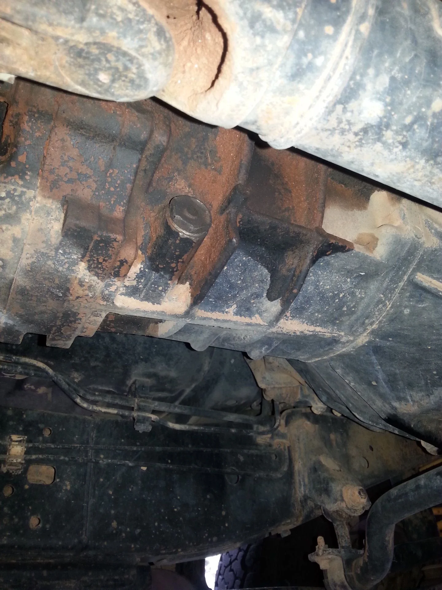

The drain does stick out a little bit.
As you can see, the same. I think they're even the same size as the diff fill plugs.

Thanks heaps for that mate! Turns out the drain plug was a 27mm socket, started to undo the drain plug then realise why.... Saw a lovely crack along the housing where the drain plug goes in along with silicone coming out while I was undoing the bolt :( They must have used a larger bolt to get more thread in I assume after the pricks cracked the housing. Short of welding it, any fixes that you could recommend?
