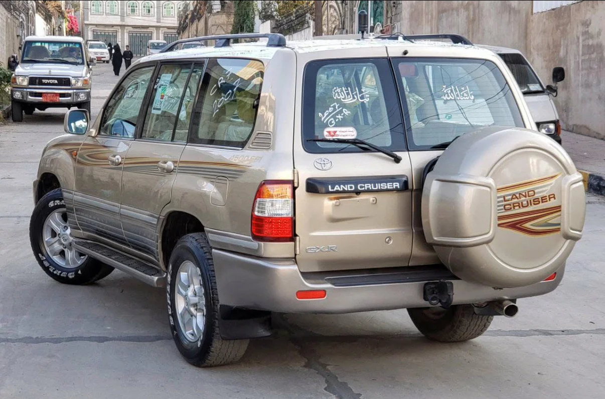

Anyone have this type off center license plate tailgate? tying to find the part number to begin search .

Yup that’s a JDM tailgate with the factory spare tire carrier. And this is the GCC barn-door version of it, off
Looks like you have the Ganador exhaust for the 100 series, it looks good. May just not be the ideal way it’s installed right now if you go off-roading, it will for certain catch off camber departure obstacles and will definitely get damaged.
