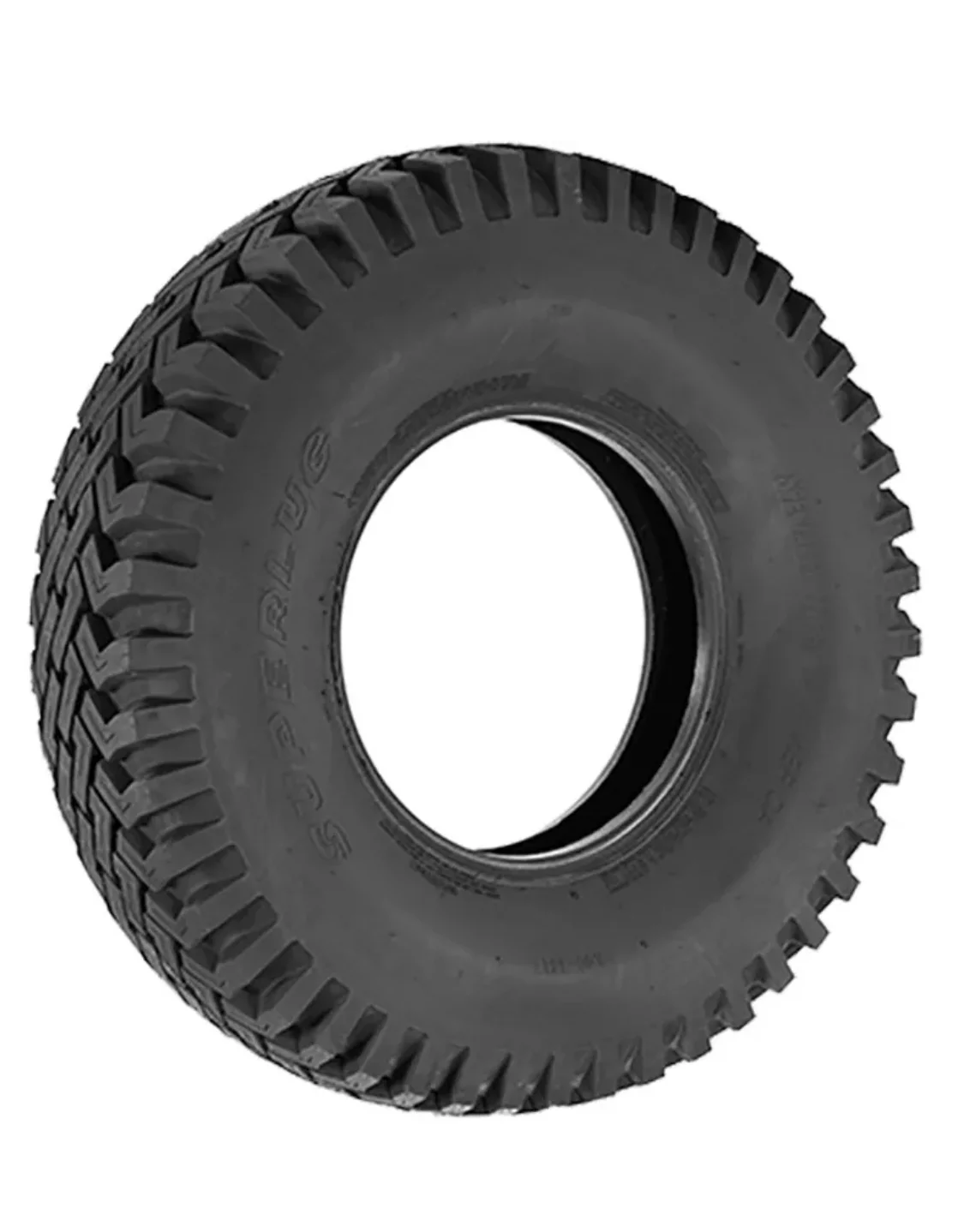

Little bit of a poll here, who would be interested in a tire around the 36x10(10.5)x17, or maybe for better wear 36x9.5x17? Say an E rated ATX type tire, semi agressive between an AT and MT, minimal sidewall topography, kind of a clean looking traction tire for our 17x6 alcoas and steel wheels? The idea would be a tall, great wearing ATX that you can run w/out spacers. My inspiration for this is the STA Super Traxion 900-16 (pictured which is a 36.3x9x16), the popularity of the 255/80/17s and the single MT 255/85/17. IMHO a taller option w/out the need for a spacer would be ideal, especially for the 4.10 guys. What are your opinions? I’ve posed the question to a tire manufacturer I’ve worked with in the past who may be receptive to popular positive feedback. Thanks for your thoughts.
