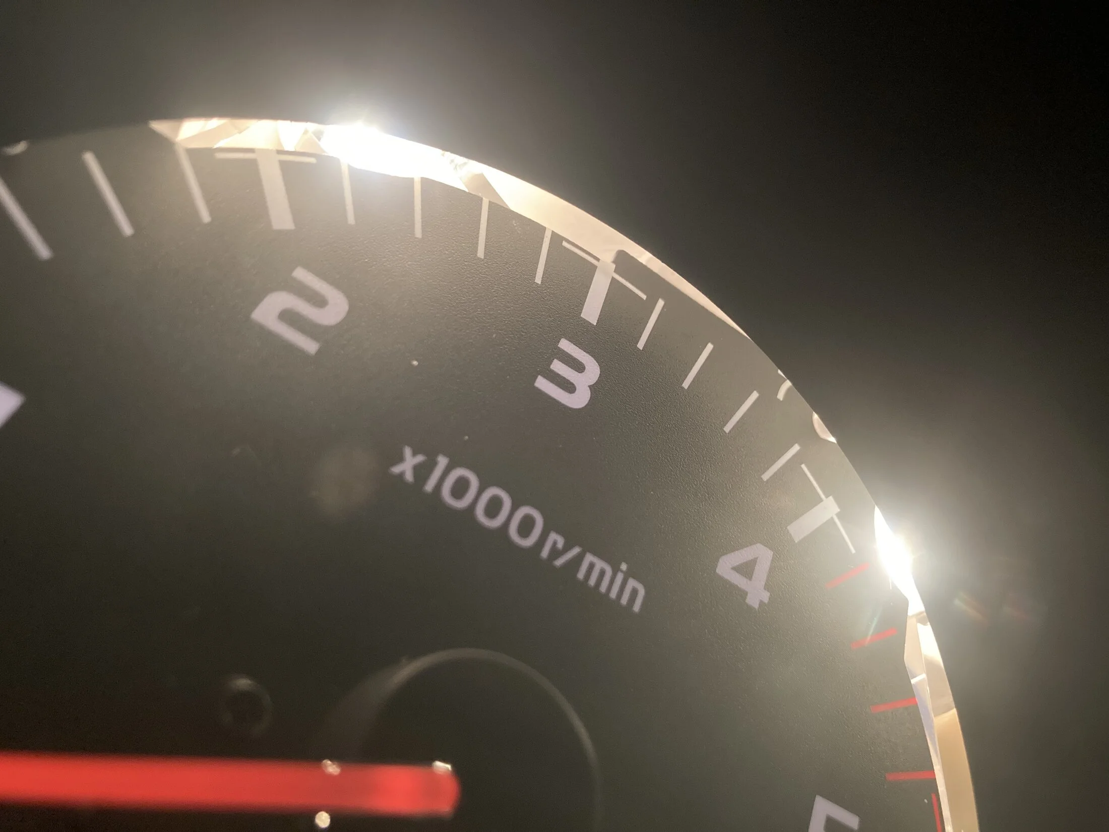

I left my truck at a shop for maintenance, which included replacement of a number of dash bulbs. Unfortunately, it appears they had tampered with the gauge cluster. I don’t get the backlighting.
Upon further inspection, the edges of the bezel looked like it had been cut out. It will be a pain to replace with an exact bezel let alone finding a matching gauge cluster.

Thanks for your comment. I also found the lighting to be quite unusual when I finally got to drive it at night as it wasn’t noticeable during the day. The edges appear rough and makes me question either why the gauges were touched or would come loose in the first place.

Good question. I’ve done so. However, it became clearer that the issue was structural, which gave me the motivation to look closer (hence the first set of photos). The edges of the bezel sits behind the bulb rather than the other way round. That’s why there is a hallo effect at the top, rather than being backlit.
