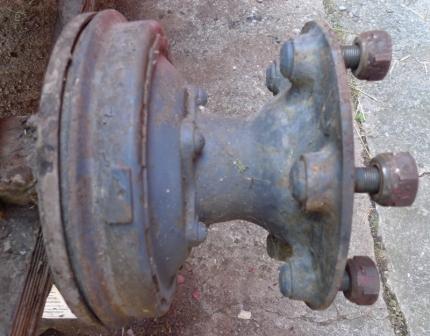

I was lucky/unlucky enough (???) to acquire a G-518 military trailer, also referred to as a Ben Hur, but this one is a real ex-mil G-518.
Right now it has the original 7.50-20 tires on some odd 6-lug configuration. The lug nuts are reverse thread and ~3/4" diam. The hubs these are mounted on are ridiculously long and have a drum brake set-up that then mounts to the end of the square axle. The mounting flange on the end of the axle appears to be 3-3.5" diam with a 5-lug set-up where the lugs are small, in the 7/16" or 1/2" size.
Ideally I'd like to just have some common/standard hubs mounted up so I can run common/cheap wheels & tires - though they'd have to be in the 35"-37" diameter to fit.
At any rate, I'm not familiar at all with this stuff and am slowly tearing down to get to the end of the axle to see what I have to start with, but does anyone know or have experience retro-fitting on an old ex-mil spec trailer like this?
Thanks in advance for any input.
edit: Pics:
pic 1: front of hub
pic 2: side shot of hub
pic 3: back of hub showing axle mounting flange

The trailer uses 5-lug drum parts with a riveted on adapter to covert it to 6-lug and space the tire/wheel out further. The GMC pre-CCKW and early AFKWX trucks had 5-lug hubs, and were changed to 6-lug when they went into full production. The 5-lug hub is likely a GM product.
I suggest you get a techincal manual. Portrayal Press has reproductions. This web site lists the various Ben Hur manuals.
TM info

A whole new 3500# axle can be had for ~$300, w/ brakes not much more. But if it's a collectible trailer, maybe best to find a buyer and use the cash to get a more suitable and modern trailer.

I've had one of these for a few years and just started to think about restoring it for use. It needs new tires, and since they seem to go for about $200 a piece and the rims on these things sound downright scary to work on, I was thinking about swapping axles. I drive a '00 F350 SuperDuty (Vegistroked) and was thinking about swapping the axels and trying to find some SuperDuty axels to put under it as I already have some tires for it, and I would like to keep the spares the same. Any ideas or thoughts? I haven't done any measuring yet, so width wise I don't know if they'll work, just throwing around an idea!
well for me the whole concept was to NOT spend money! so just going out and buying a replacement axle wasn't an option unless I could find a cheap one on Craigslist.
I still haven't torn apart the hub to get to the drum brake assembly and determine what "junkyard" possibilities could work but the springs on mine are almost exactly 48" apart and the mounting surface (last pic of mine above) is about 60" face-to-face. I think anything that has a WMS ~72" would work well depending on the dimensions of the wheels.
