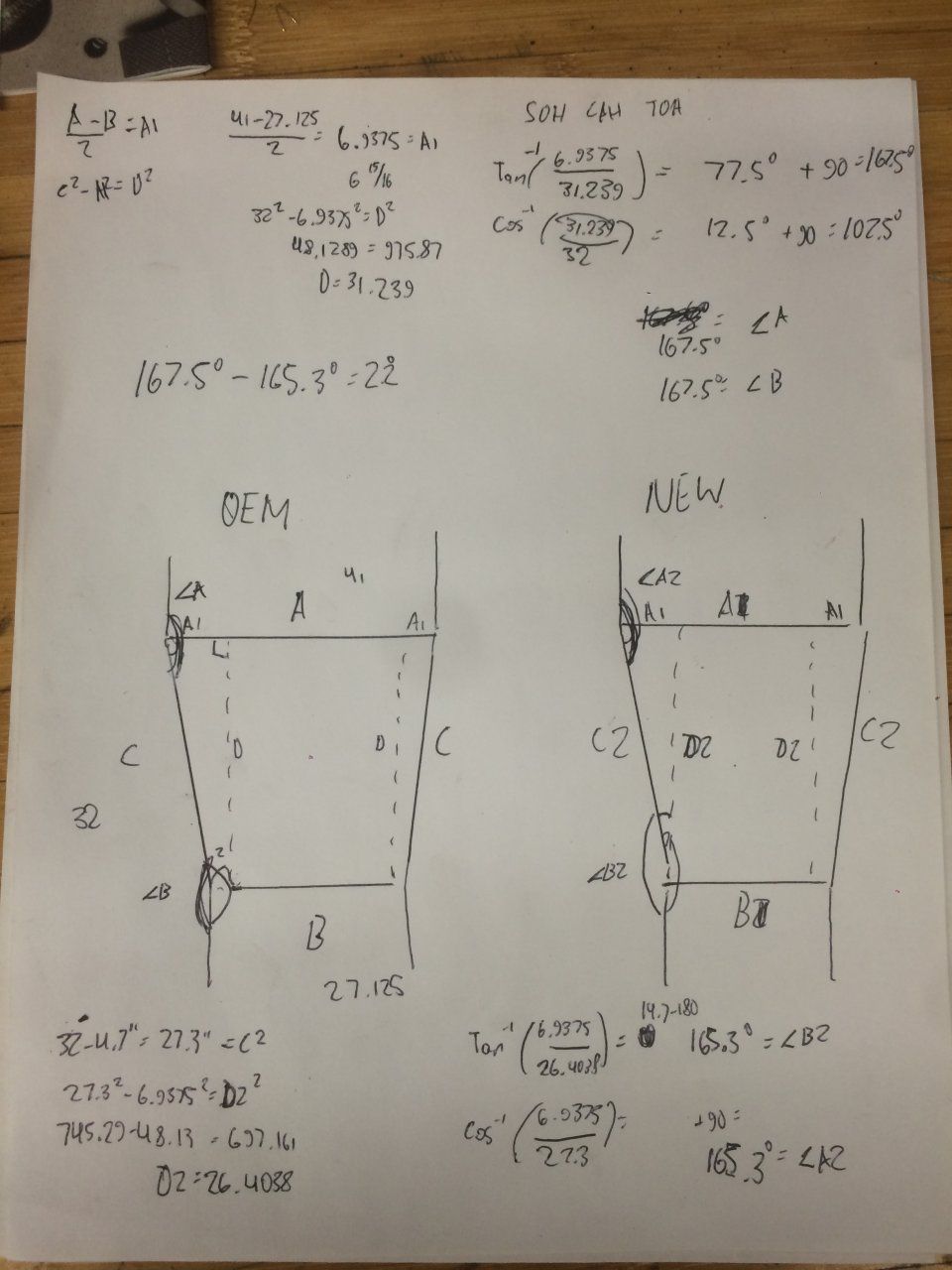

Picked up some metal...
Things are happening
