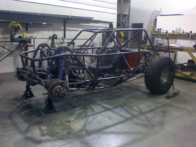

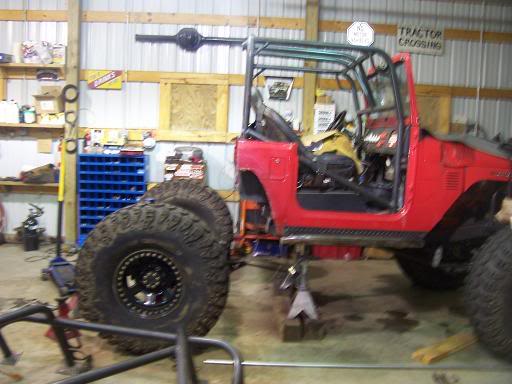

The control arms that I used made the wheelbase so long that the angle on the Airshocks was crazy. I had unloading problems with the Airshocks on my Cherokee when then were angled so I wanted to make sure that does not happen again.
Right now it sits at 119. I think that it is going to be a little long but it is easier to shorten it than lengthen it so I'm just going to wheel it and see.

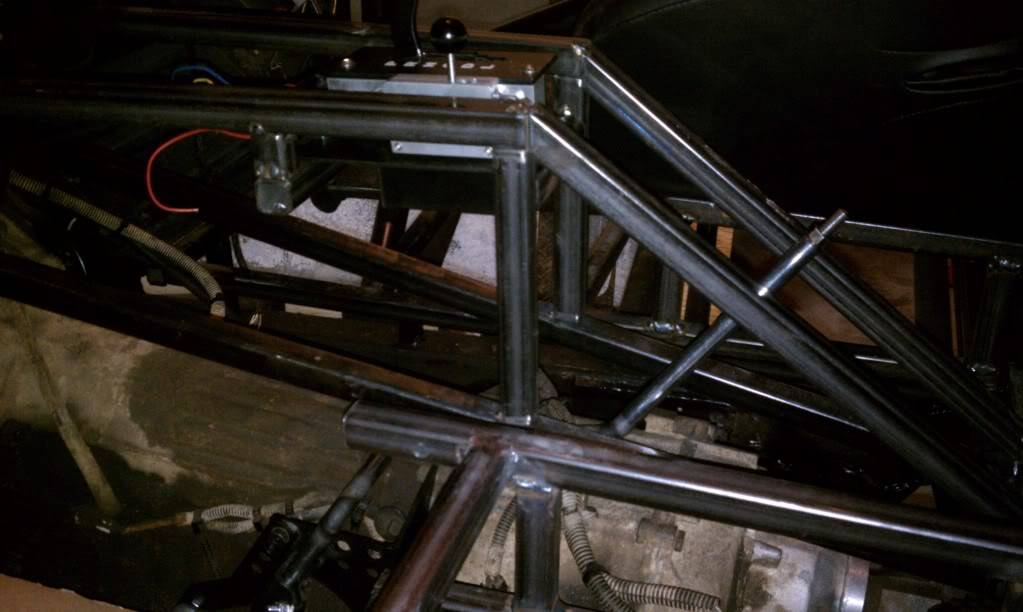

I got the shell of the center console done and lathed and bent the trans shifter.

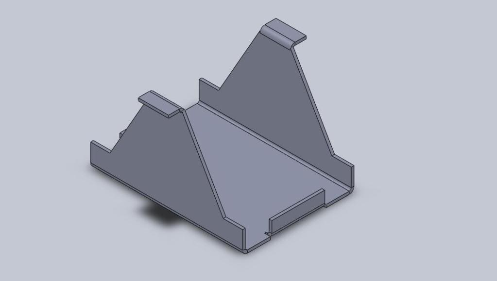

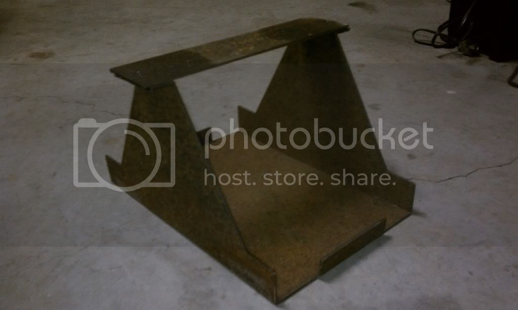

Well...I was busy tonight, got some more wiring done, and also designed the skid plate and made it too.
Here is the design of the skid plate:
And here is the skid plate once I cut it out on the CNC plasma:

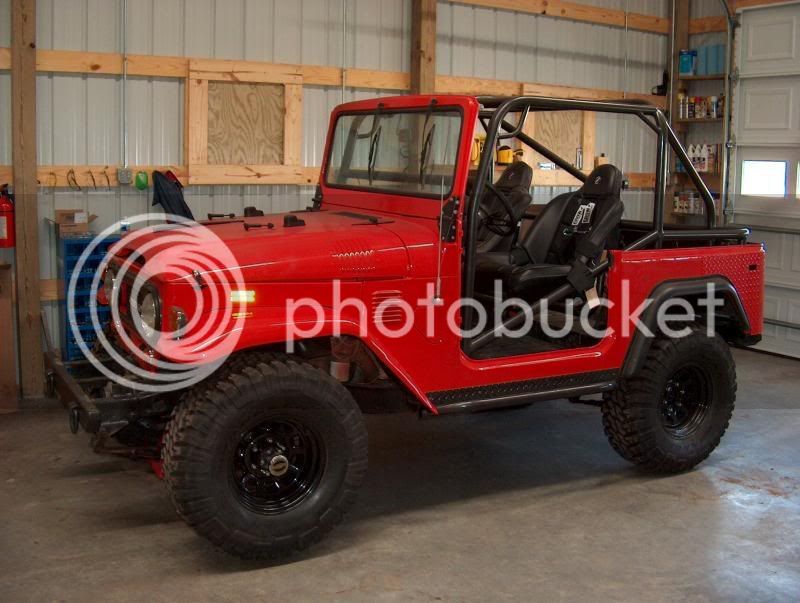

Damn, i miss this thing. I call first dibs on it if you ever sell it. I had some amazing times in this cruiser. My first rig. Got it when i was 15 after saving all year. Got it from a guy in gastonia who tried to sell me some "fighting chickens" with it. Being young and dumb in highschool with a cruiser on tons and a V8...good times. Cut my teeth in fabrication on this thing. The bumper that is still on there was the very first thing I built with a specific purpose. Take a tape to it...pretty sure it is 1-3" off center :D.
When I started.....yea...too clean.

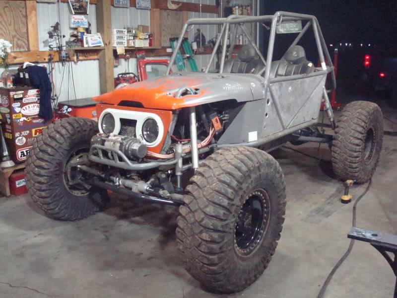

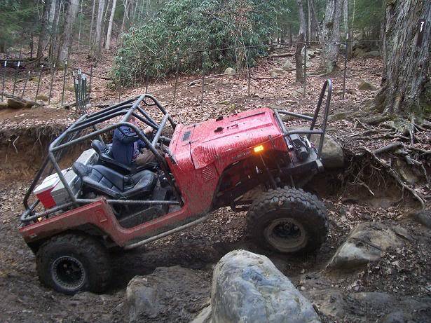

Moved on to build the cruiser buggy
And now building a racer

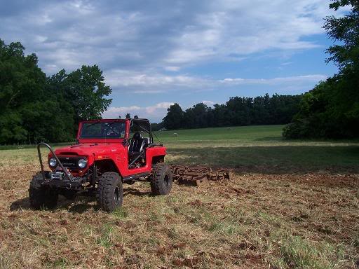

That is pretty cool. That 3rd and 4th pic are exaclty how I would want my 40 to look if I had one...... maybe a bit bigger tires
Thats awesome man....I really cannot wait to get that thing going !! I still cannot believe that I ended up getting the tires that were on it in the past.
