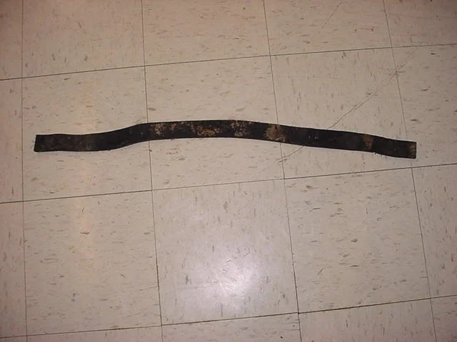

Fuel tank strapping felt on the lv?

Approx. 36" long x 1 3/4" wide and a good 1/4" thick. I would consider it a felt?
Any ideas on where to get something like this?
Thanks, Matt
Cut and pasted from there site. I'm thinking SAE-F-3,7 and 13 are in cut to length forms. Order up 12 feet and cut into what I need? All come in 1 1/2" widths? Which one do you think would work the best? F-3 has the highest vibration and abrasion absortion rate. I'm kinda leaning towards that.

Looking at Mcmaster I thought one of my suppliers might have the same stuff. I needed that to jump start my head Brett :doh:
I just got off the phone with MSC and ordered 4 - 5ft lengths of SAE F-3 felt in 1 1/2" x 1/4". I should have it next Wed. It has the highest rate of abrasion resistence and absorbtion, so I figured probably the best stuff for my application.
