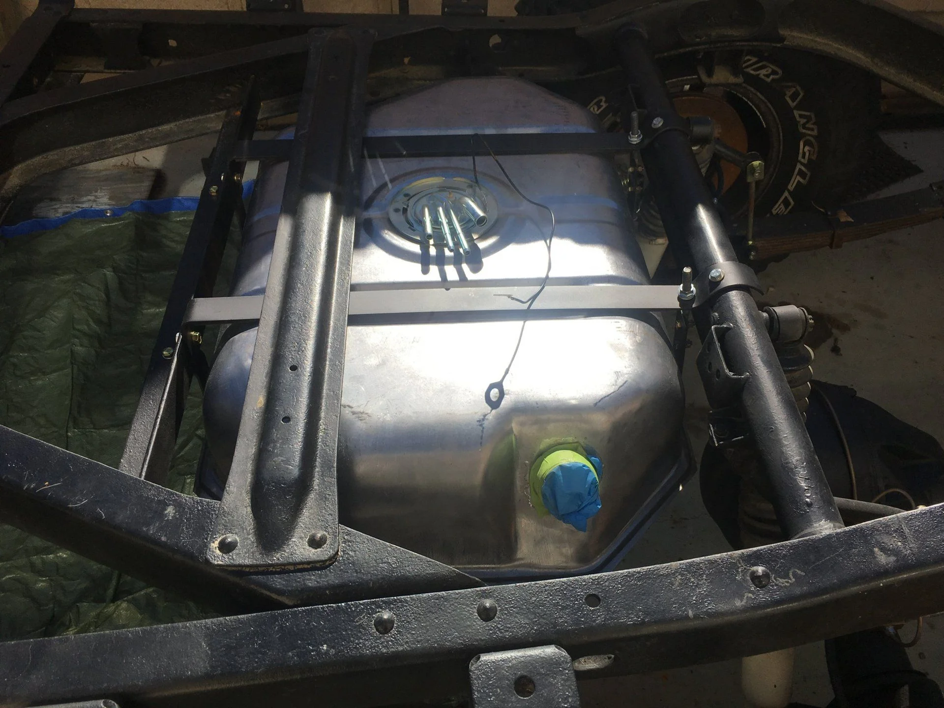

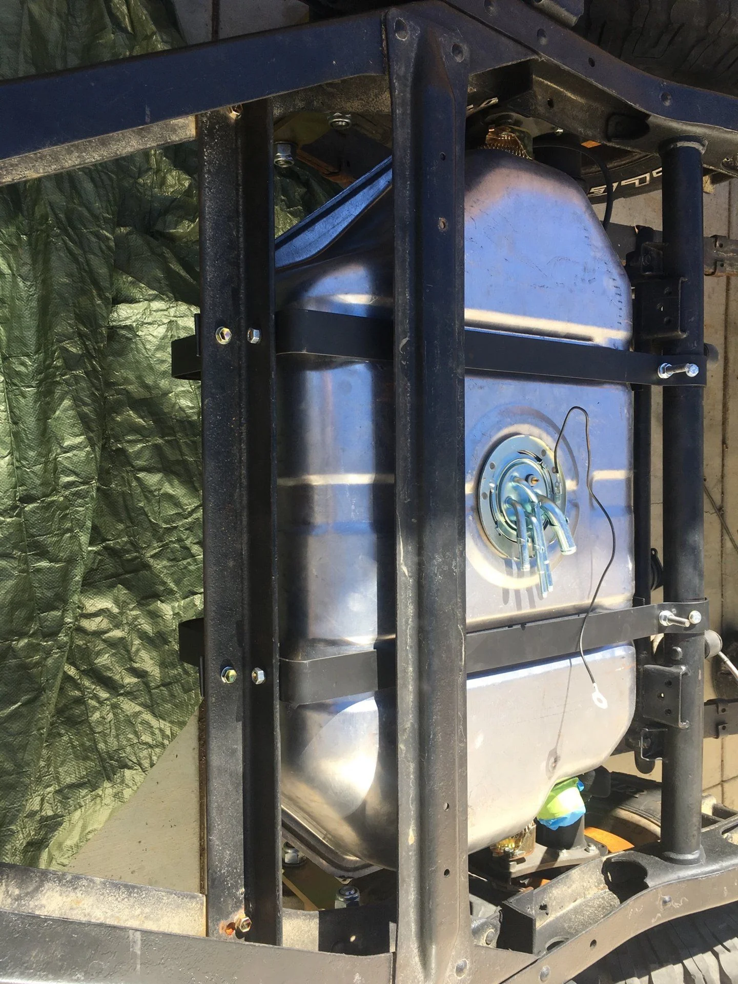

I don’t mind some cutting. I just want to see what others have done. I went with the S10 Blazer set up. Here’s a pic
Looks good but:
I thought the S10 tank would fit sideways in front of the axle and let you keep the spare tire in the stock location.
Did you consider this, or have I misunderstood the S10 tank mod for all these years?
There are actually two types of S10 tanks. The one like I have here and a more rectangular shaped one that would fit sideways like you're thinking. At least that's my understanding...lol
