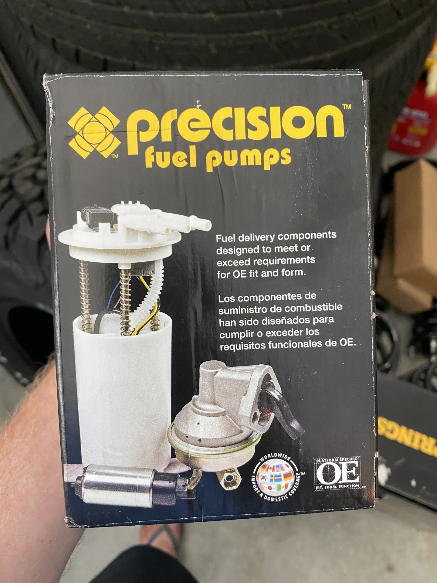

Thanks everyone for the help/advice. I replaced it today with a Precision/Carter pump (they have the same numbers on the housing, so likely all come from the same place. Was a 5 hour project with a buddy whose an electrician. I didn’t realize i needed a fuel filter, and had to make a second run to OReillys for some 90 degree elbows to route the fuel line without kinking it as we tried to re use the holes already there so it was tight. Also installed a relay switch since the new pump likely pulled more power and the original power line wiring with not likely thick enough. So the old power line became the new relay switch line, and i ran a new power line to the aux battery under the hood.
