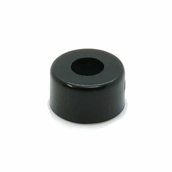

You can try these: Lexus Toyota Pintle Cap - https://injector-rehab.com/product/lexus-toyota-pintle-cap/
@JunkCrzr89, do you know if these pintle caps are vehicle specific? Do you think these NAPA ones would work?
https://www.napaonline.com/en/p/CRB215021
The caps aren’t necessarily vehicle-specific but they are brand + injector type specific. The ones you linked from Napa won’t work. The ones I posted above should work.
Thanks!
Those do look quite different than what came out of the truck though.
Almost looks closer to the RX8 Cap

First thing I did was go check. Sadly not. The link above seems to be what I needed anyway.
