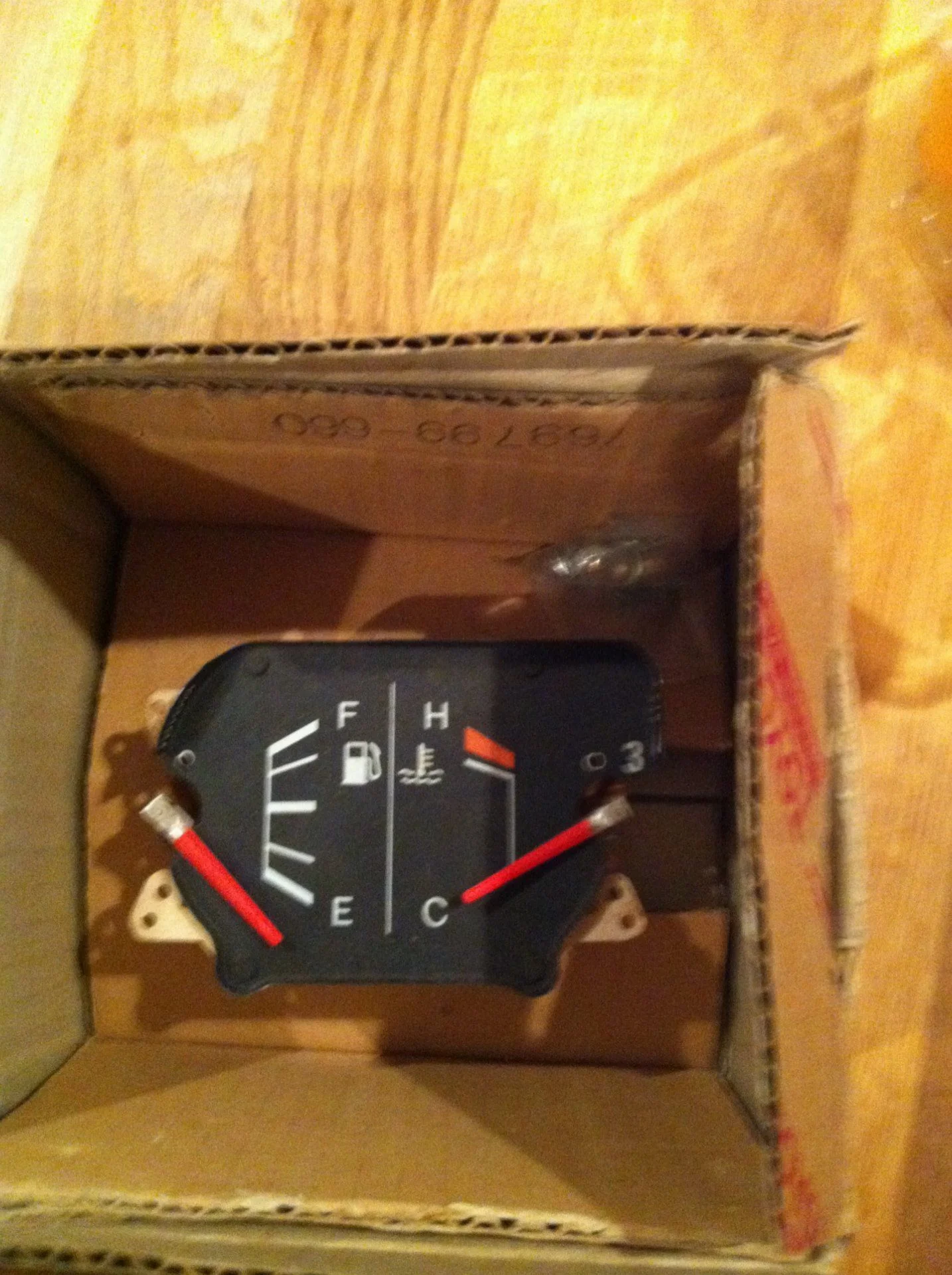

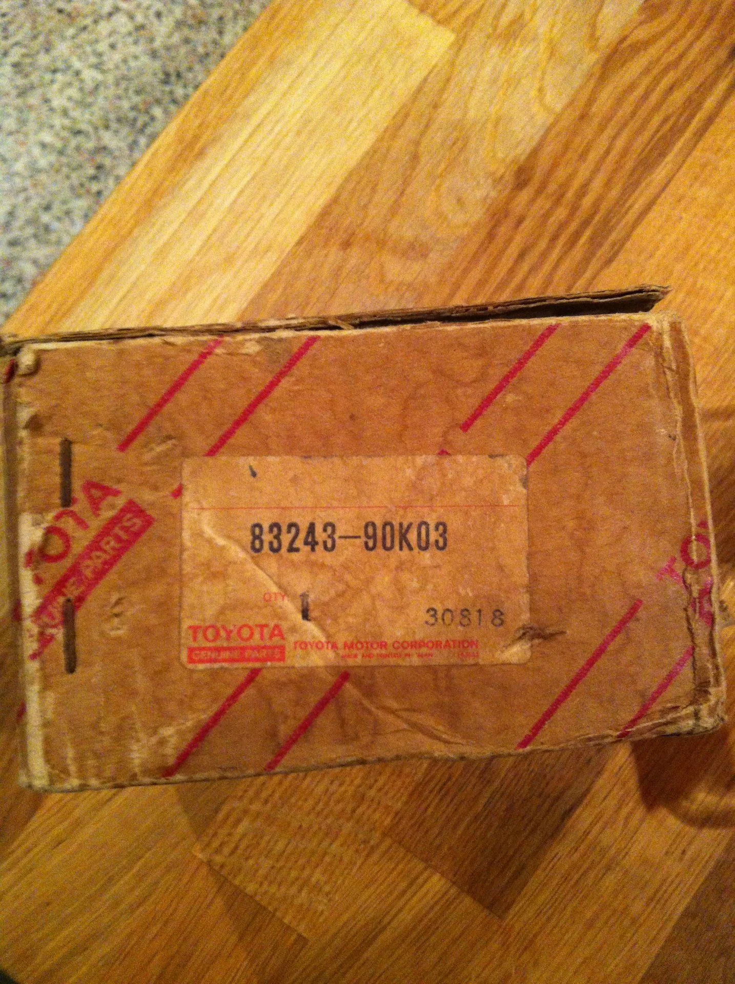

If your fuel gauge looks like this one....it is not an easy part to find and it is discontinued. I found mine on ebay.
full
full
Yes, that looks like it.
I think my diesel part number is the same except last digit is 6.
No idea what the difference between the 2 might be. 24 Volts?
Probably. I forgot about mine being 12V and JDM being 24V
