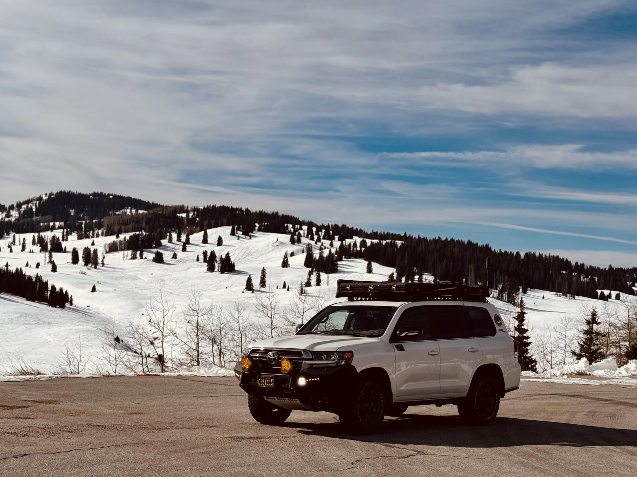

Some data that might be useful for those considering the fuel economy impact of modifications to their 200 series.
I have:
  • Dissent front bumper with winch
  • Roofnest tent on a low profile backbone, plus a Bush Company awning.
  • E&E skid plate and rear bumper
  • 285/65/18 KO2 tires at 42psi cold.
  • Harrop Supercharger
  • 2 adults, 2 30lb dogs, drawer setup, fridge- overall load about 650lbs.
