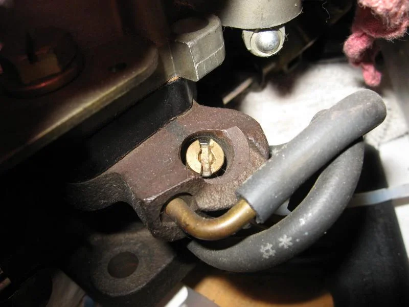

The idle mixture screw is normally capped. It is located on the valve cover side of the carb.
If the PO drilled out the cap then you'll be able to access the screw while the carb is installed.

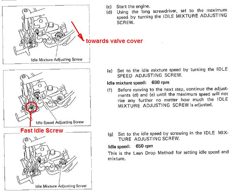

How to roughly set the idle mixture, using the Lean Drop method is described in the FSM.
Time to get yourself the FSMs and start going through them... Look on here for information on the LEAN DROP method as well. If the area that @Output Shaft is talking about has not been broken into DO NOT.... I REPEAT DO NOT break that seal unless absolutely necessary. Do everything else you can to get the carb running right, include rebuilding before you touch that screw.
If the mix screw has been de-capped, it'll look like this:
But I would go through the emissions FSM and verify that all the hoses are in the right spot. It's VERY easy to mess them up, even if you've been staring at them for 10 years. :p

adjscrew0001-jpg.261699
See what I mean ?
Search for Lean Drop

Then while the engine is running, micro adjust the MIXTURE screw, pausing to see which direction the rpms go, (slower or faster?) to the target rpm. 'Where it will rise no further' from the fsm is confusing. But you will figure it out. Over to idle SPEED screw, which brings the rpm back into 650 range, return to the mix screw, rising the rpm, back to speed screw, repeat until frustrated. until the max speed won't rise any...
700 rpm is fine.
One trick might be to have the choke pulled out, screwdriver into carb throat, set fast idle to near 1800 rpm (fast idle screw is different from the mix and speed screws), and then work toward the regular idle when the choke is pushed in? Then there is the throttle positioner. Study well the fsm.
