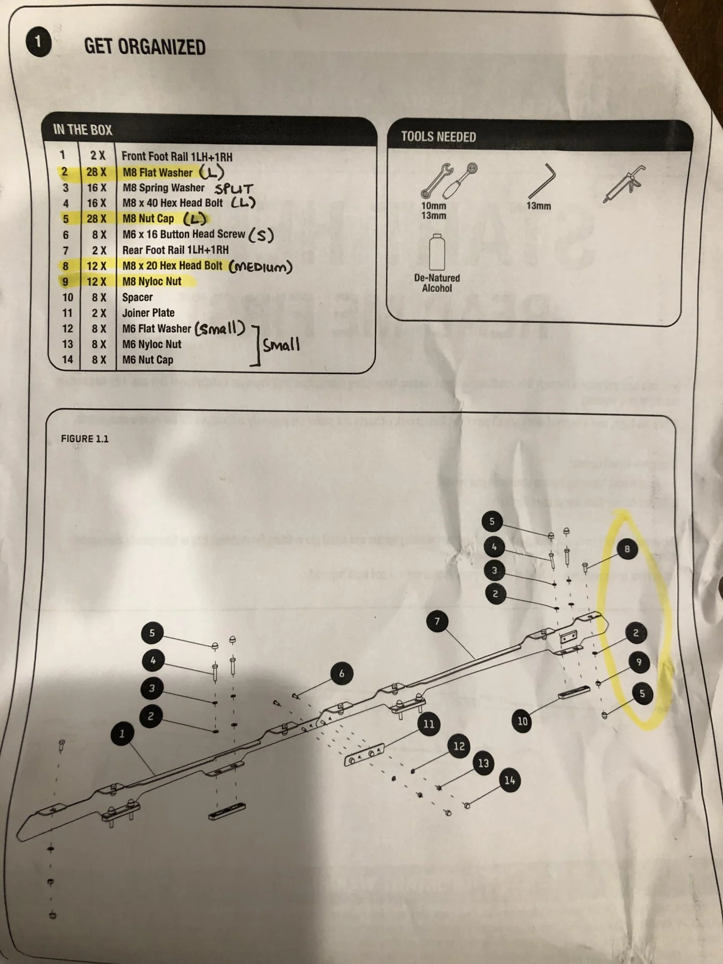

First time doing a mod to the LC200 and I’m pretty frustrated with the install of this FrontRunner Slimline 2 Low Profile version.
So everything up to the point of putting constructed platform rack part on to the roof footings was 100% according to the instructions. No issues up to here!

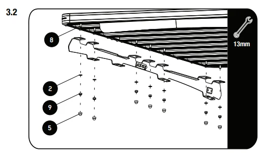

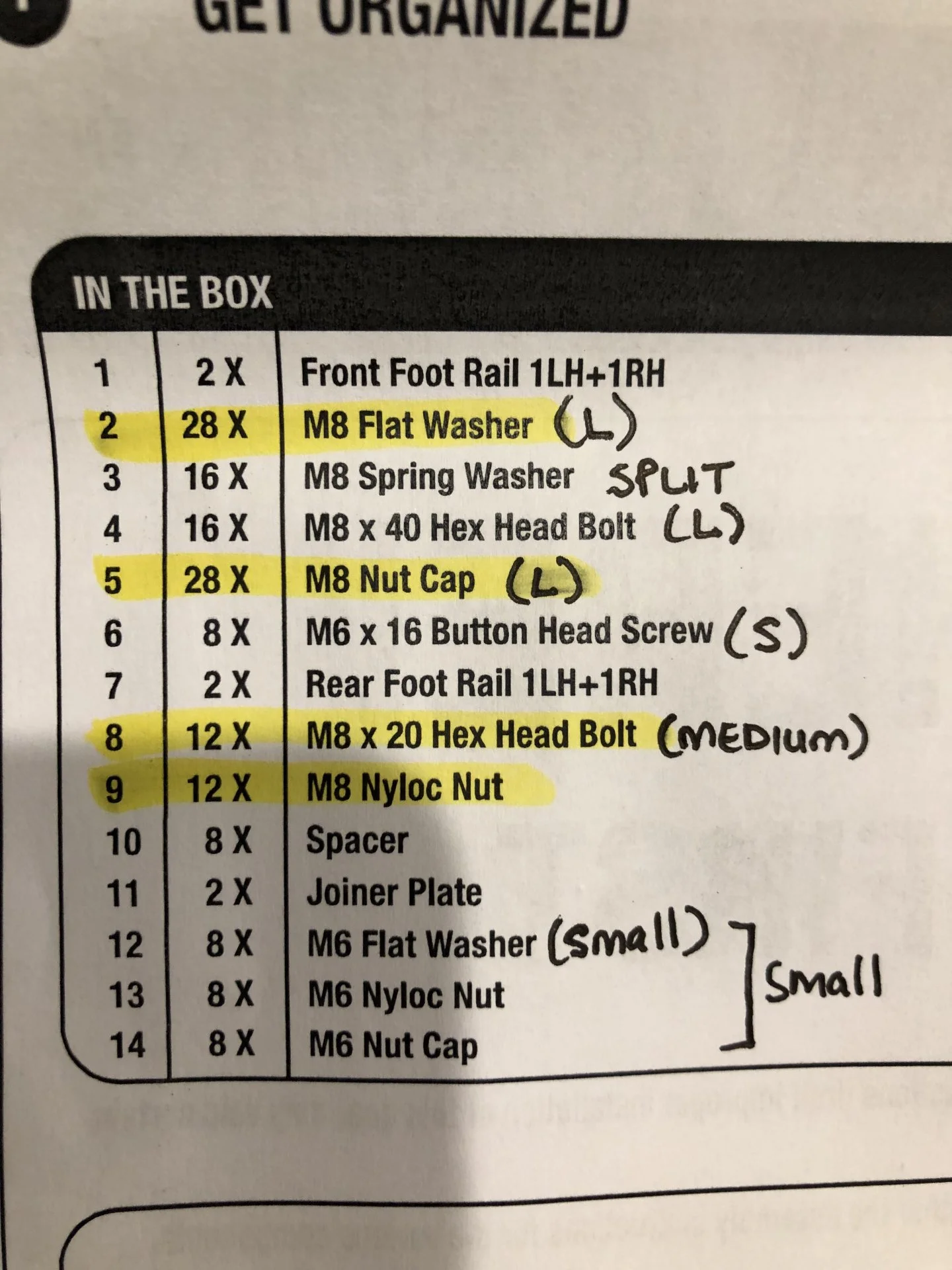

However, as you will see from the last diagram in the instructions, there are 7 bolt holes between the rack footing and the rack itself on each side. ie 14 holes so therefore 14 bolts washers and nuts needed! But they only gave me 12, and I thought maybe I lost 2 or they were missing, but 12 is what they have in their own instructions!!
The instructions even show a diagram with the 7 holes each side, using parts 8,2,9,5, but FrontRunner only give you 12 M8x20 bolts! ie as if it were 6 both side!
The temptation is just to go ahead and mount the 12 and add 2 more later, but the problem is to add more later you have to undo ALL the bolts to lift the rack to add in the next two missing bolts.
So I had to remove the rack after going to the trouble to recruit a good friend, only to drag them back again in future!
My question is, how the hell does the diagram show clearly 7 mounting holes both sides, meaning you need 14 bolts, but only 12 bolts are mentioned in the instructions!
Also, is the rack platform A UNIVERSAL LOW PROFILE one, or should it be specific to the Toyota Landcruiser 200? The footings are specific to the vehicle, but the platform isn’t???
I just ordered a Toyota Landcruiser 200 Slimline 2 Low Profile, and what came was specific ‘Toyota Land Cruiser 200 foot rails low profile’ instructions and a second box and instructions for ‘Slimline 2 tray universal assembly’
I wondering if that’s the issue or how else has nobody ever come across this problem before? The thing I needed 2 more of is part #8, the M8x20 hex bolts, and two more washers and nuts and covers obviously.

Frustrating. I would pause the install and call Frontrunner customer support Monday morning to get it sorted out. Worst case scenario is they will overnight you some hardware and a free t-shirt, or something.
I would venture to guess the rack is generic, but the actual mounting system that marries the rack to the roof is vehicle specific.
Take one the twelve bolts to your local hardware store and match up there. Why delay the installation waiting for the missing two bolts/nuts to arrive?
Like ARB the Frontrunner racks are generic and the mounting kits are vehicle specific.
I would contact them to make them aware of their instructions quantity error, so they can remedy it and the number of bolts/ nuts in the package.

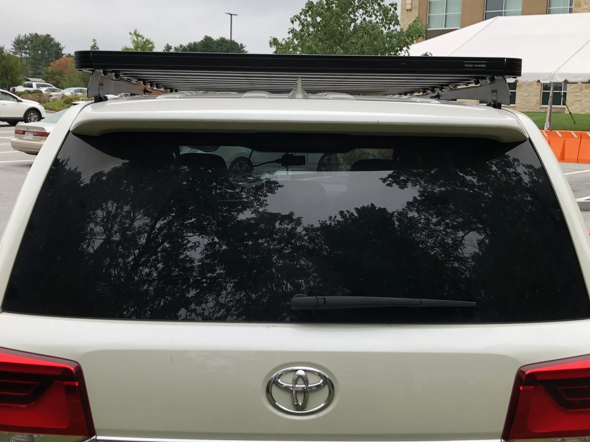

I’ll post some pics when done, it’s the low profile version of the Slimline 2
Main difference is you can’t fit the stainless steel table under the rack but I could put that in my RTT to be honest if needed
Can't spell "INSTRUCTIONS"? I think the assembly instructions are universal. They tray is semi-universal in the sense it can fit several different vehicles (with the vehicle specific rails), but is not a one-size-fits-all.
I think maybe if using the full length tray, you only need two bolts in the front, two in the middle and two at the back. IOW, one of the middle mounts is not supposed to be used? Qty 28 of number 2 and 5 also seem to confirm this. The back rail is also used for the half length tray I believe, in which case the 4 connection points would be used.
They sent the extra bolts/washers/nuts and I should be able to get this finished today
I downloaded the instructions, and figure 3.2 clearly shows all three center positions being used. So I agree the quantities of items 2 and 5 should be 14 not 12. Glad you were able to get this resolved.

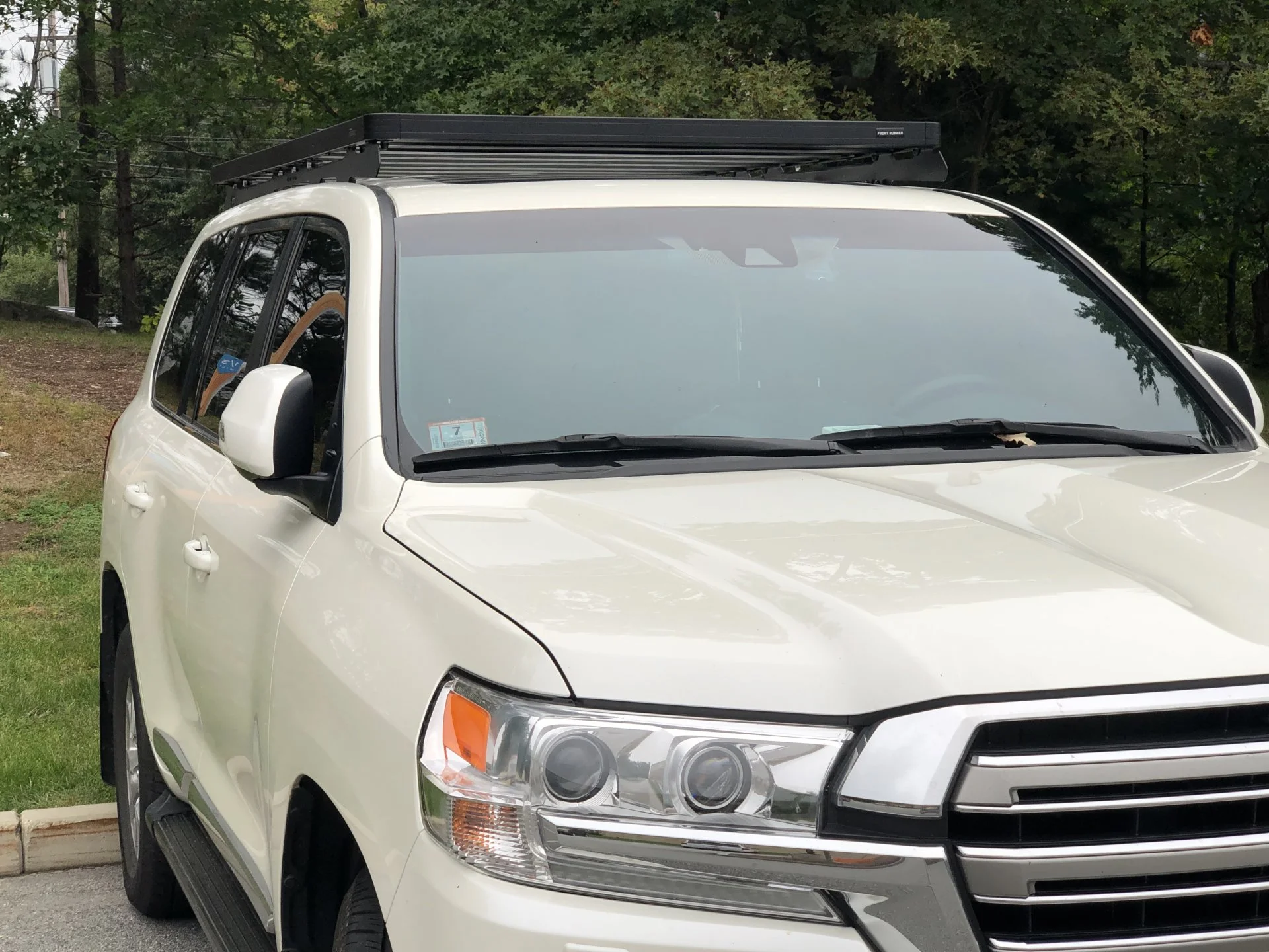

Nice to see FR is offering a low-profile mounting solution now for those of us with low garages. And that Rhino bumper looks great.
Post some pics once you get it installed.

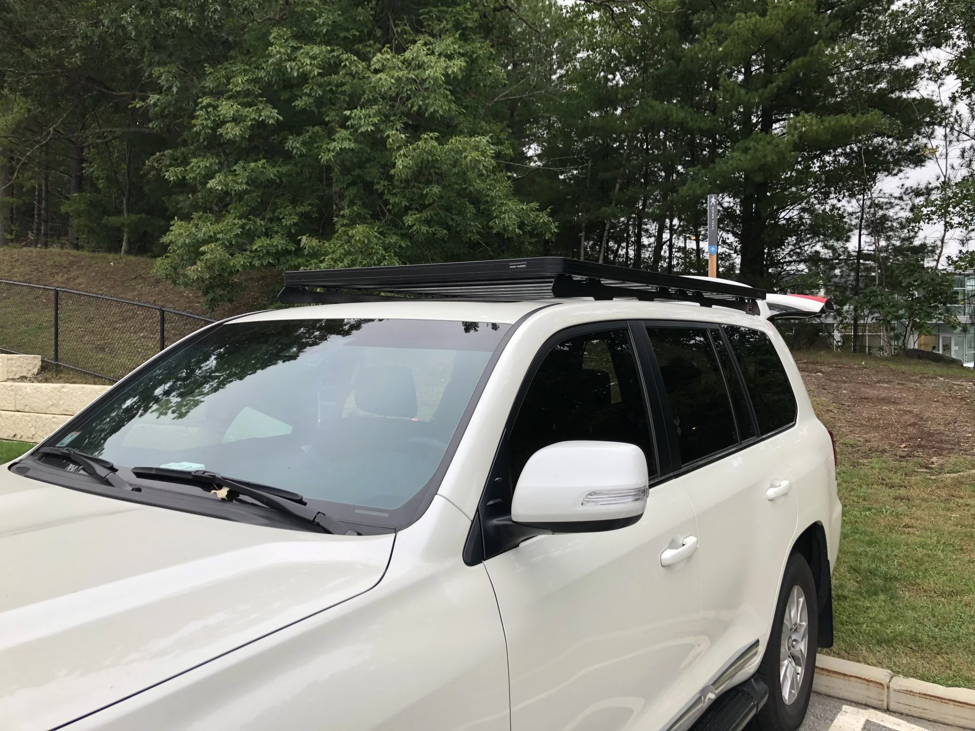

So I drove without the wind faring and 45-55mph it is very noisy with a lot of vibration. It would be too annoying to drive like that.
Fortunately I got the wind fairing, it’s specific to the low profile unit, and it’s honestly perfect, in reducing the noise by 90% and vibration completely gone
I wouldn’t get it without the wind fairing. Hope this bit of a write up helps.

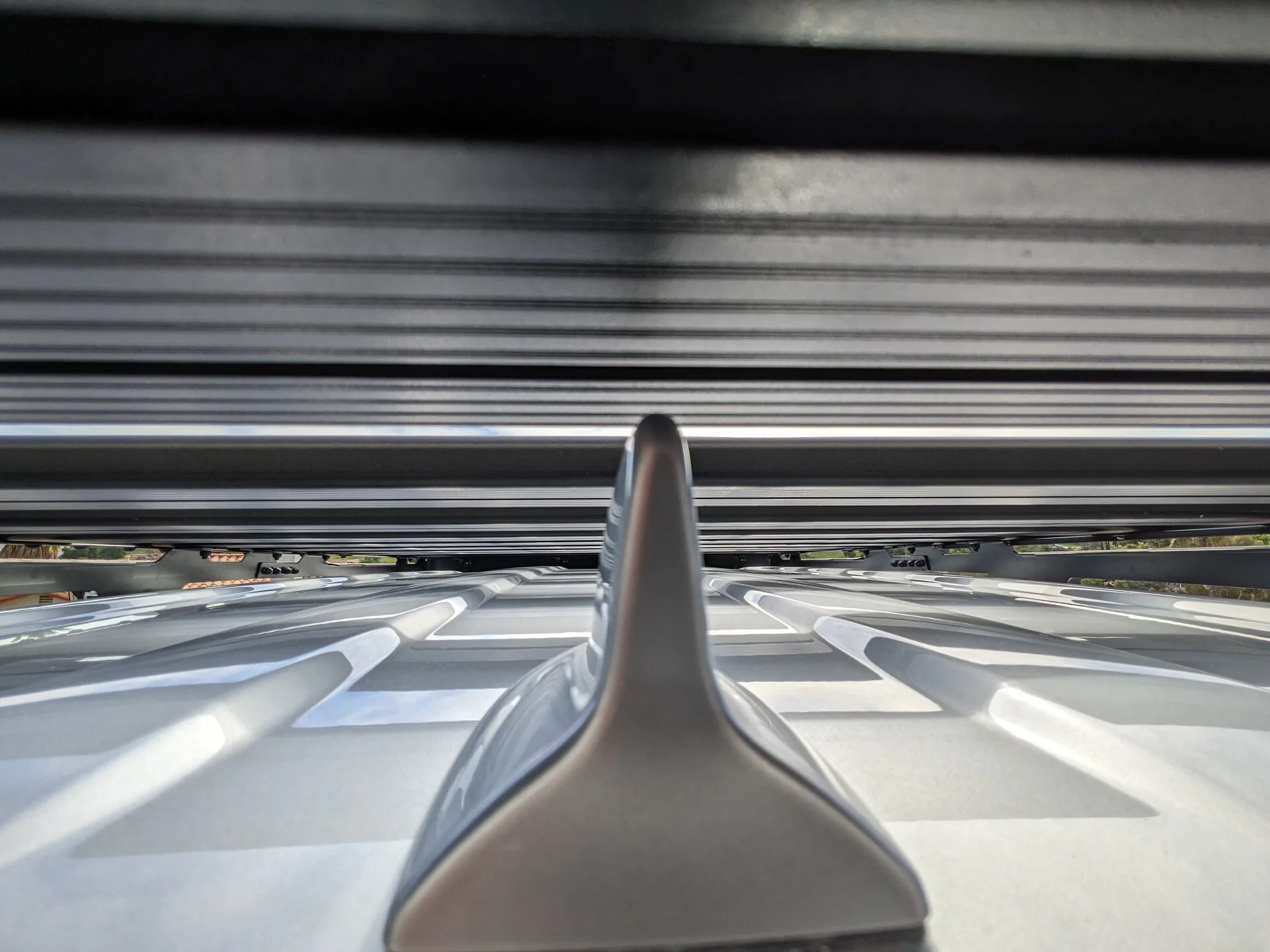

That turned out great!! Question for you . . . On Frontrunner's website the Slimline page has a note that says it's "Not appropriate for vehicles with the shark fin antenna." For that reason, I concluded it wouldn't work on my 2020 Landcruiser, and I would have to get the standard height rack instead. But this looks like it fits perfectly over your antenna. Any issues there?

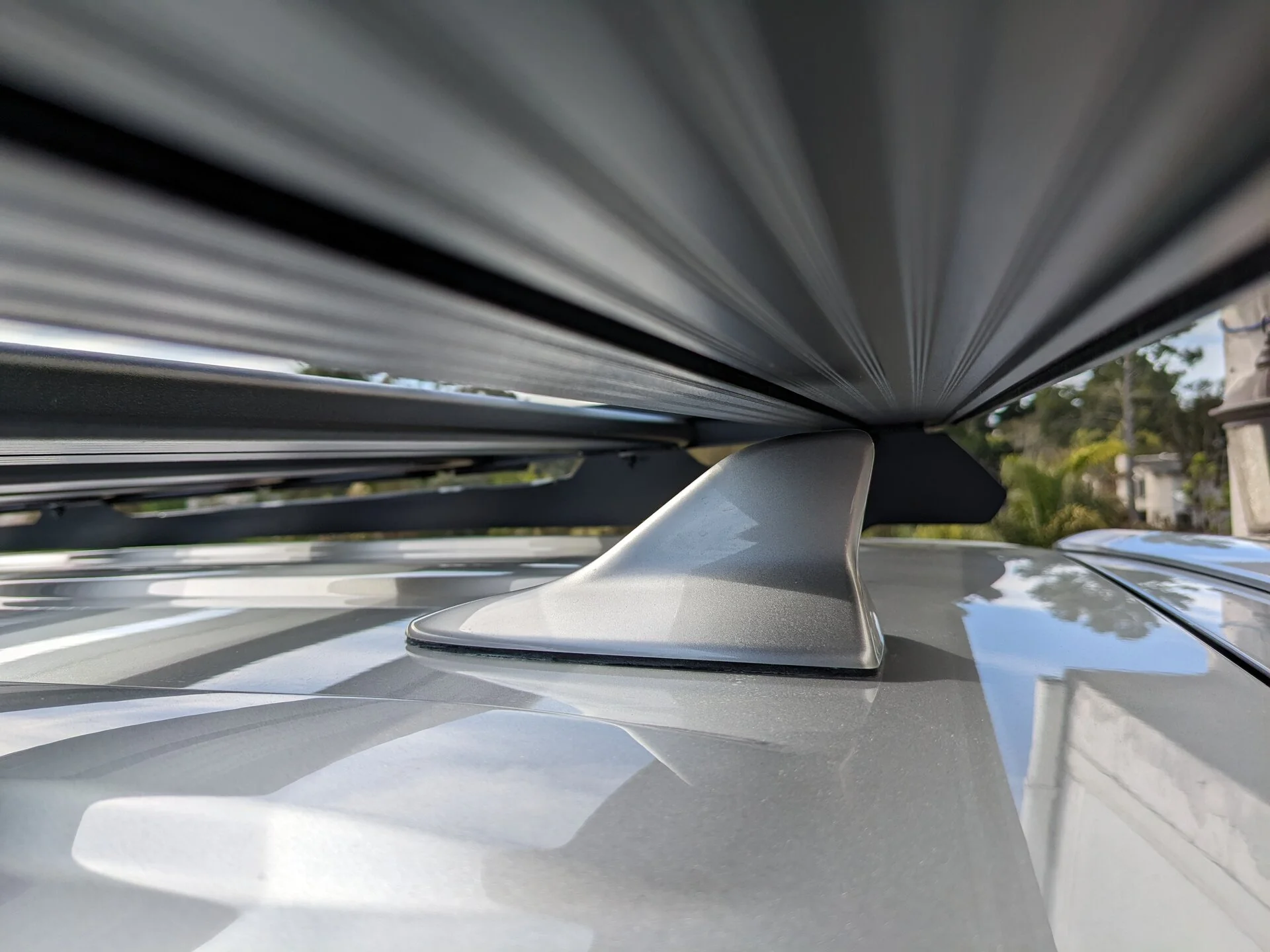

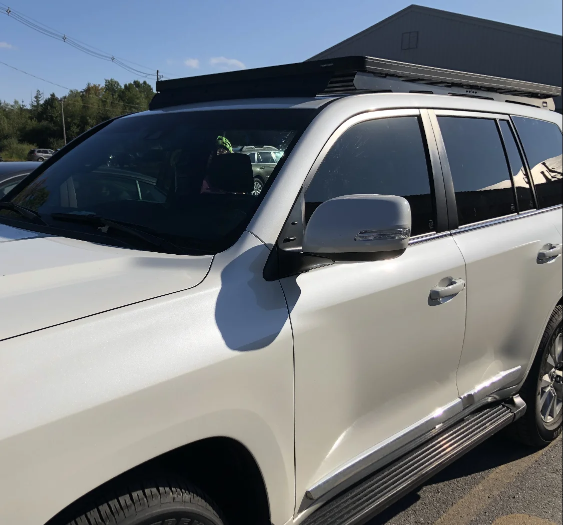

I just got my low profile Front Runner rack installed, and can confirm there is enough clearance with the shark fin antenna. I drove around without the fairing and it was loud as I was expecting. I installed the wider full fairing but haven't driven with it on yet.
Also, I was also missing some hardware as @Eire32 was... The bolts were there but I was missing two M8 flat washers (item 2 in the above picture). Luckily that didn't hold up the install and I can install the two remaining nuts once I receive the washers (yes I can use any old washer I get it, but I am still going to request some from Front Runner so they all match). Take inventory of the hardware before you get started on the install to avoid delays.

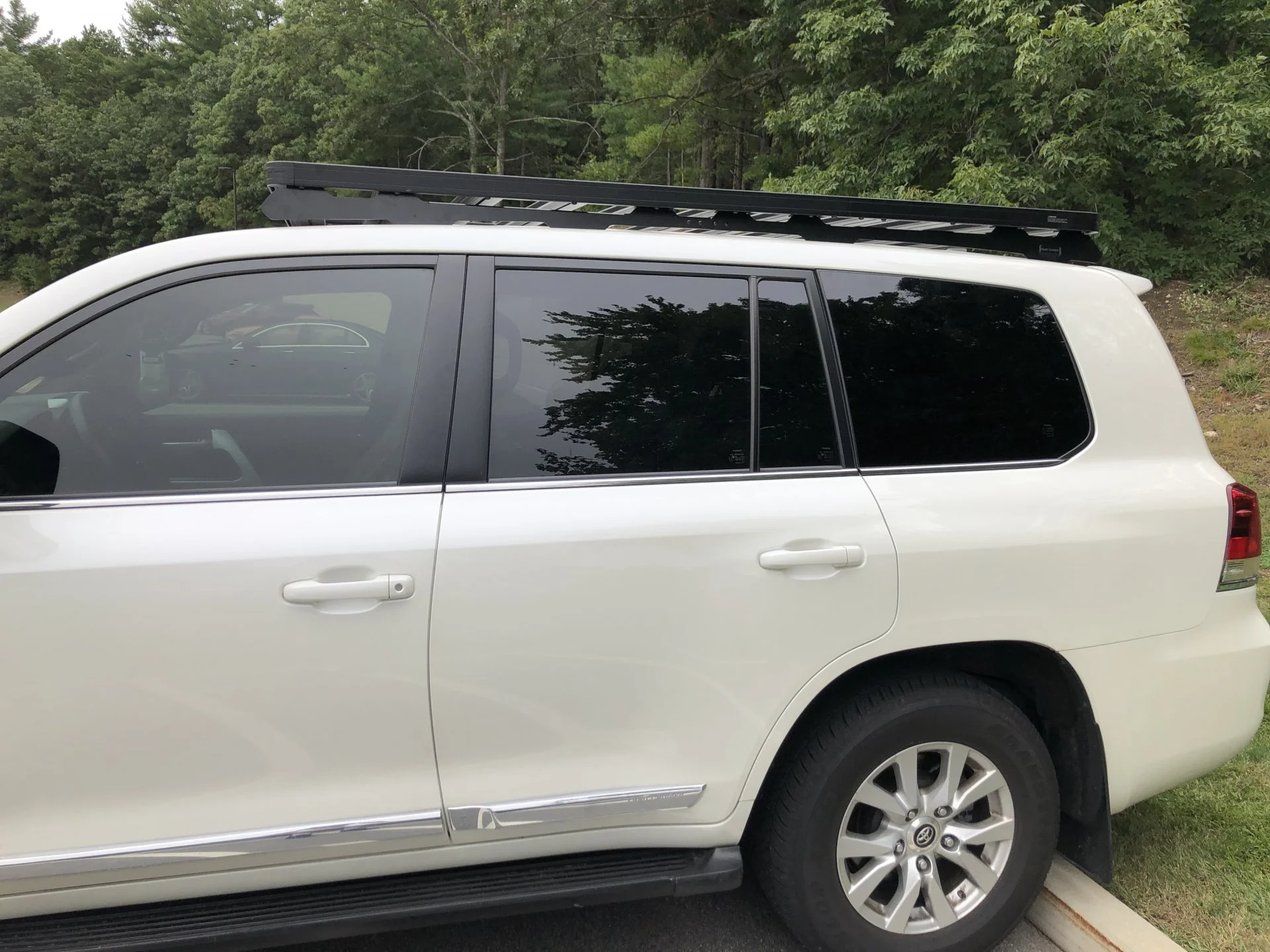

Just to close this out. I had a chance to drive around with the fairing on today. Very much improved over no fairing and I was happy with the noise level. Really not much louder than the factory rack.
For the low profile rack, there is 3/8" clearance between the tip of the antenna and the slat directly above it.
