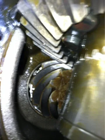

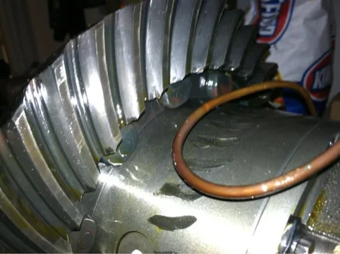

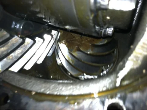

Pulled the front 3rd tonight because the pinion nut had come loose, and when I retorqued it - it was soon apparent "somefin' ain't riiiight" . Well, suspicion confirmed. Looks like the pinion was getting pulled in and out and trashed the inner pinion bearing. Looks like some teeth are chipped on the inside edge of the ring gear. Even looks like the pinion gear got into the housing on the ARB (luckily, there appears to be only aesthetic damage there). Yowzah!! Guess it's off to "The Bearded One" for a rehab.

Yeah... that's what I figured as soon as I couldn't turn the pinion by hand with the axles out. :doh:

I'm thinking I can get away w/ R&P and a "minor" rebuild kit. The carrier bearings don't have 300 miles on them probably. Agree?
