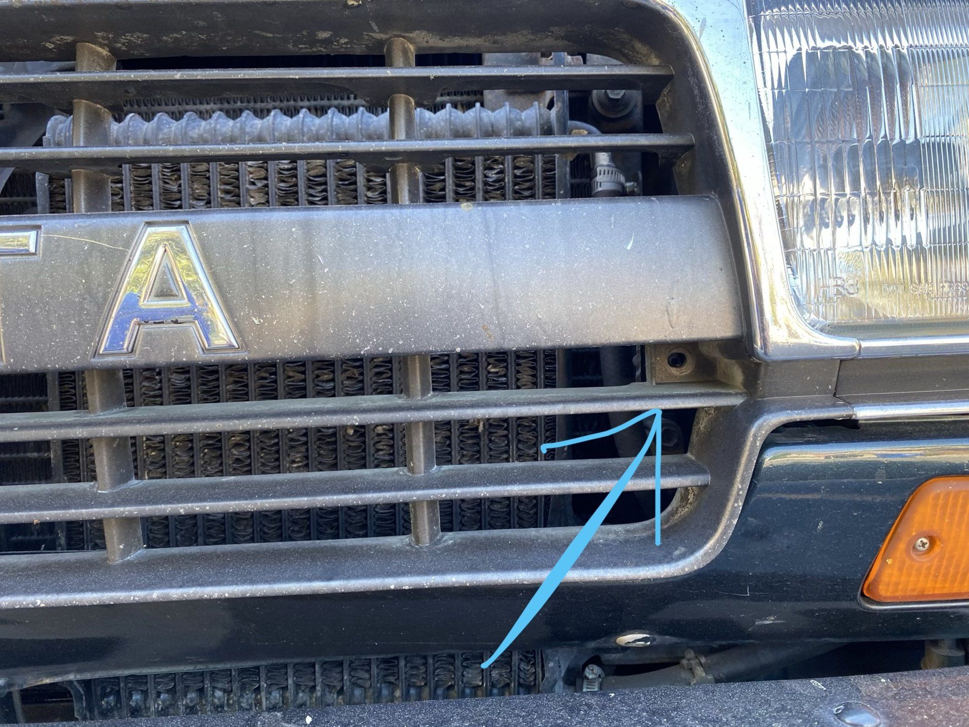

Anyone know where I can get front grill clips for my 94 LC? I don’t even know what they look like. My grill has been held by the top screws and it’s driving me crazy.

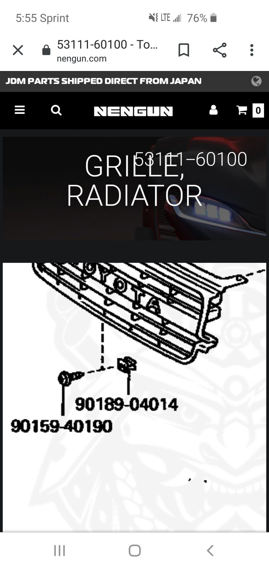

They push into the headlight bracket and then the screw screws into it.
Part number for the retainer:
90189-04014
Don't forget the screws:
90159-40190
