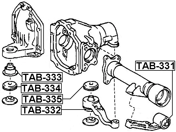

Needing to replace the bushing inside the support arm and the bushings to the one just across from it. Some videos said febest. Does anyone know the part numbers or have recommendations besides febest?
My shop is having trouble locating on their own since Toyota doesn’t offer these
FEBEST:
I wasn't able to find the parts, besides the one below anywhere in the states:
Amazon product ASIN B00R97U11U
The rear diff bushing that gets pressed in, I could be wrong, but they don't recommend it being replaced. The front one takes most of the abuse.
There's also a bushing on the banana looking thing that you can either replace the busing or the whole unit. I don't recall the part number for that one.
