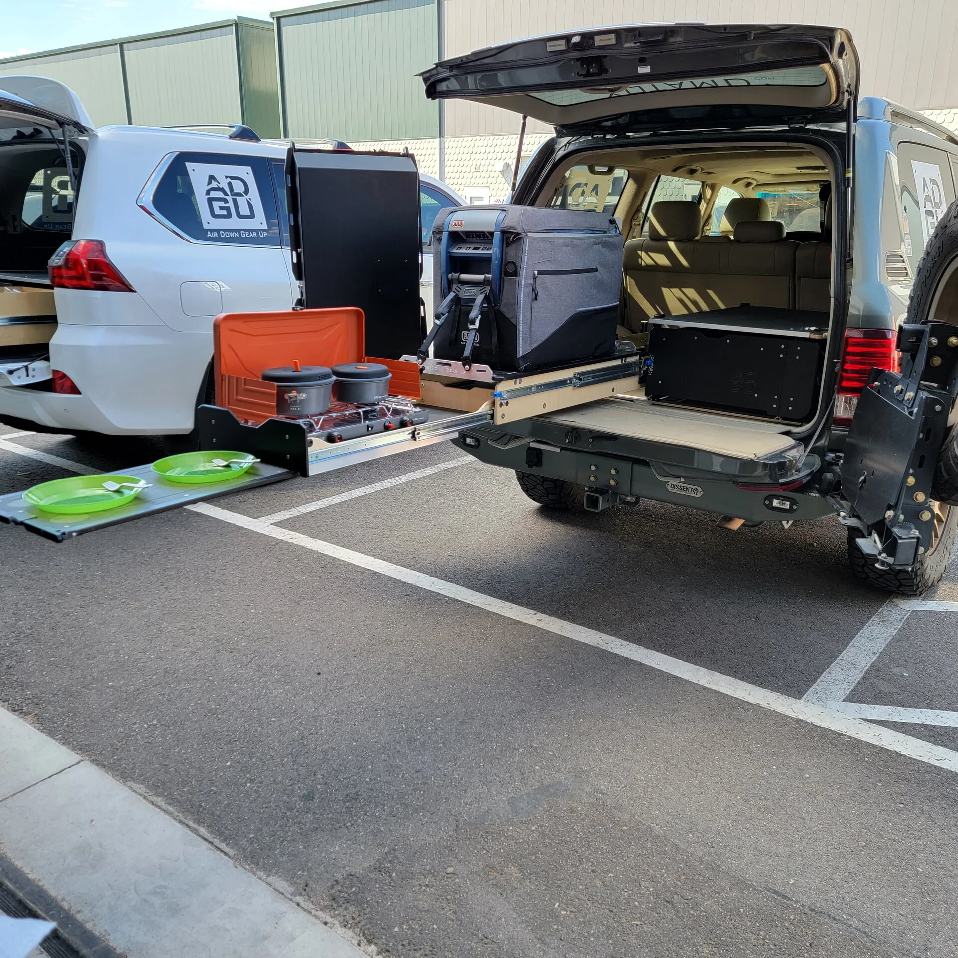

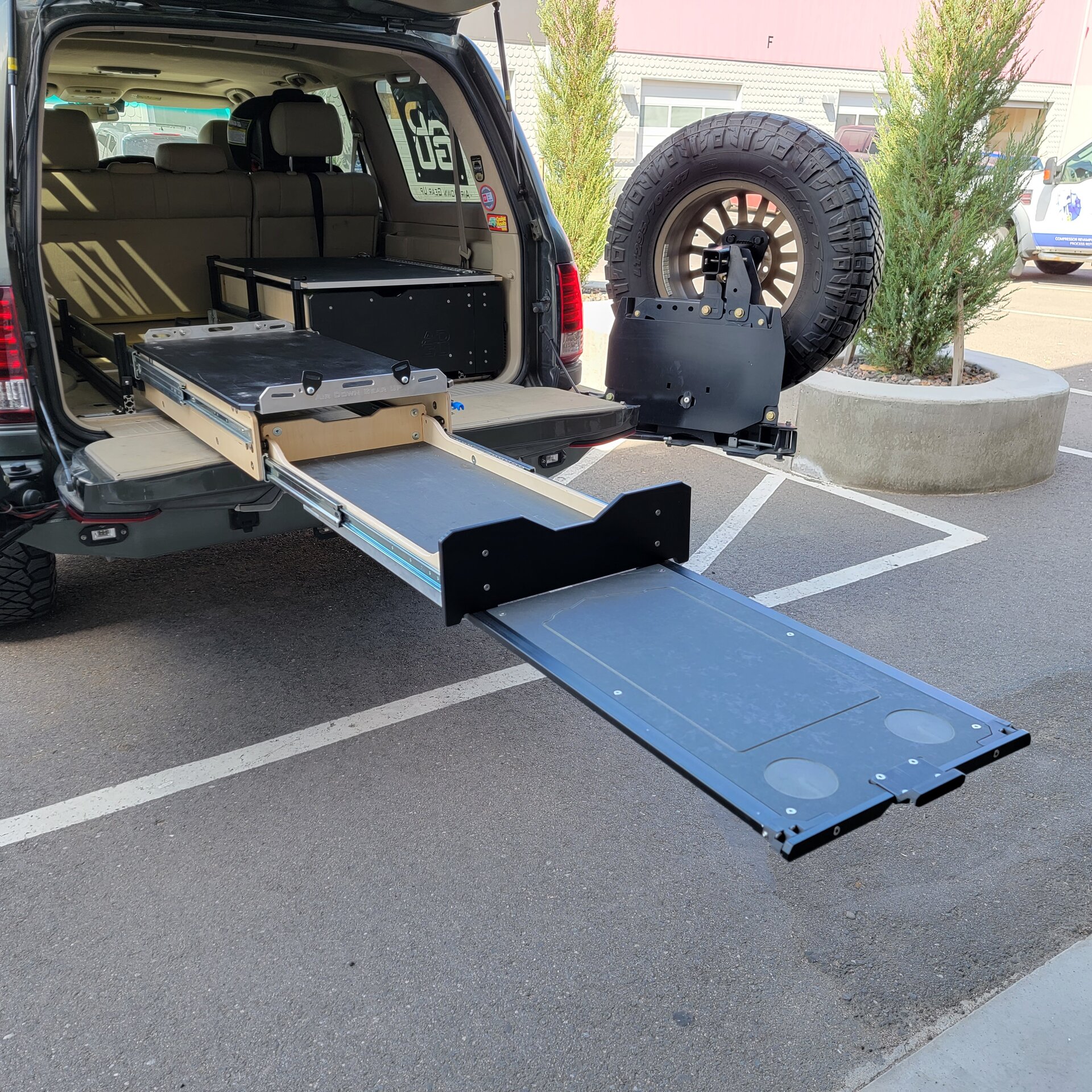

Just throwing our 2cents out here for consideration: You can run the Air Down Gear Up Standalone Kitchen on one side, while retaining the 3rd row seat in the other. Clearance would be tight for the folded up 3rd row while being stowed, but there should be just enough space to clear. The kitchen gets you a fridge slide PLUS the additional stove tray and slide out table, packaging a lot of utility in a small space! I don't have a picture of this exact arrangement, but you can see the kitchen as installed on a 100 series, showing the room available on the side.

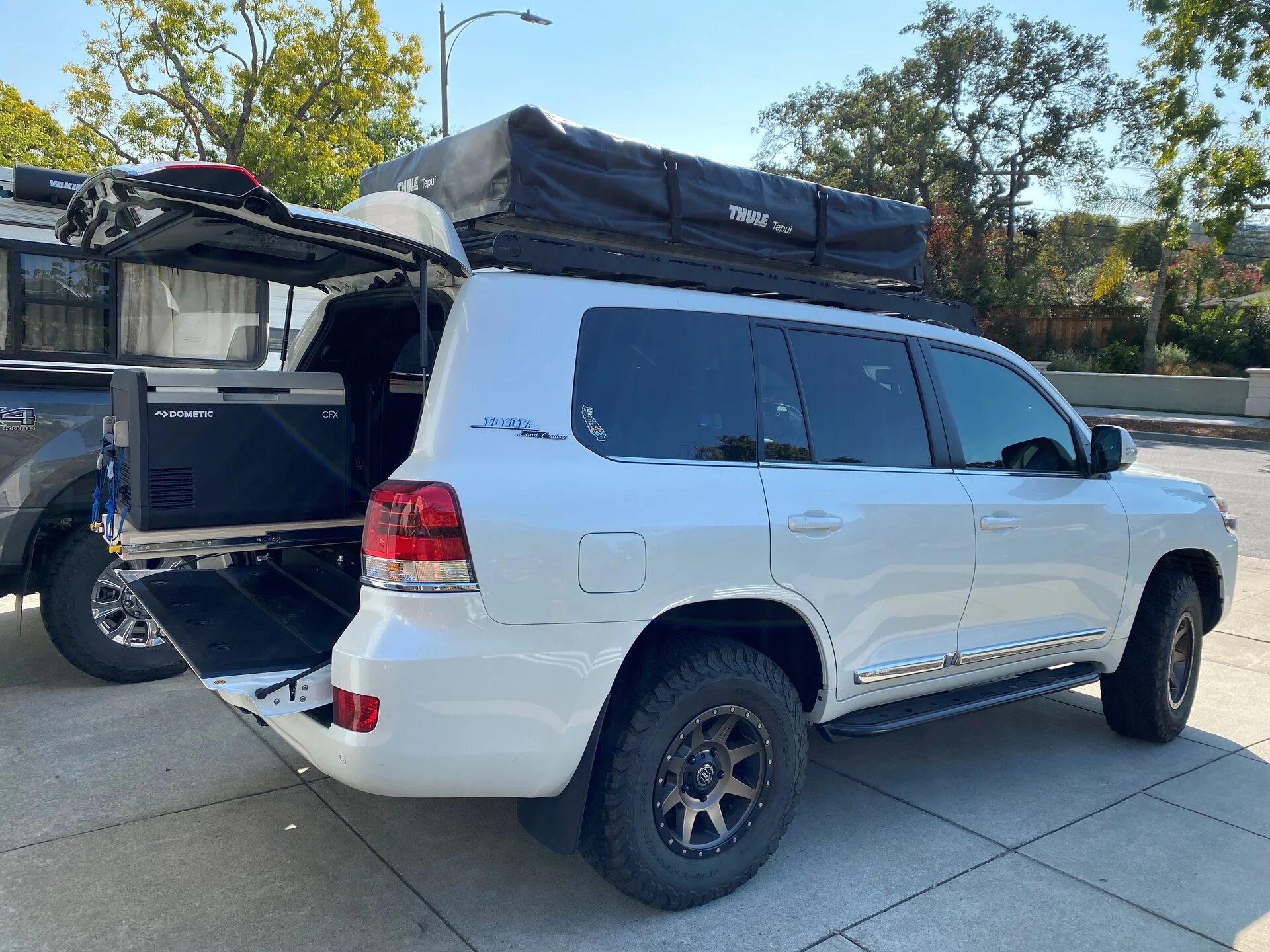

I built a slide out of some baltic birch and amazon slides. I made it to fit over top my Tuffy Security lock box, so not directly on the floor. Also doubles and secured storage under the slide as I have it. Just need to loosen two small u-bolts to remove. Super simple, super fast. Cooler fully opens and accessible, but tall.

Those are really good looking setups! Nice work!
