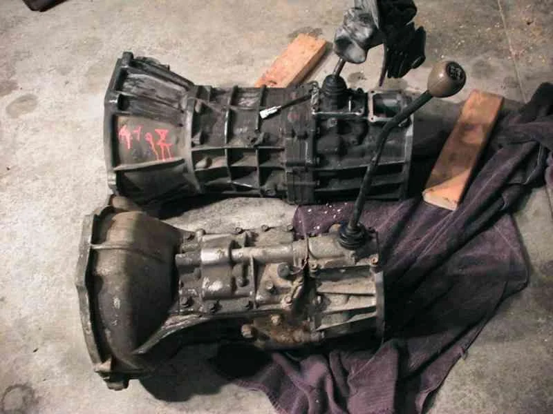

you'll need crossmemeber mods as well as floorboard mods as that tranny is a few inches longer than the L series. It will bolt up to your 22r. I think I even have pics of the two trannies side by side on my personal pc at home. I'll post up what I find...
Matt
Just to follow up on this if anyone's interested here a pic showing the case lengths (relative). L-50 foregrond and an R-151. R series, G series and w series are very similar in case length although shifter locations vary....
