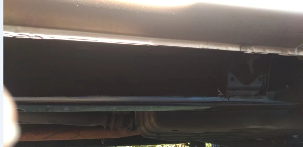

I would not do rubberized under coating. Its a moisture trap. Some use POR15. I use John Deer chassis black or Rustoleum satin from HD…rattle can (pic)
