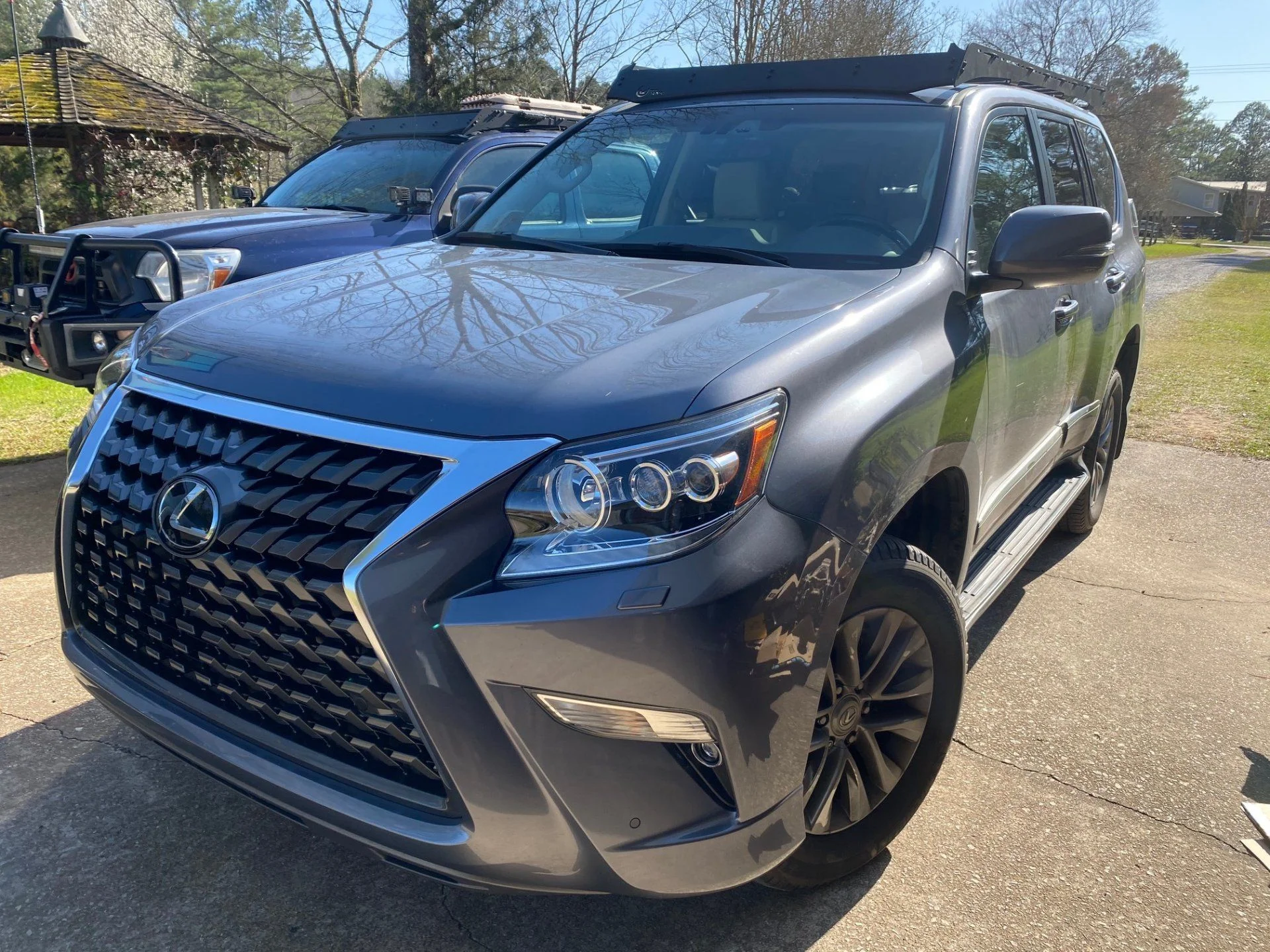

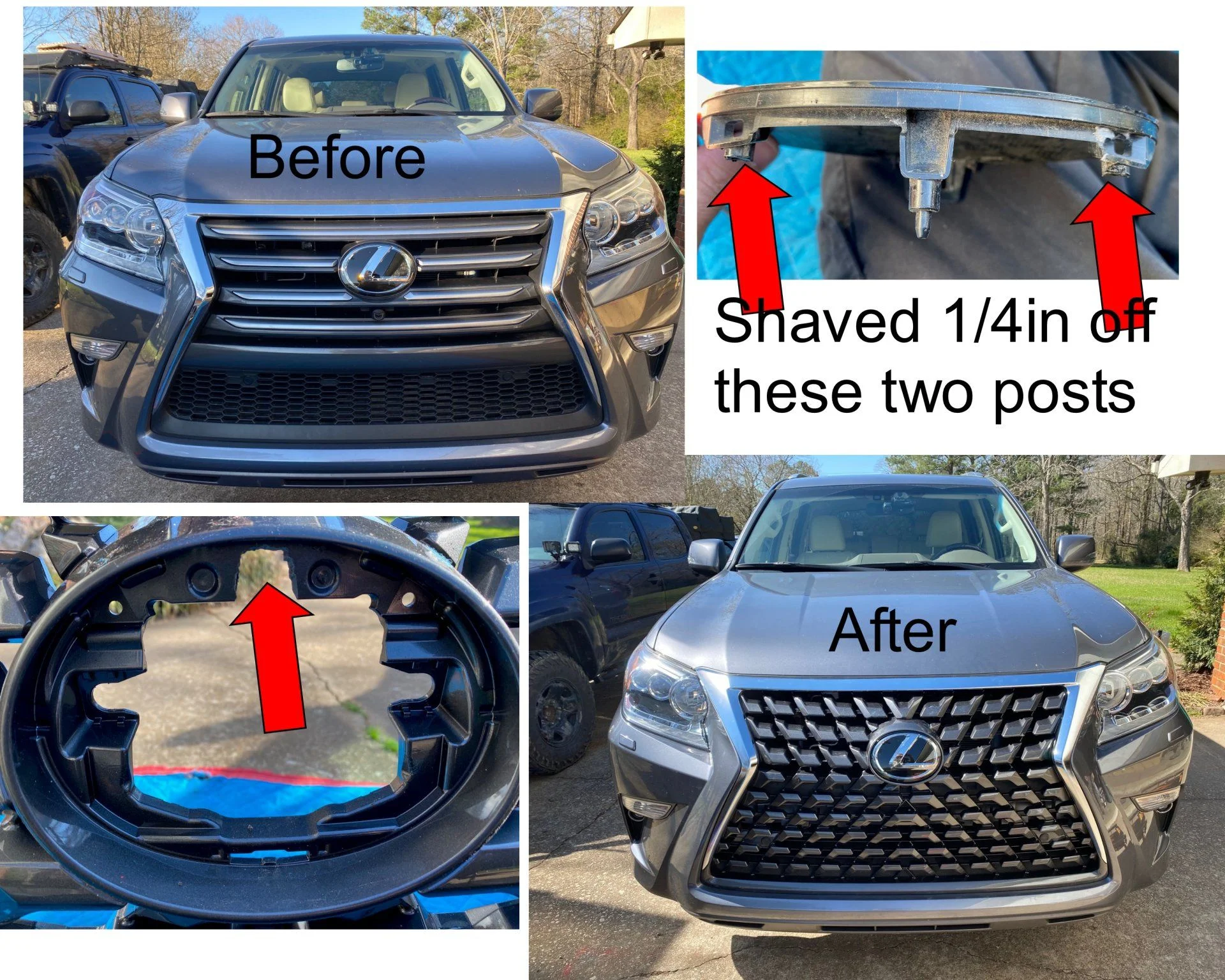

I put a 2020 OEM grill (53101-60G40 upper & 53112-60340 lower) on my 2018 GX yesterday – only took about an hour BUT I had an issue w/ the forward facing camera. The housing on my 2018 camera (part#86790-60200) is way too large for the 2020 hole. Before I made that hole larger I wanted to explore options. Its zip tied for now. Anyone know the method to get it to play nice. I completely cut off the left/right sensor mounts on the 2020 grille and used the mounts from my 2018 grille to make a really tight fit. I did use my 2018 emblem and only had to make a small cut at the top of the 2020 grille and shave the 2018 emblem screw hole mounts a ¼ inch. Certainly looks better than the granny bars.
