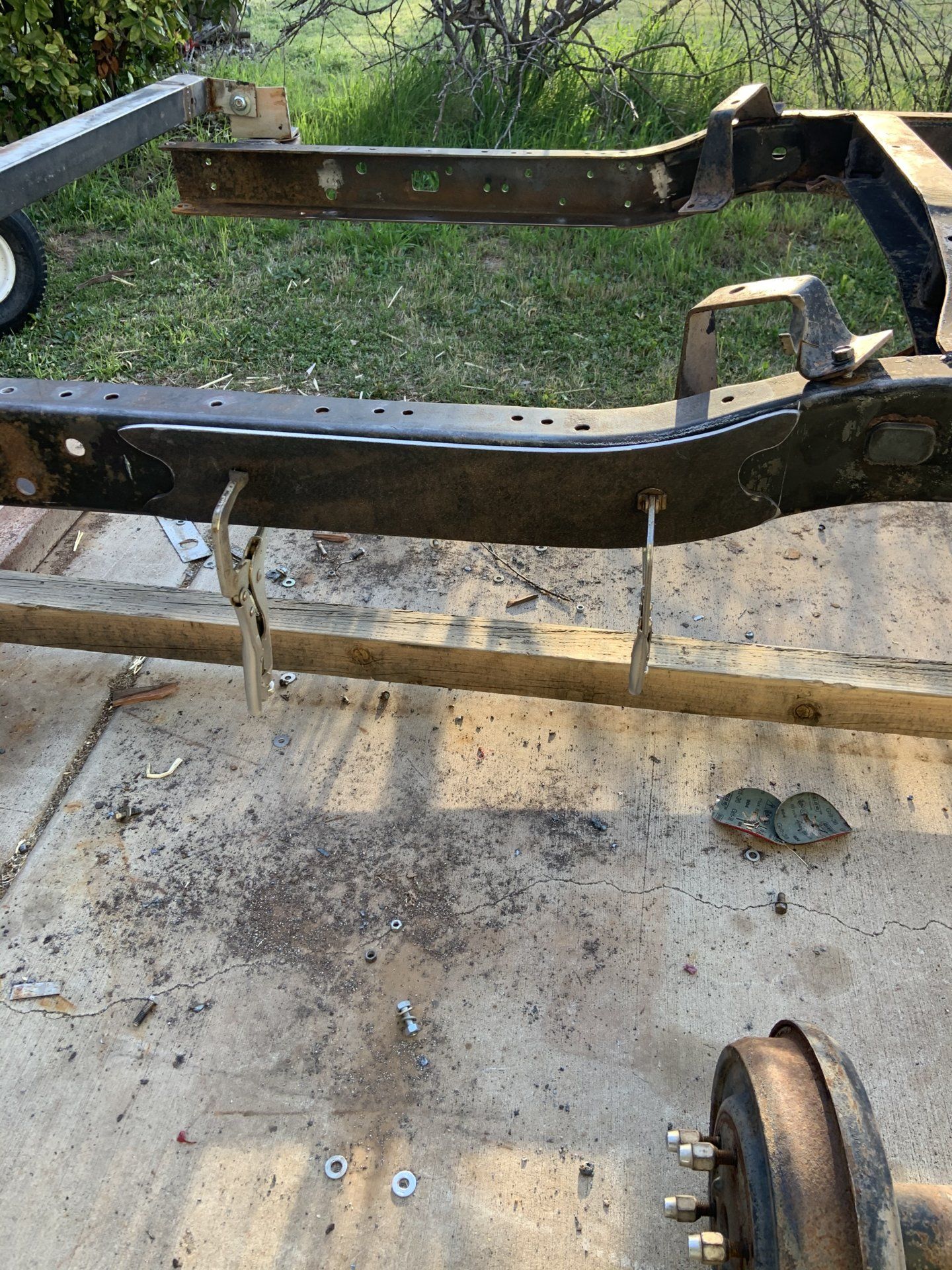

So far all indications are that the frame itself is still square despite all the years of rough wheeling. Back when I was measuring for hole placement on the replacement floorpans, I took measurements off of the mounting points on the frame and everything matched. I marked where the centers of the hanger pins were oriented and still plan to use those as a starting point. Re-measure and check for square, then just tack everything. Then I’ll have to wait for the springs to show up and see where to go from there. If everything is as it should be, I’ll fit the axles and put the works back on the ground and then stack a couple pallets of sack cement on it to see where the springs want to stretch to and make sure everything sits as it should. Once everything passes the test then it will get pulled apart, welded solid, and painted.

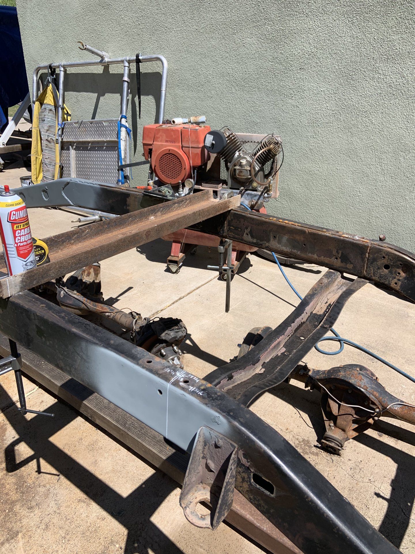

Finished out the rear fishplates. Went around and cleaned the mating surfaces on the frame for the fishplates and threw some high-zinc primer on there, similar to the SEM and other Krylon weld-through primer, in preparation for tacking.
Next, I’ll have to string out the measurements for hanger placement. I ain’t got no fancy laser, Bocephus.
*edit
Do not use the paint product featured in the pic for weld-through applications. It isn’t suitable.

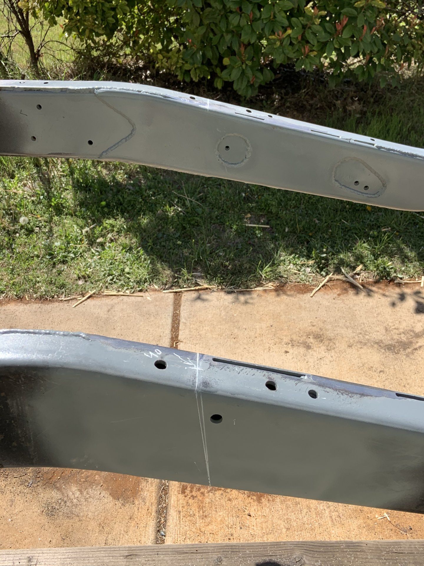

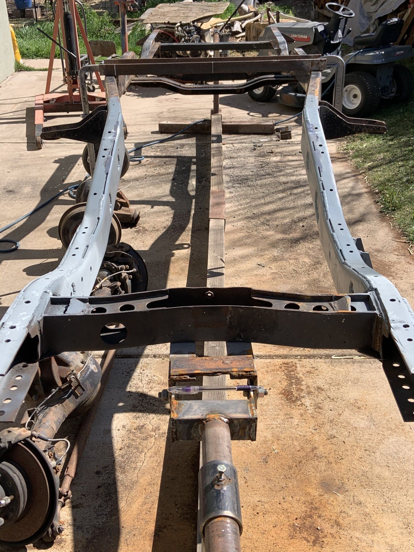

Sheesh, what a pain, but I think I got it. A few little oddball discrepancies but everything is squared out now.
From what I’ve come up with, the front of the passenger frame horn protrudes 1/8” more than the driver side.
The rear all squares out against the center of the piece of channel I laid across the front of the wider section of frame, as well as the ends of the frame.
The front axle OEM spring hanger area is what was throwing me off for an hour. On the sixth or seventh time measuring it out, I think I got it right. The problem is the difference in distance from the mark to the anterior rivet hole 🕳
is different from one side to another. It’s a minimal difference now, but for a little while was leaving me scratching my head.
