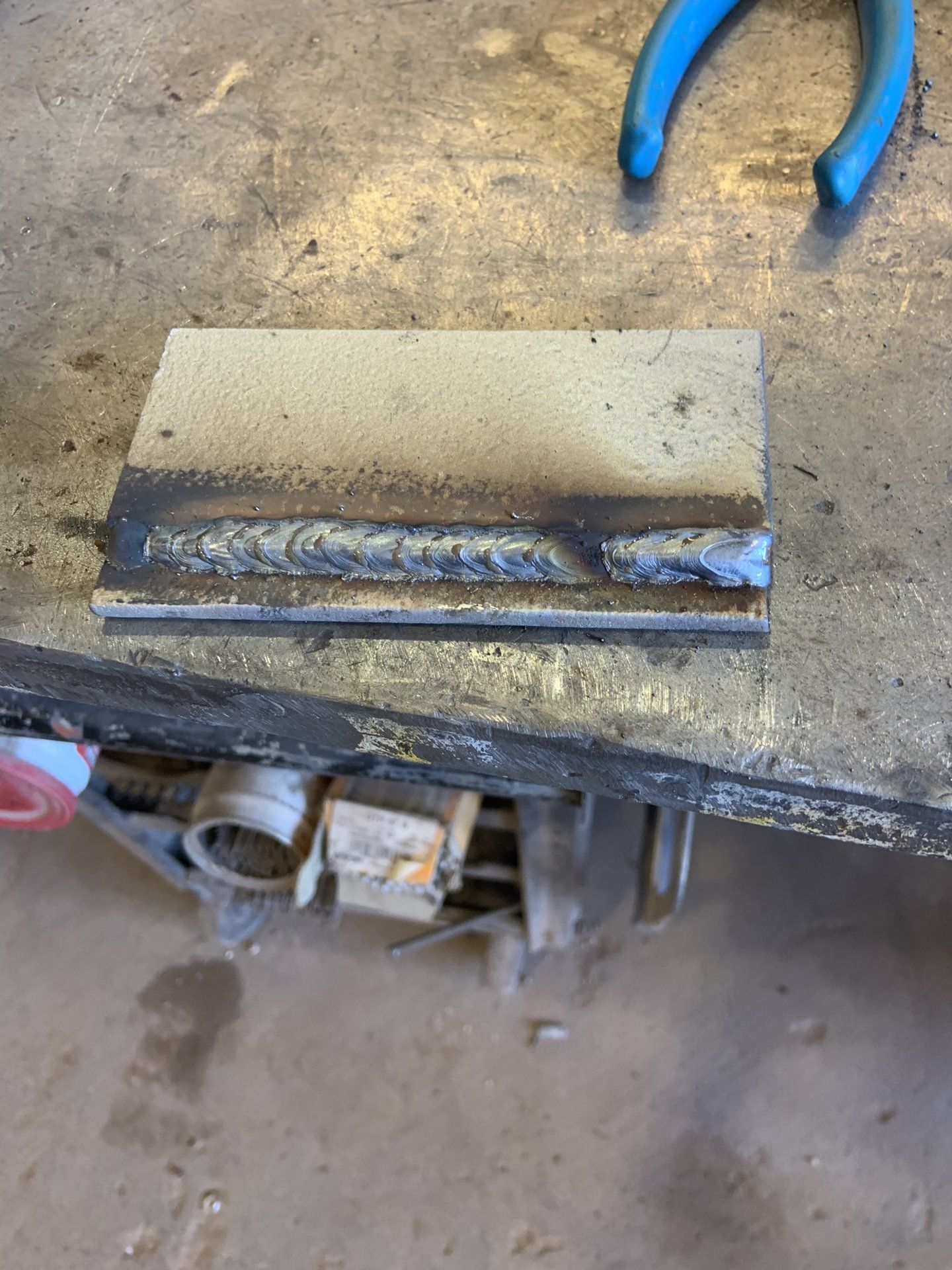

Did an experiment. Coated some 3/16” flat stock with this galvanized coating (Bob’s favorite) and let sit for about 2hrs.
Removed the coating where weld would take place. Welded. No off gassing porosity at all.🤔
Not completely apples to apples. This isn’t the same paint I used before.

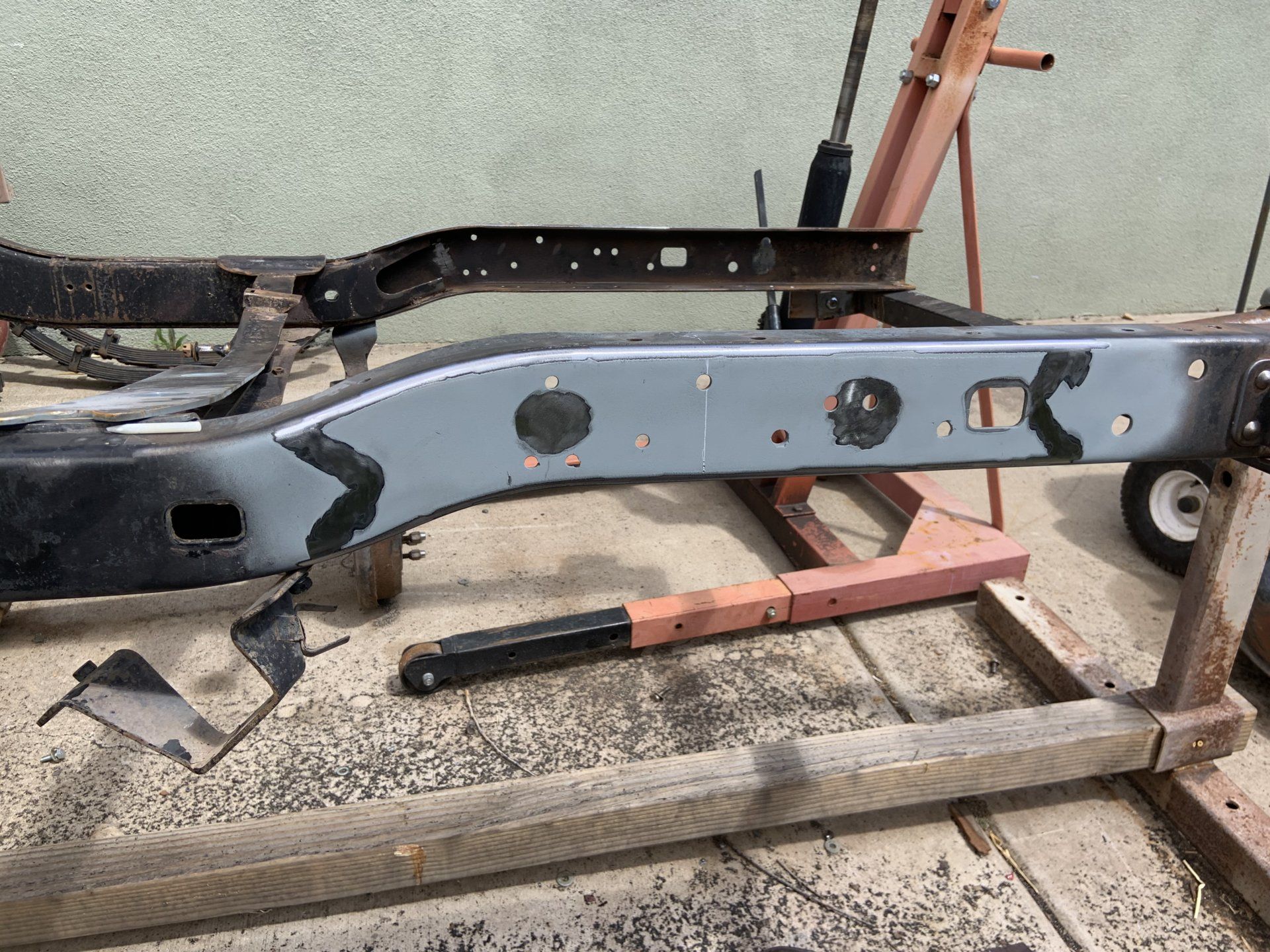

Worked on getting the last fishplates welded on and done today, with the threat of rain in the distance.
Marked out the outline of the plate and used a paint stripping disc on the grinder to remove the paint. Cleaned the bare steel down with acetone. Found the best results when I removed 1/4” - 1/2” of paint from the edges to be welded on the fishplate.
Next step will be to weld the hangers.
