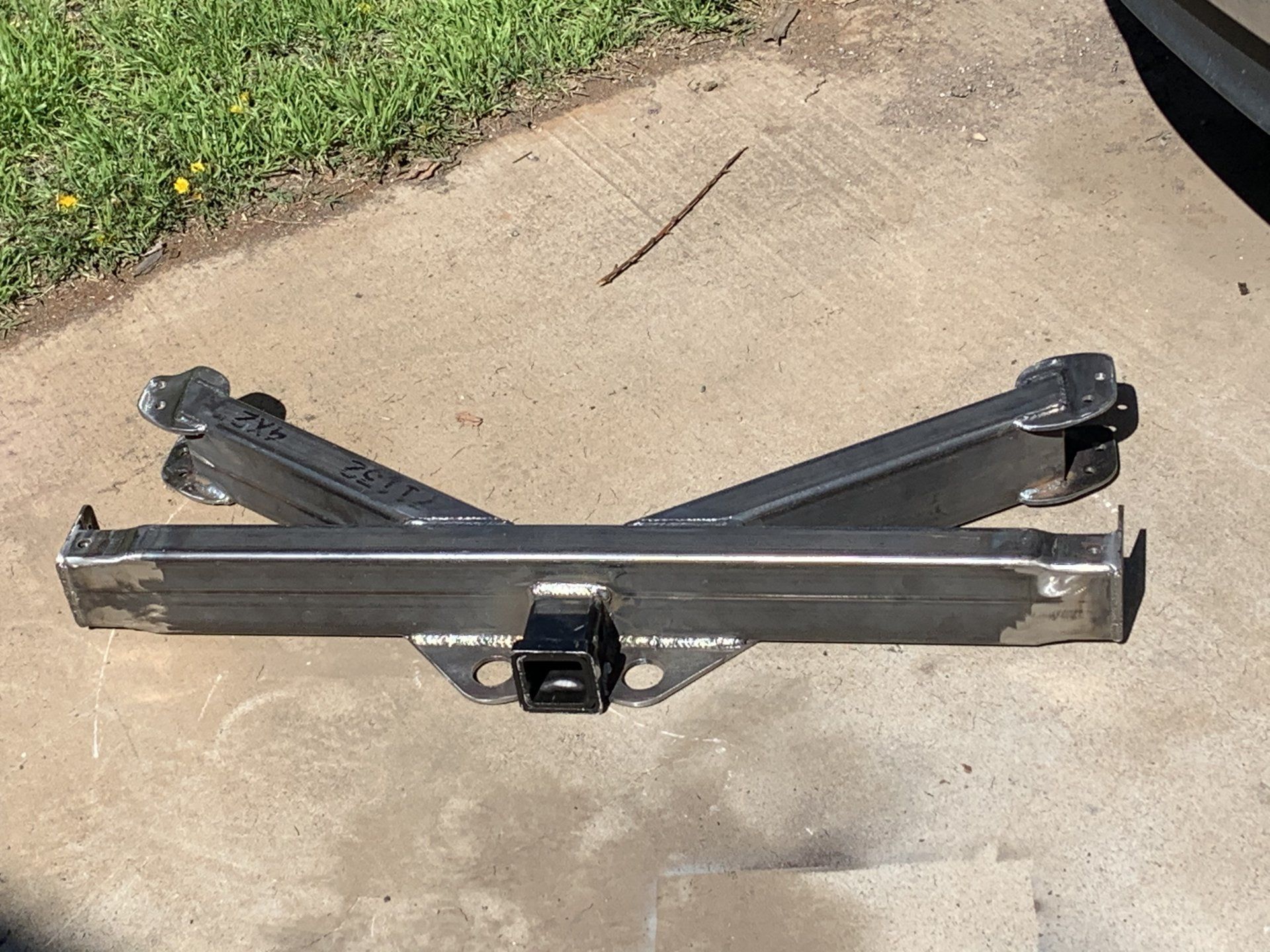

Finished up on the crossmember. The crappy welds are the only welds that will be actually visible, and would like to grind them out and re-weld them, but you know how that goes, so I just left them for now.

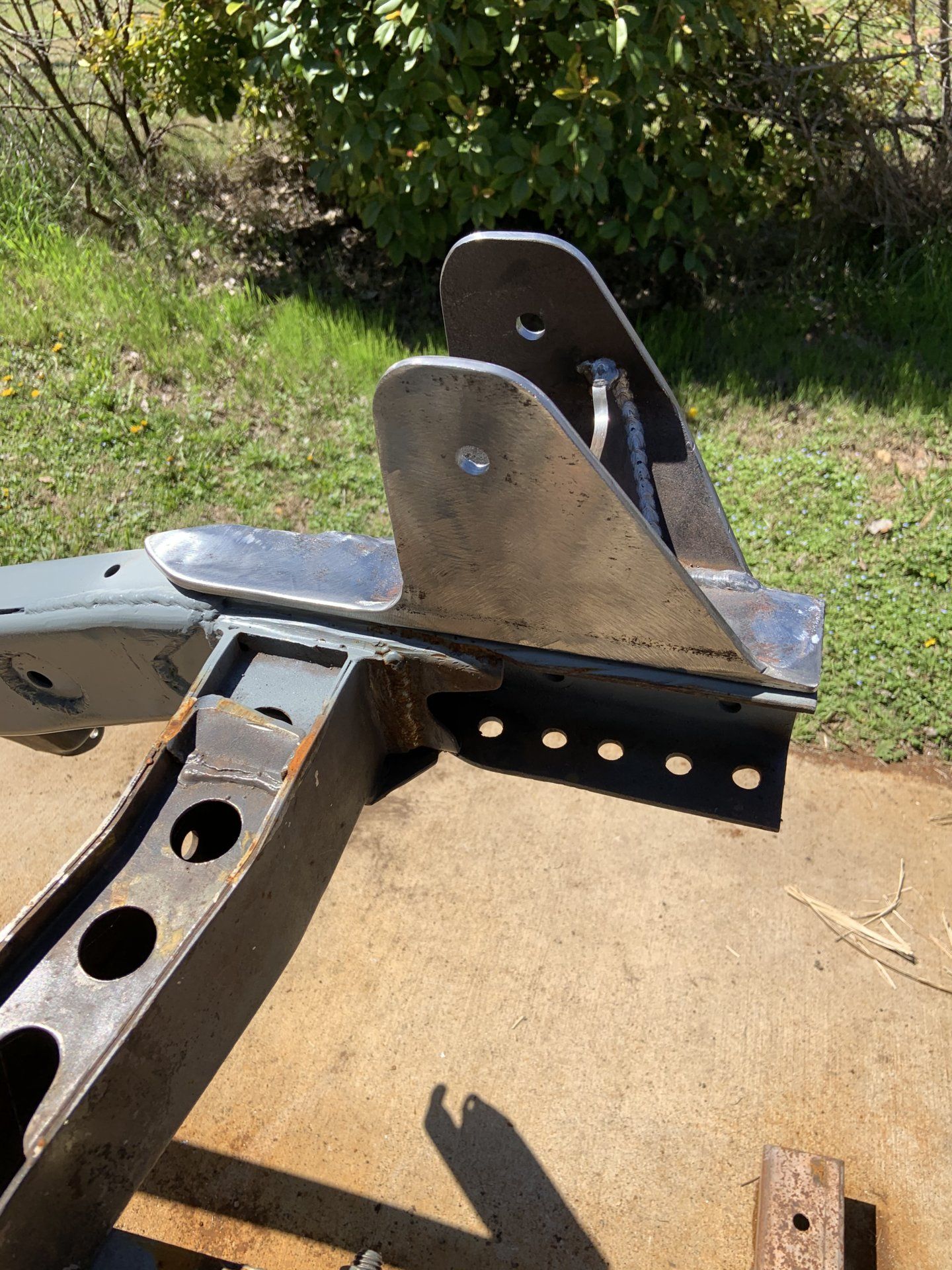

Did some final prep work on the front hangers. Decided to do away with the wing on the tail. The idea was to tie it in to the front crossmember, but after doing some mock-up, that looked to be more of a PITA than what it would be worth. I’ll go a different route.

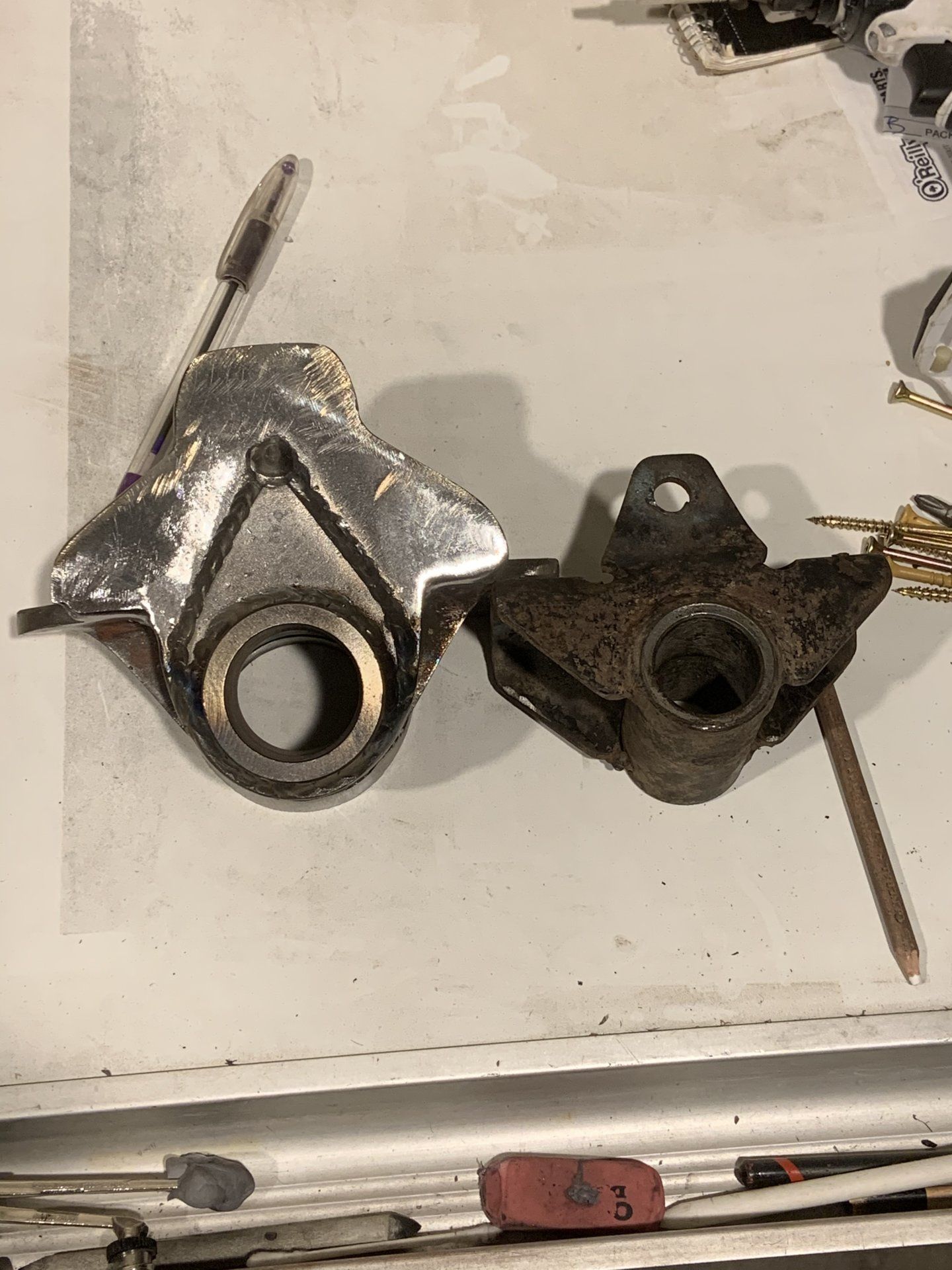

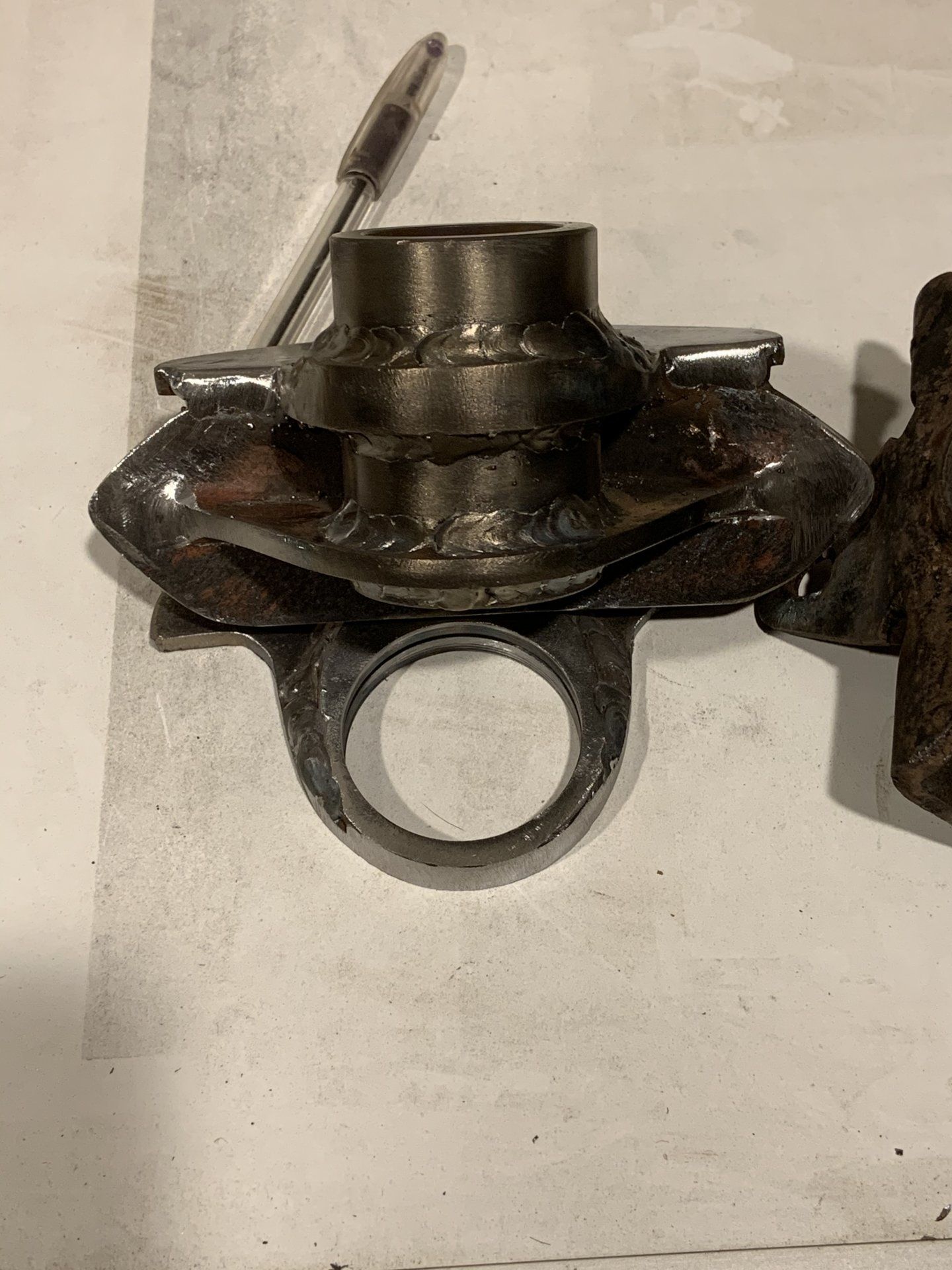

After that, pretty much spent the entire afternoon shaping out fishplates and the outer shackle hanger pieces. Used the oxy-acetylene to blow them out, but spent a ton of time grinding them into shape, so.... whatever.

Yeah looks like that wing would’ve needed a lot to blend in, welds may not be purdy but functional for sure.
I was looking at my 4” material today trying to decide if it was worth plating the frame at each hanger even if it doesn’t reach the top...I have no experience on this frame & leaf springs stuff so tough to know the right path forward.
It’s not 100% necessary, it’s just my preference. 3/16” lines the center of the front hangers. It actually doesn’t do that in the rear. If 3/16” fishplate is used on each side, and you outboard the same distance as you do in the front, the spring perches still need to be inboarded 11/16”. Without the fishplate, you’d inboard the perches 7/8”. IIRC, you say you’re just inboarding the perches to match the 55 suspension, so even less work. I kinda wanted a matching “custom built” setup, thus my gluttony for punishment.

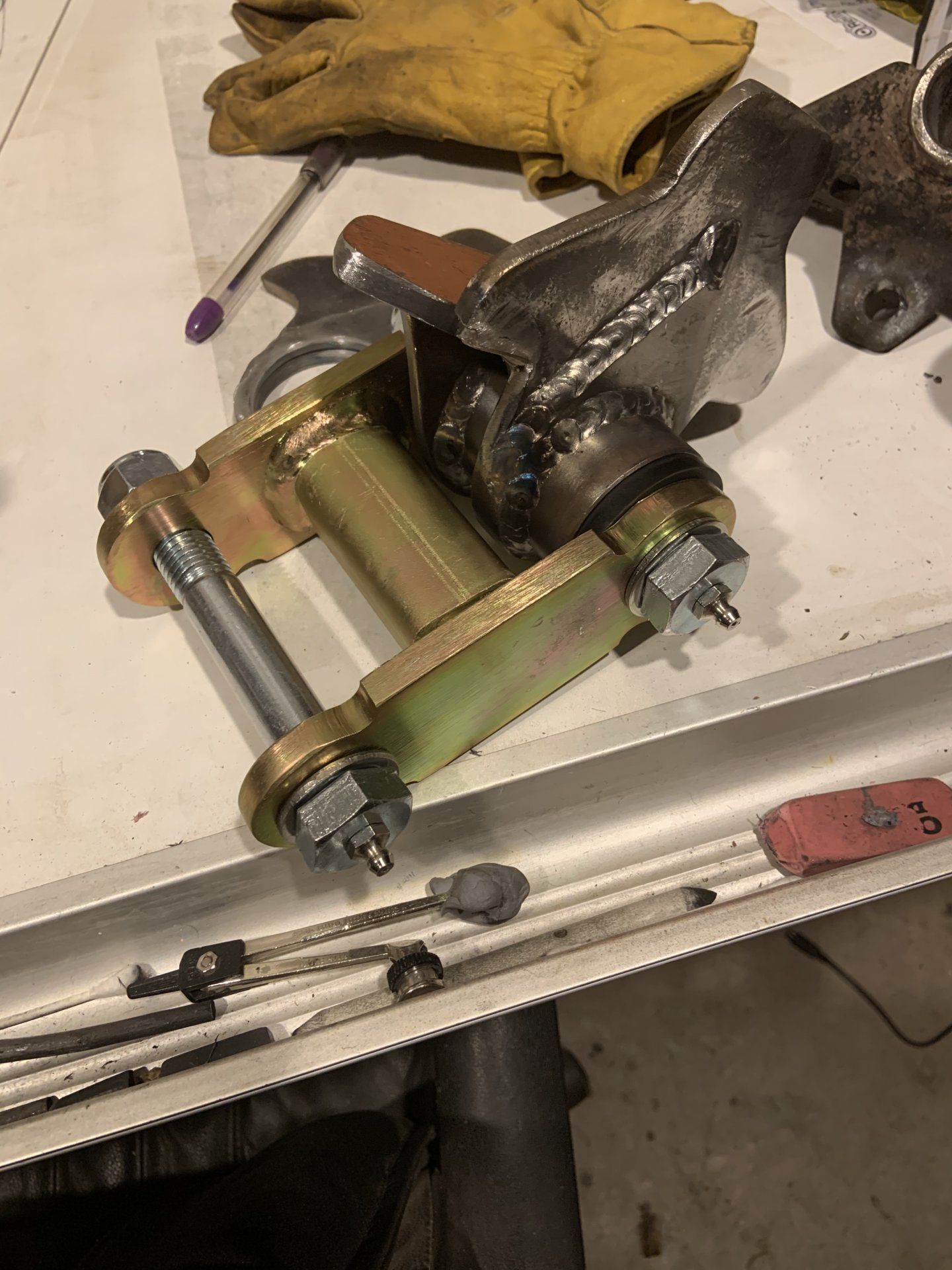

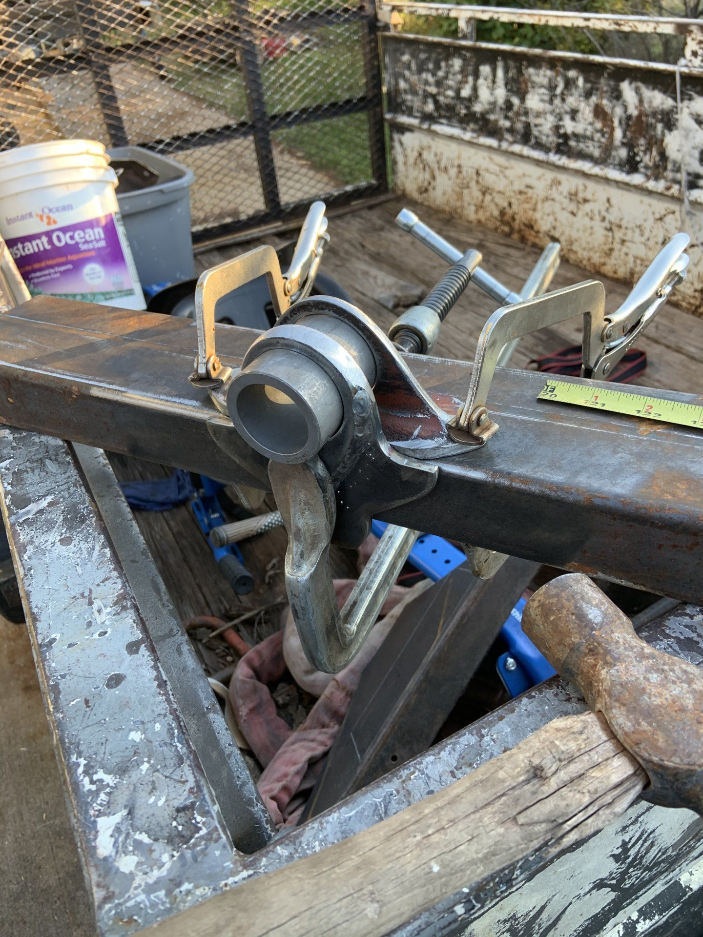

With a shackle mocked up.
Will probably remove a bit more material from the inner piece to allow some more swing in the shackle’s arc of rotation (🤷🏻‍♂️😄). Other than that, can’t wait to finish the other one and get them tacked onto the frame!
I have a length of DOM tube for making the shackle hangers, just match the spring pack for width I assume?
I’ll have to get at a lathe to true it up after the bandsaw...
So great point - after all this, my hindsight is that a length of DOM with an ID close to the bushings OD and of a decent wall thickness would suffice to make the bushing sleeves for the shackle hangers. Great decision J👍

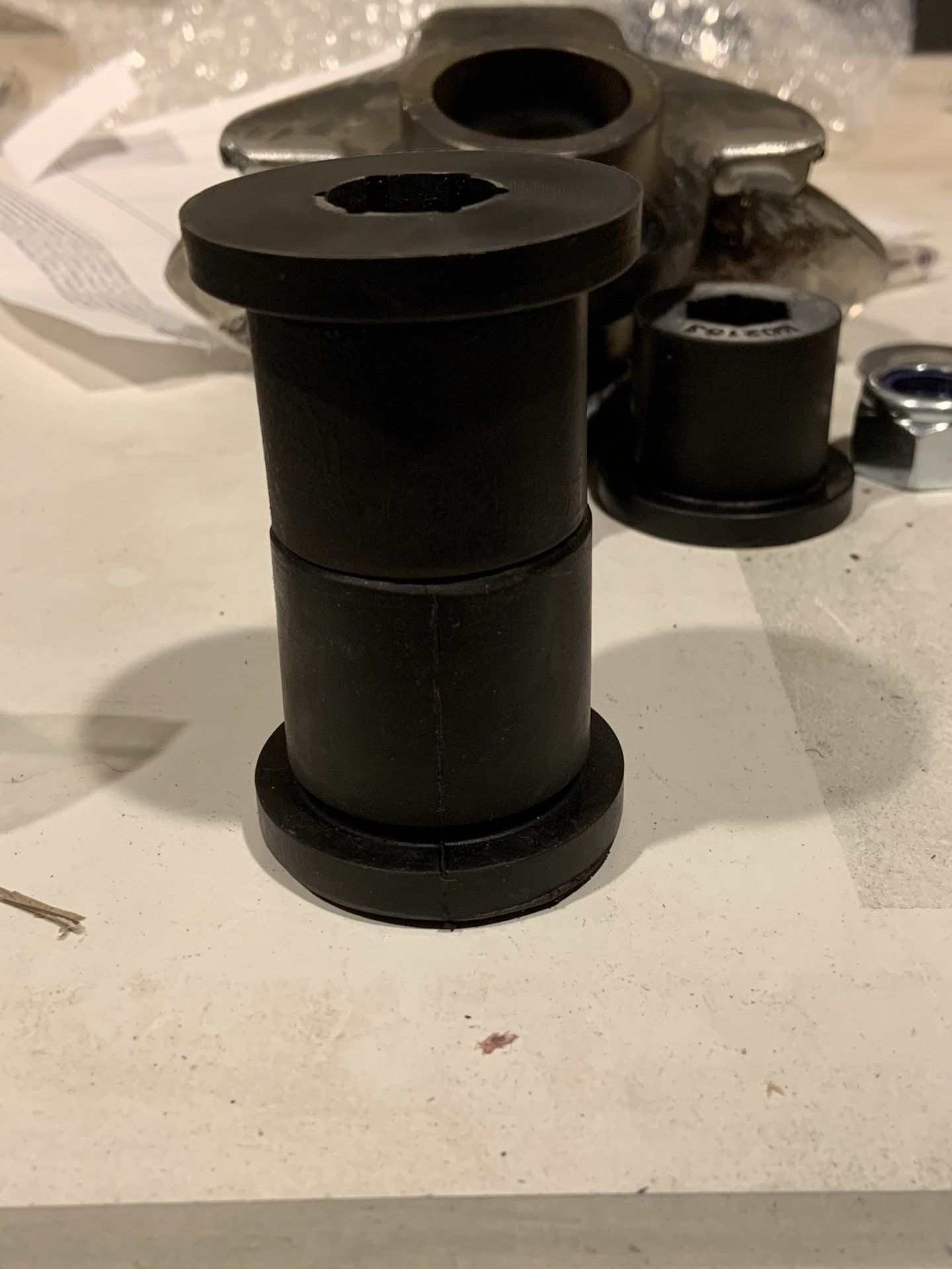

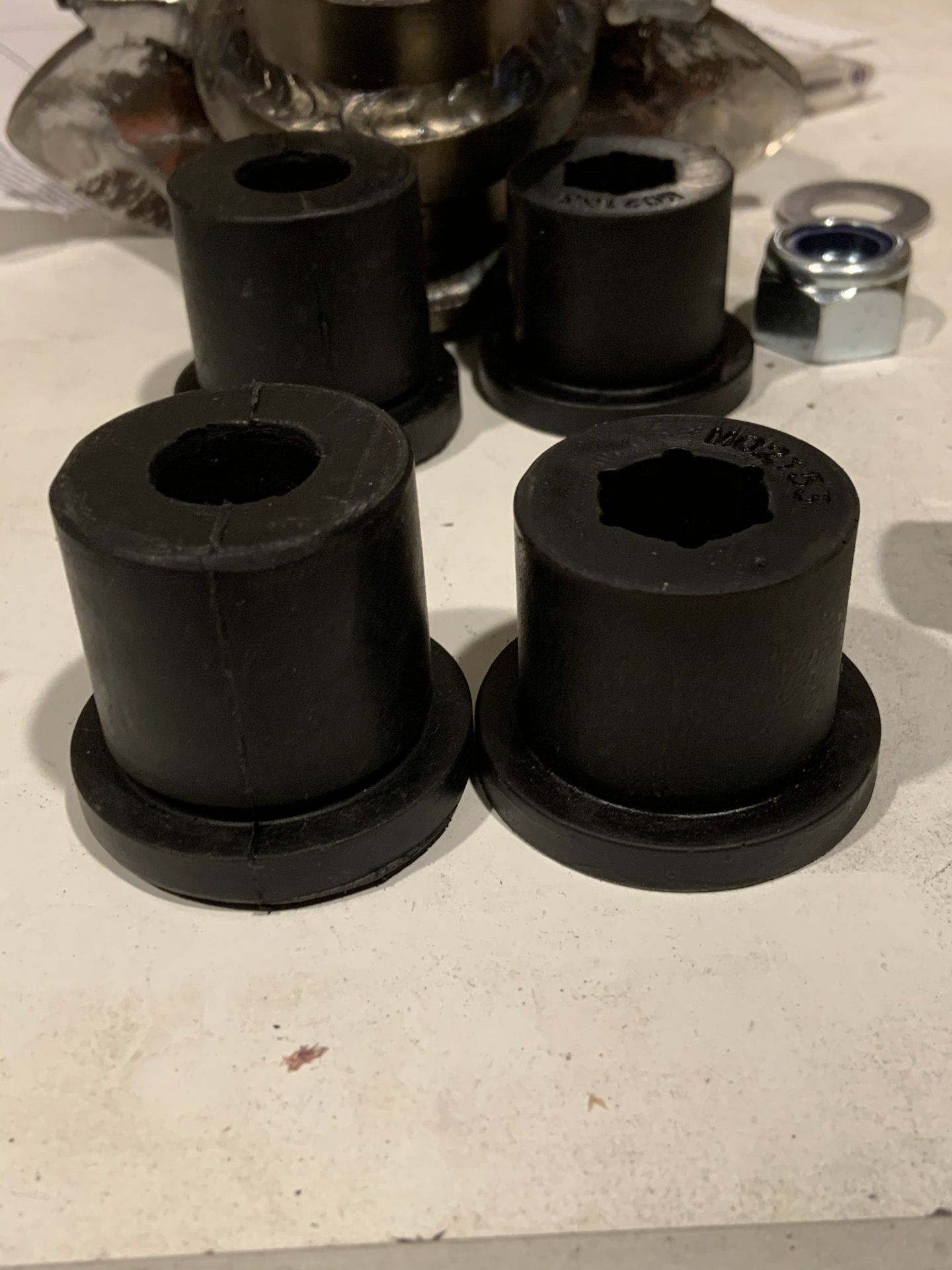

Kurt’s bushings showed up today. They’re marginally larger than the bushings Ruff Stuff provided in their sleeves. One could turn the bushings down a hair to fit the sleeve, or have the sleeves turned to fit the bushings, probably .030 - .050 or thereabouts. The bushings are also longer by at least 1/4”, so the ends will need to be trimmed.
Found a machinist nearby to turn the sleeves and hopefully be able to chuck up the hanger I built. Or maybe say eff it and not worry about it?🤷🏻‍♂️
I don’t think the bushing length is too critical, probably the biggest deal here is getting everything square to the frame honestly :hmm:
Someone who has actually done this will chime in, my dad gave me some good advice tonight...don’t over think it, get on with it.
As square to the frame as possible. Yep, have to agree with that 100%. Lots of double and triple measuring. This method with the plates is probably more of a PITA to get correct than other methods of welding a hanger to a plate, but have to say I’m more enthused over the end result.
I jigged the hanger off a piece of 2”x4” rectangle tubing, measuring and eyeballing everything over and over until satisfied it was as close as it was gonna get before tacking. Checked everything again after tacking and then just went for it.
