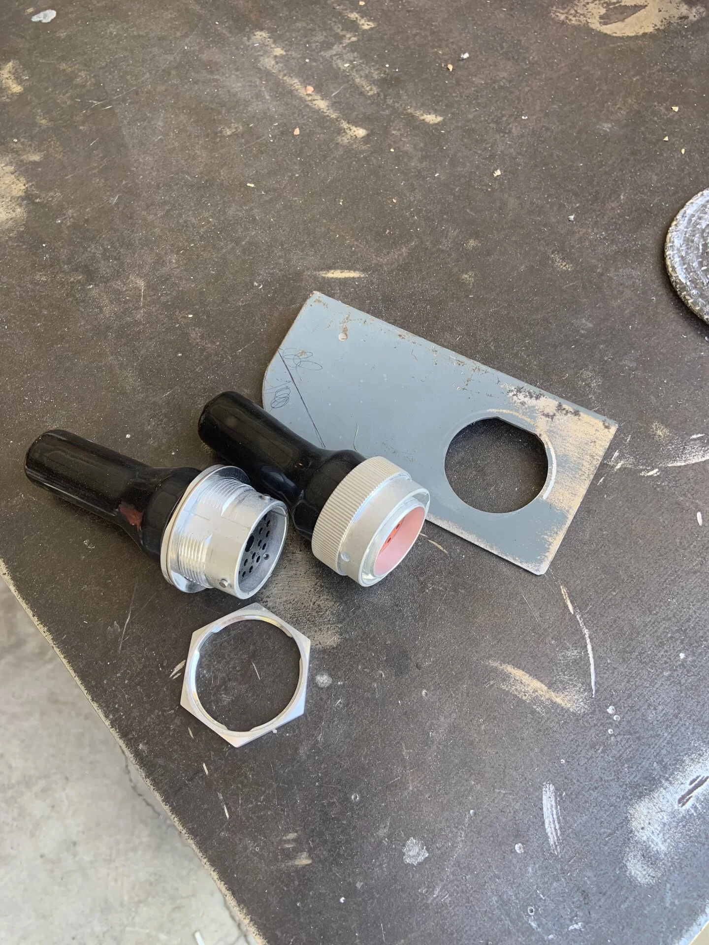

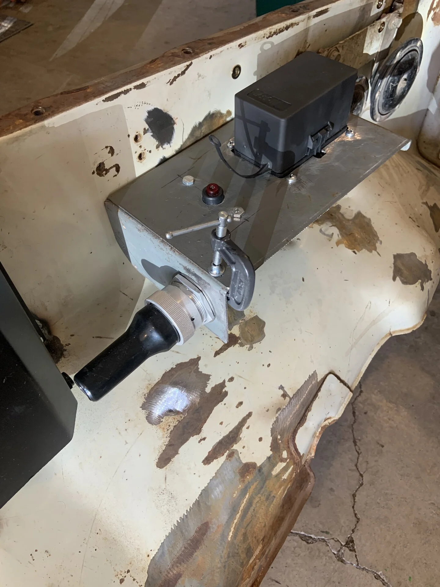

Still working on the engine fuse box mount plate. I think this incarnation (3rd) will be good enough to get me rolling. Found the bulkhead I’m going with from TE Connectivity in the form of these Deutsch HD30 housings. This pair uses #16, #12, and #8 pins for different amperage needs.
I am still working on making a removable side cover/mount on the mount plate to help support and protect.
My windshield washer reservoir is aluminum, as will be the coolant overflow res.

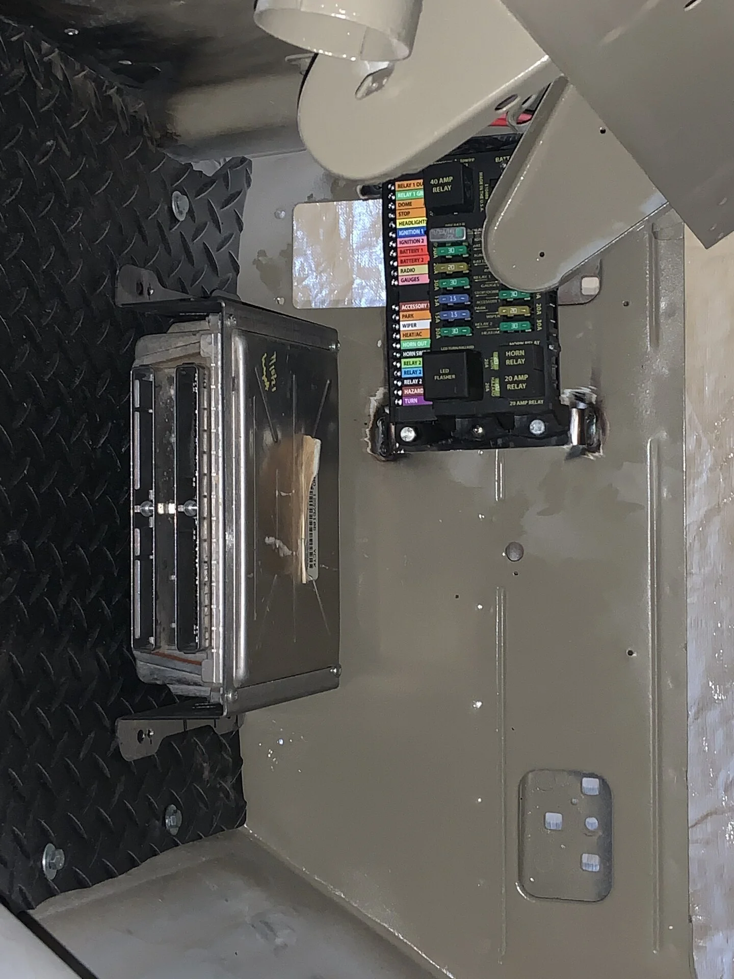

I also mounted the fuse box a little while ago. Decided to put it on the passenger side instead of driver side like what has been traditional. Seems to be plenty of room and close to the hole in the firewall for the wiring harness.

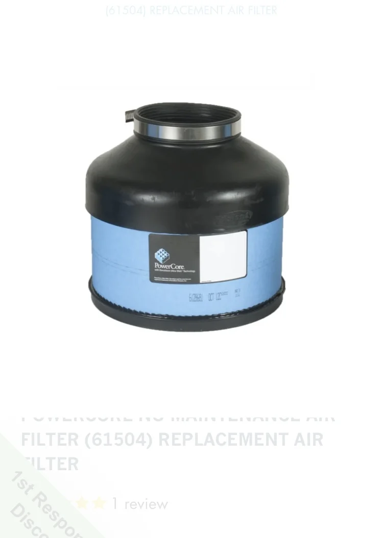

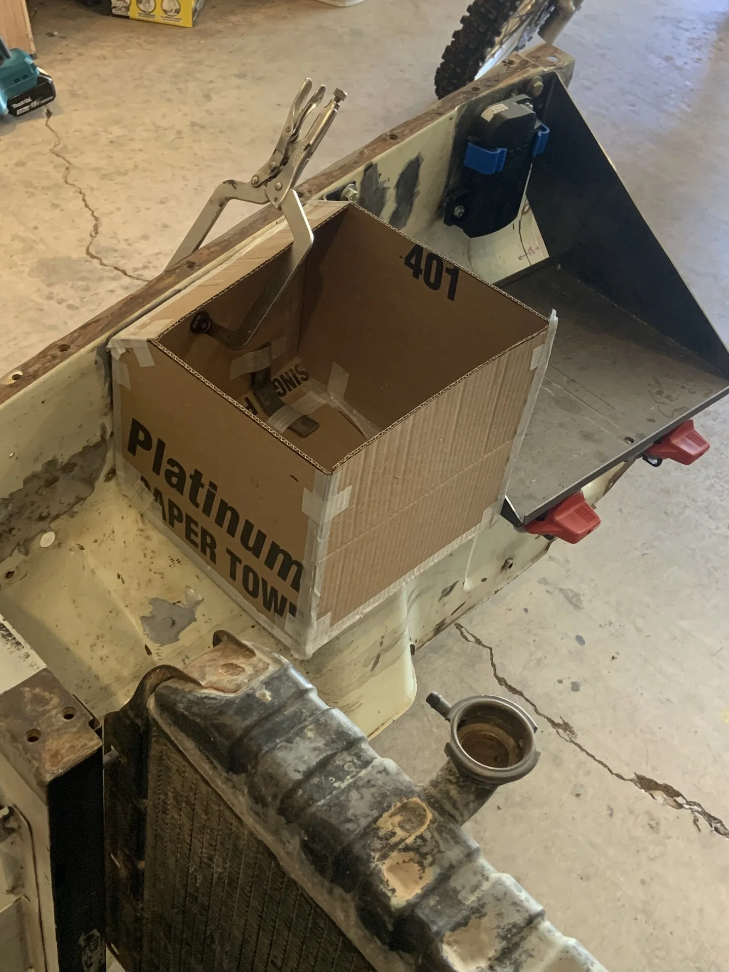

Then here is the CAD version of the air filter box. Decided to go with a Donaldson Powercore 61504 air filter. This project patiently waits for that TIG welder I’m always rambling about.

The filter just hangs in da box? It’s direct tube mount it looks like?
How oversized did you decide on for CFM or whatever rating…lots to consider in choosing a filter. :hmm:
There will be a 4” aluminum tube going through from the intake side that the filter will clamp to, and a section of 4” tube going from the box through the inner fender.
The filter media is 8” diameter and 8” length. The 4” flange is the same size as the MAF sensor housing and throttle body.
