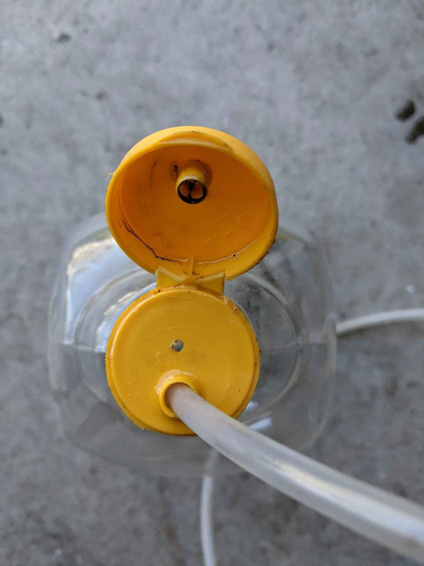

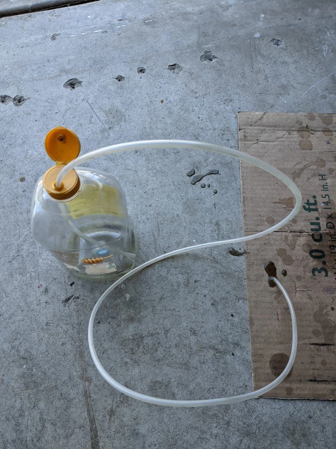

Flushed the brake system this weekend and the GX system ended up being one of the easiest systems Ive ever flushed. Also thought I'd share a handy tool I made years ago that helps out. For the tool, i used a old soap container, works best if you find something that has a plug on the lid you can connect the hose to in between calipers so it doesn't leak all over. Make the hole size match the tube diameter. I used some fishtank air pump tubing (I think) that was laying around. front brakes are tradition but rears are on some kind of pump.
-put the GX on level ground.
-take off the brake fluid reservoir cap
-put some fluid in the bottle you made and make sure the tube is submersed in the fluid
-put your wrench on the fitting, use the closed end not the open end, then slide the tube on the bleeder valve over the wrench. I use a long tube, so I can see it and the bottle is not under the vehicle with me and in the way,
-have someone turn the GX to ON, and crack the bleeder valve. always work from farthest to closest to reservoir

-Very simple, and quick on this rig. took me 25 min.
-$7 of Dot 3 fluid.
-fluid removed was black, could hardly see sunlight through it. nasty.
