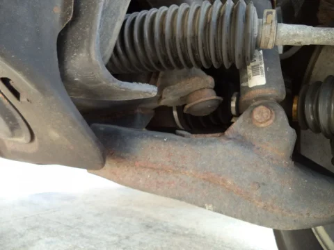

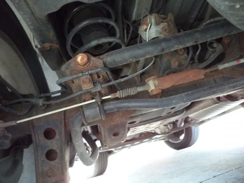

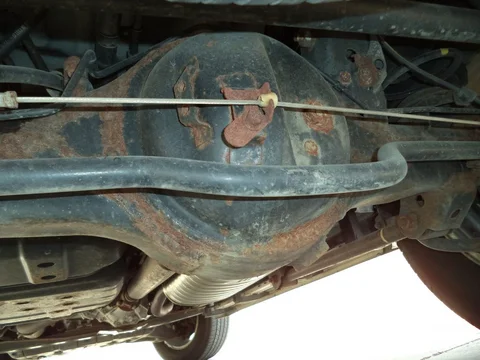

As far as photos, imagine rust everywhere... that's what the photo would look like.
My rust pictures: DSC03989.webp DSC03990.webp DSC03991.webp
^^ Don't think yours looks too bad. Where did it live before Texas? I don't have pics, but mine is worse than that. Going to try the place in my original post and have them do rust removal before applying fluid film. I'll let you know how it turns out.
