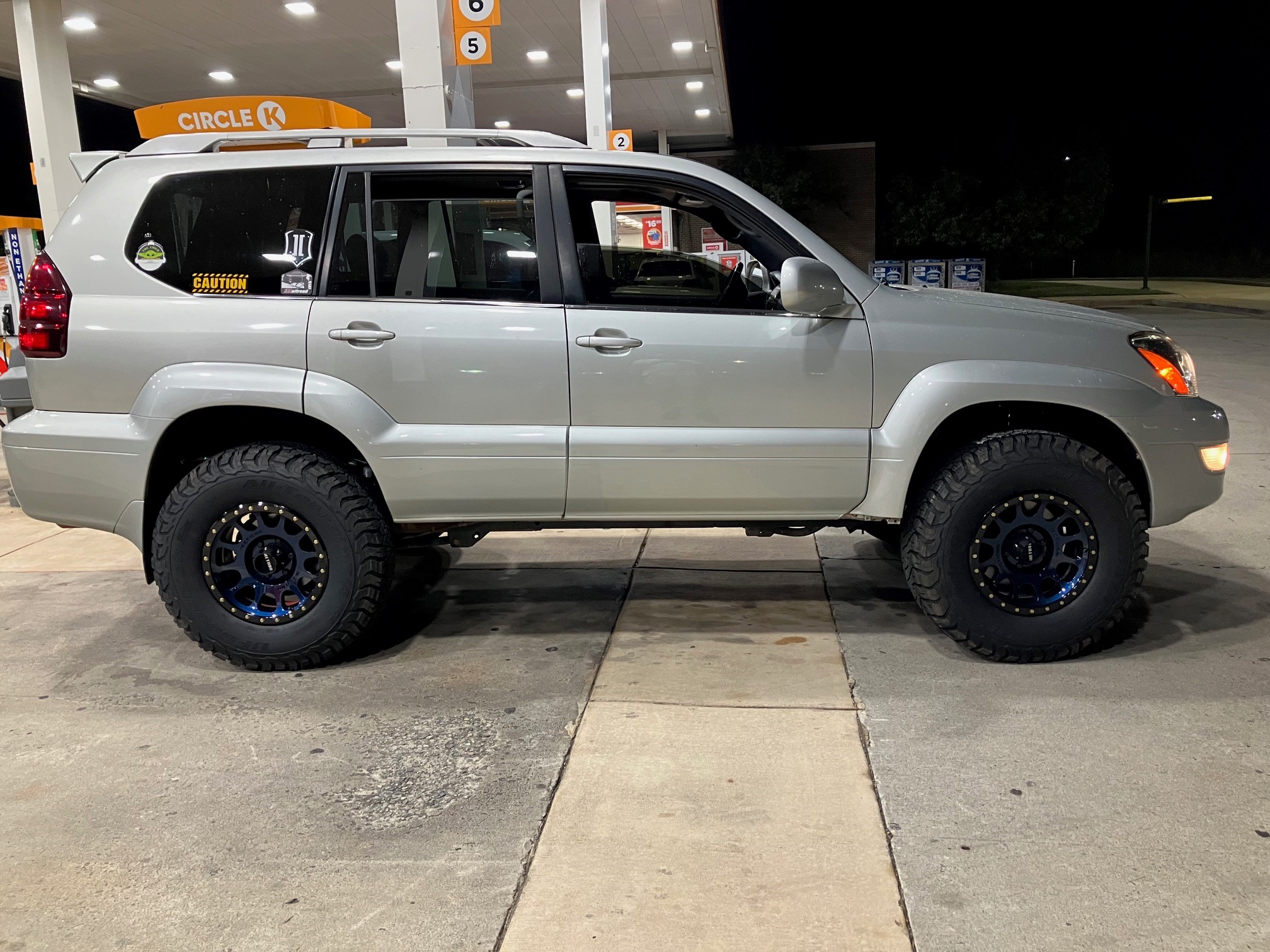

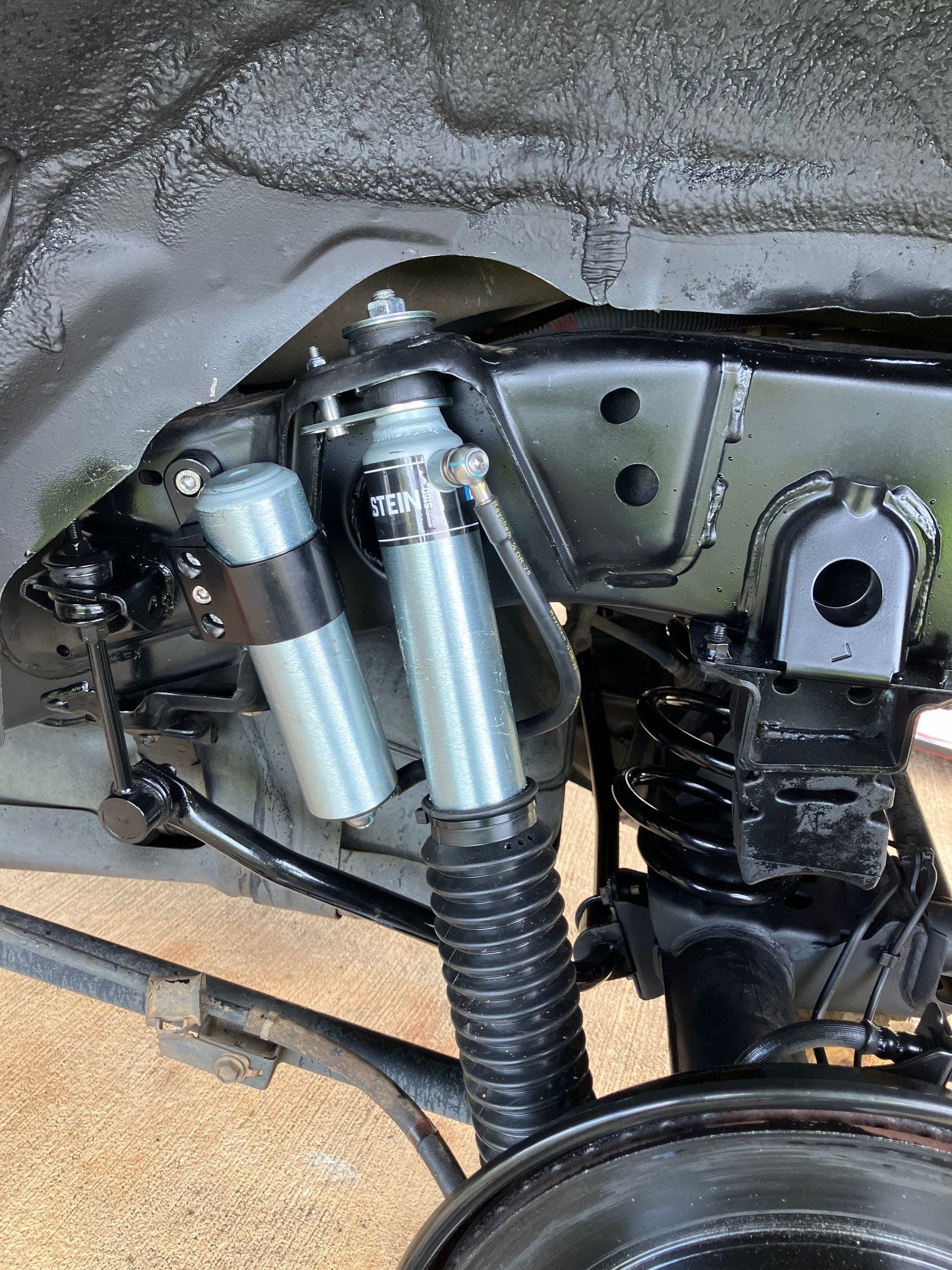

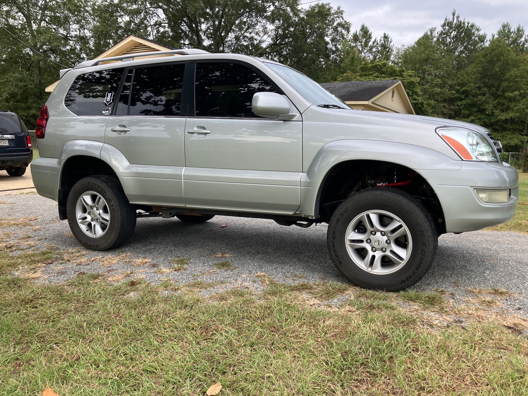

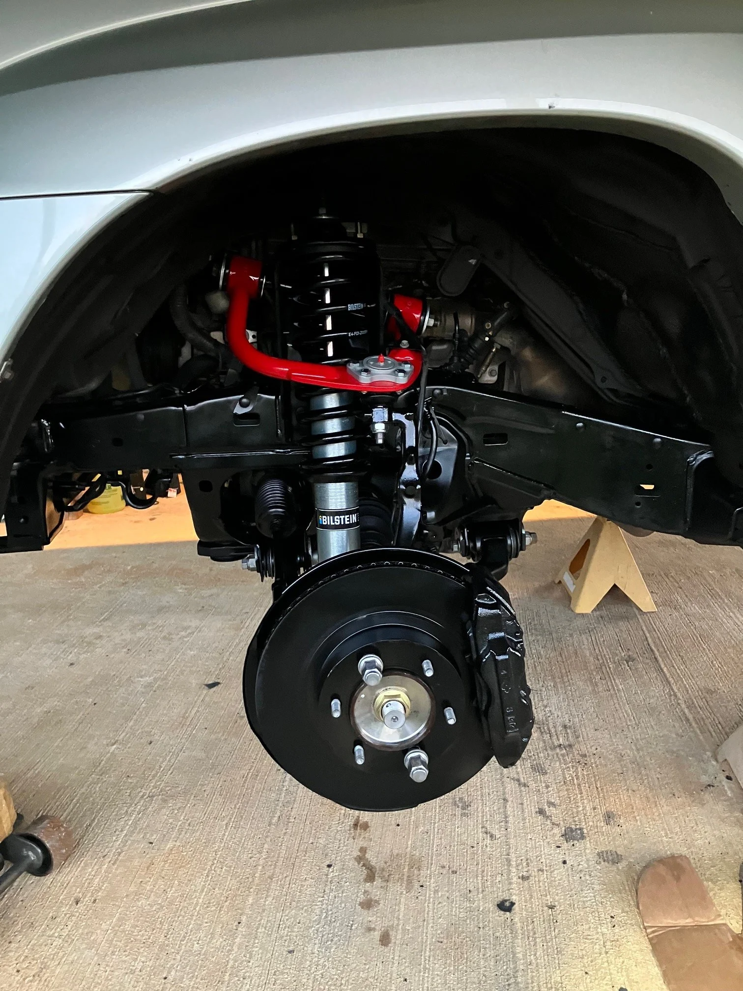

Been lurking and gathering info for a while. Here is my new to me 2003 GX470 - she has new HD CV shafts, new stock LCA, JBA UCA, Bilstein 6112 front /5160 rear with 2" Bilstein springs, Icon Spring adapters, junkyard 4runner upper isolators, Method 305 Bahia Blue, 285/75r17 BFG K03's .... rides very nice!

KO3s in 34”…that’s nice.
Can you take a close up picture of your wheels so I can read the specs on your tire?
I’m debating on which 34s to get
And what other mods you did to avoid rubbing?
Had the 6112/5160 setup on my last vehicle and loved it. Nice rig.
