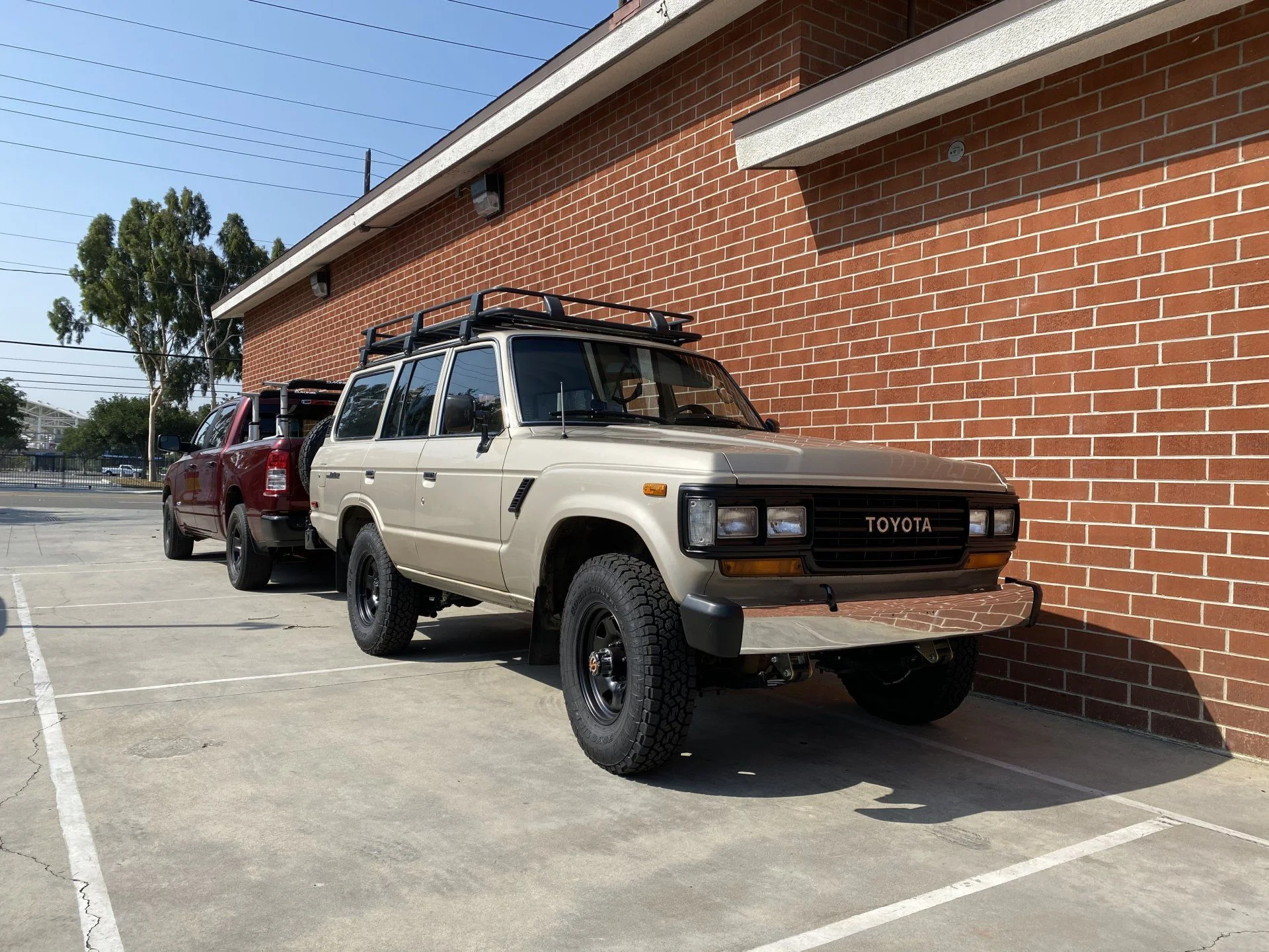

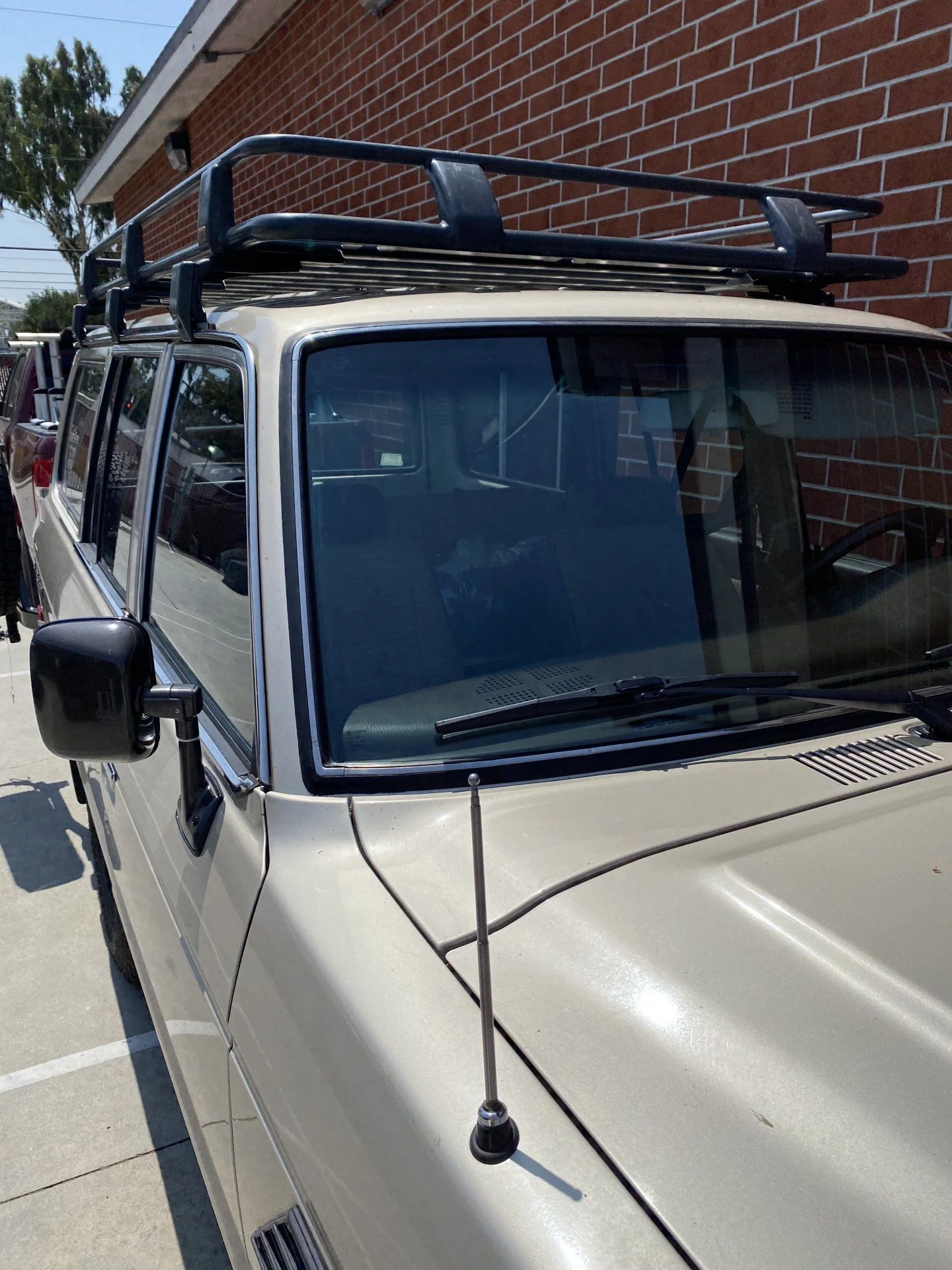

Just an update on windshield replacements. I got one “made in China” off eBay. Maybe $400 shipped. SOR wanted $1,200. It has the tint on the upper section which is actually pretty nice. I got the OEM rubber from my local Toyota dealer in Long Beach. I also got some rubber lock strip with the installation tool off Amazon just in case. My intent was to keep the original chrome strips. I’ve never done any kind of auto glass before.
I basically followed the FSM instructions, which I found somewhere on here.
Keep In mind, I tried to find some one to do this install for me. All star, safe lite, some local shops, “Dirk”, no one would do it. So here goes nothing
  1. Removed rear view mirror and visors. Removed wipers
  2. In order to keep the original chrome lock strips in good enough shape to re-install, you have to cut the old rubber from the outside. I used a utility knife around the whole windshield. Between the chrome and the glass. The chrome pieces came out pretty easily and I kept them in order on the ground so I could put them back together in the right places.
  3. Then I could push the windshield out from the inside to my helper who removed my cracked windshield from the outside.
  4. Next, I pulled the remaining rubber from the frame edges and cleaned the metal carefully with a razor blade, putty knife, shop towels and some goof off.
  5. I had some very minor rust spots in both bottom corners. I wire brushed them and treated them with rust inhibitor.
  6. Then I set up some saw horses with bubble wrap from the new windshield packaging rolled and taped around the tops of them. I set the new windshield on top of those and applied the new rubber gasket to it. I made sure it was completely pressed on.
  7. Next, I inserted a long length of paracord into the outside groove of the rubber trim, starting at the middle bottom. Leave at least a foot of tail hanging out so you can pull on it later. I went all the way around and crossed it over the first tail and taped them both to the inside of the glass. (Plenty of videos on YouTube for this)
  8. Then I had a bucket of really soapy water and brushed the soapy water all along the gasket where I inserted the rope. Also applied to the bottom edge of the cruisers metal frame. Didn’t want to get my headliner wet, so I left it off of the sides and top.
  9. With a couple of helpers, we lifted the new windshield onto the bottoms edge of the metal (as low as can go) and lined it up as best as we could side to side.
  10. from the outside, with open hands, my helpers applied pressure while I untaped the tails of the paracord and began to pull it out along the frame. There’s kind of a happy medium between the right amount of pressure, and the ease of pulling the cord out. I went from bottom middle to bottom right. Then bottom middle to bottom left, and kept switching back and forth to try to keep it even. Once you get to the top corners, it really gets tough. It’s a really tight fit and definitely not a cinch to pull the top section of cord out, but you can really feel the windshield sucking into place.
  11. Eventually, the cords meet up in the top middle and come out. I had to really massage the top lip of the gasket from the inside before it set in nicely, but it did get seated in nice and tight.
  12. I didn’t get any OEM sealant. Instead I picked up some black 3M windsheald sealant from Pep Boys (Yikes!).
  13. After masking off the body paint and glass on the outside of the windshield gasket, I was able to stick the nozzle of the squeeze tube in between the gasket and frame of the vehicle, and gently squeeze as I kept inward pressure into the gasket and moved it around the entire outer edge. A little messy at first, but once you get the feel for it, it a piece of cake. I actually went thru two tubes doing the rubber to metal side, then rubber to glass side. No sealant needed on the inside of the truck.
  14. I gently massaged the outside of the gasket all around the glass to get the sealant to spread nice and evenly.
  15. Then came the task of getting the chrome pieces back in. Soapy water helps immensely! I used a dull butter knife to get the long pieces in. Just going 5 to 6 inches at a time. Make sure you center them all, so the corner pieces will cover the ends nicely. The pieces almost seem to “click” into place when they’re in right. I used a tiny flat head to get the corner prices in. I would recommend one of those plastic windshield tools next time.
    After it set up for a while, I pulled the masking tape and cleaned up the edges with a razor blade and a touch of goof off. (Watch the paint!)
  16. 48 hours later, just to be sure, I deluged the whole rig with a water hose. I even went full nozzle pressure all around the windshield. No leaks at all.
  17. Installed all the stuff I took off. Mirror, wipers, etc.
  18. Done! Looks great and no leaks. Glad I did it.
