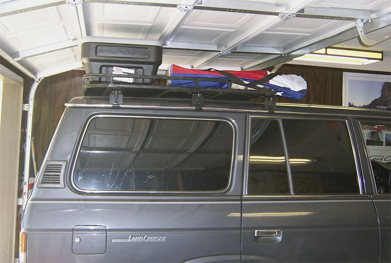

I've probably had 600 lbs on the roof of mine easily. It can handle it fine if the load is spread out, at least 4 sets of roof rack clamps. I also cut a layer of a epozy caulk that helped protect it. Not actual damage from the roof rack.. I would definetely have a custom one built, one like the pretty one easlier, or something with aerodynamics as best as possible - wide mesh, not a lot up front, thinner metal the better. Some day I'll post a pic when I build a better one. The rack alone also weighted at least 100 lbs (also a custom, but on that was given to me). I could not wait to get it off once I got home from the trip...
here is a photo :)

Freak'n awsome :cool: .
here is a photo :)
