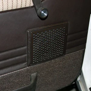

I made some panels out of wood. Country style! I mounted some 6x9's and put some foam behind them for sound proofing. The speakers sound good. I also mounted apline's in my front doors and just left off the speaker grill that came with it.
Here is a shot of the front (no spacers and behind the factory grill) Not much to see really.
attachment.php
No problems at all with the space...just had to cut it out to fit the larger size. The Second photo is of the rears..I had to get rid of the ashtrays in the back but I gain some sound.
attachment.php
