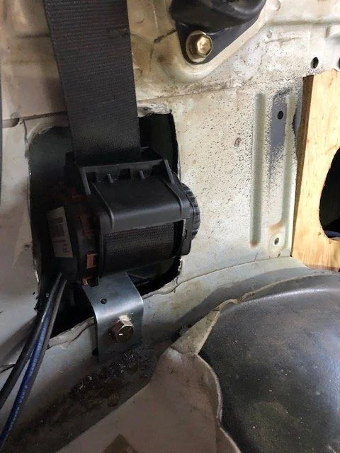

This is literally what Seatbelt planet needs to do with one of the retractors they sell for the front. You get the retractor, bracket and metal mounting plate. Photo shamelessly taken from @4Cruisers
So.. if you can get a retractor with the correct length and matching shoulder loop to the front. You can fabricate a mounting bracket to work.

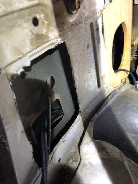

Can I ask where you got these rear retractable seatbelts? I'm looking for this exactly. I ordered some rears from seatbeltplanet and they won't work to get that recessed OEM look. They're really meant to be externally mounted. I've cut the cavity out and was about to mount them when I realized they wouldn't work without a custom fabbed bracket. Appreciate the assist. Thanks

It was a more expensive route. If you can bolt it in like the photo in the post you replied to you can save a good bit by using what you have. Another potential option would be to look at using the OEM A pillar mounting bracket and see if that could be used to help recess the belt retractor.
Do you have any pictures of how your trying to mock it up?

Ended up fabbing up a bracket to recess the seatbeltplanet retractables. Kind of a pain, but in the end worth it. I realized if I couldn't fab something up, it would require me to drop more cash on OEM belts if I could find them. One side done. Let's see how tomorrow goes. Thanks for the reply. Jaime

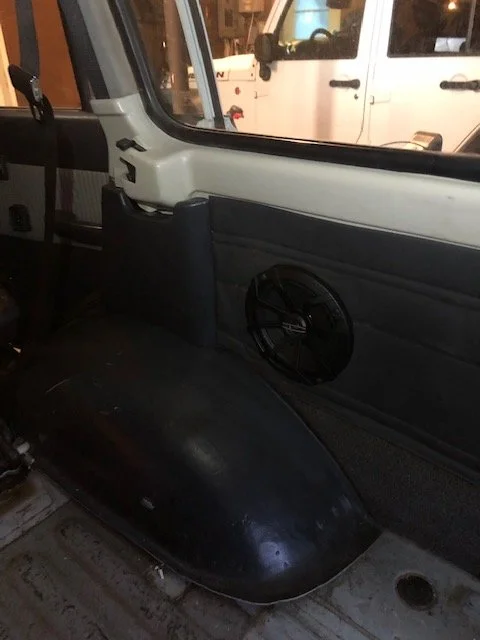

Does anyone have a pic of the original mounting in a 62? I am now working on sourcing the trim pieces thanks to @JramFJ, but what really concerns me is the mounting of the retractable lower pieces.
I am thinking of some steel strapping inside the panel?
Here are the 62 retractors I added to my 83.
A pillar bracket I was suggesting in the comment above. If you sourced a set and flipped them side to side you could use them as a recessed bracket for the rears possibly.
