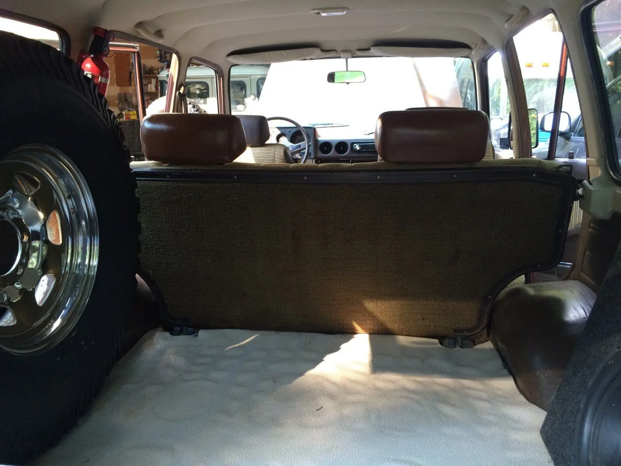

I am converting to three point belts for the rear seat. Also, the winders are broken on both front belts so I ordered up four belts. Waiting for those to hit the doorstep any day now. As part of the upgrade I wanted to add headrests to the rear bench. 62's have them but the 60's did not get them. Most folks doing this upgrade will just swap in a seat back from a 62. I couldn't find one so I decided to go renegade and modify my 60 seat to accept headrests. My buddy Rafael @Roxx provided me with a set of roached out front seats from a 62.
As you can see, I have cut out the seat frame section that has the keepers for the headrest tubes. A little more cutting got me to here.
The 62 seats and headrests were gray. The Turdle interior is a beautiful brown so gray would just not do. I found some brown vinyl spray paint and painted the headrests and tubes.
Next task was stripping the upholstery down to the frame and welding in the new parts.
Finally, recover the seats and slide in the headrests. I didn't have any hog rings or HR pliers so I picked these up on Amazon for $12. They worked great! Seat is covered and ready to install.

Whoa, nice work on the seat, never would have thought that to be possible, but here you are done-did-it. How close of a match is that brown vinyl paint? Looks like it might be a touch on the light side, but it could just be the camera/etc.
The match is not great. It is very hard to find brown vinyl spray. Blacks and grays are available at most regular parts stores. I had to order the brown and you're right, it is lighter than the fronts. Think of peanut brittle vs. milk chocolate with the new spray being more peanut brittle. It's the best I could do. If I am able to snag a pair of brown front headrests from a wrecked 60, I'll swap them later.

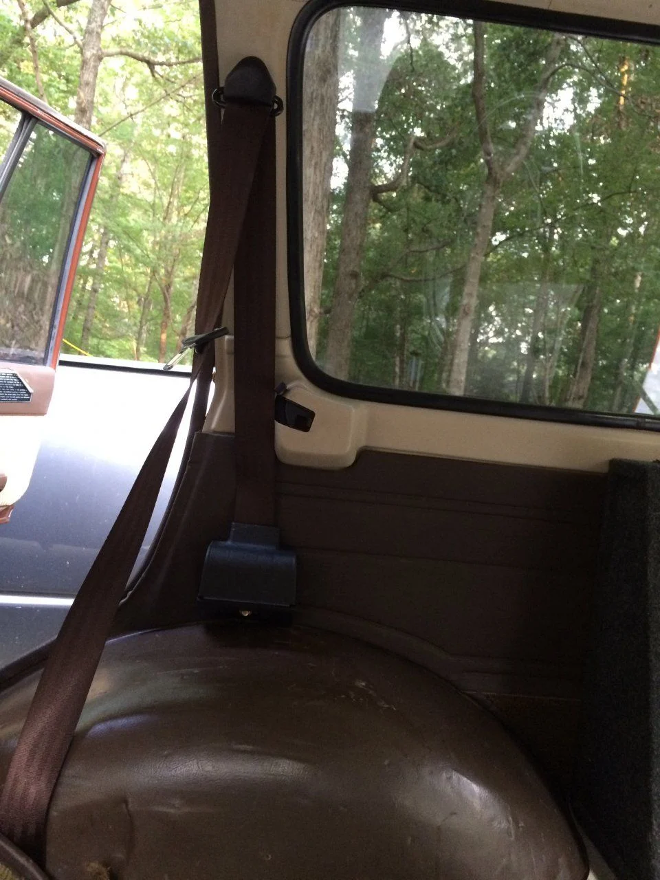

I installed four new retractable three point belts this week. Seatbelt planet had a custom template just for the 60 series 'cruisers. I ordered up a full set in dark brown. Install was a direct bolt-in for the front. The rears required a little more work due to the 60's not having rear shoulder belts from the factory. I did luck out on the top pivot mounting point. All 60's have a hole behind the fabric where the belt mounts. Only a few had captive nuts behind the hole. Mine just happened to be one of those! On to the install pics.

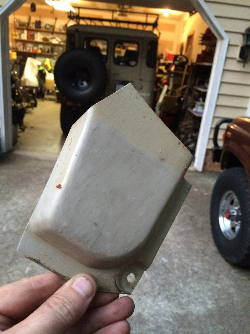

The rear seat belts were not quite as easy as the fronts. I re-used the latch side mounting points and just removed the old latches and bolted in the new ones. The upper "pivot" mount was very simple as well due to the existing hole in my pillar being threaded. If yours is not threaded (most aren't) you will spend quite a bit of time and effort trying to fish a nut up into the pillar from behind and attempt to either glue it in place or somehow hold it there long enough to thread in the pivot bolt from the front. The lower part of the belt required drilling into the fender well. I chose a spot near the seat back hinge due to the metal there being twice as thick. Simple fender washer behind the bolt and cinch everything up tight. Mounting the retractor gave me the most trouble and the driver side was more difficult than the passenger side due to the rear wiring harness passing directly over the preferred mounting point. I had to remove a plastic bump-out that was intended to accomodate the wiring. Removing the plastic allowed me to mount the retractor flush to the wall but the extra vinyl that once covered it sort of bunched up when I tightened everything down.
