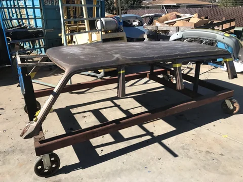

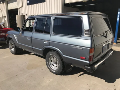

I bought a great 1985 metallic blue FJ60 with 103k miles on it in October. It had roof rust on both sides but everything else was great including interior. I drove it around various body shops but nobody wanted to touch it. Finally I met the guys American Custom Classics in Hollister, California and they shared the passion. My goal is to restore and preserve this truck for my three-year-old son. So we decided to chop the top. We will replace it with a top from another rig and rust proof the entire thing.
IMG_1589.webp IMG_7972.webp I bought a new roof from Cruiserparts and had it shipped. IMG_7973.webp

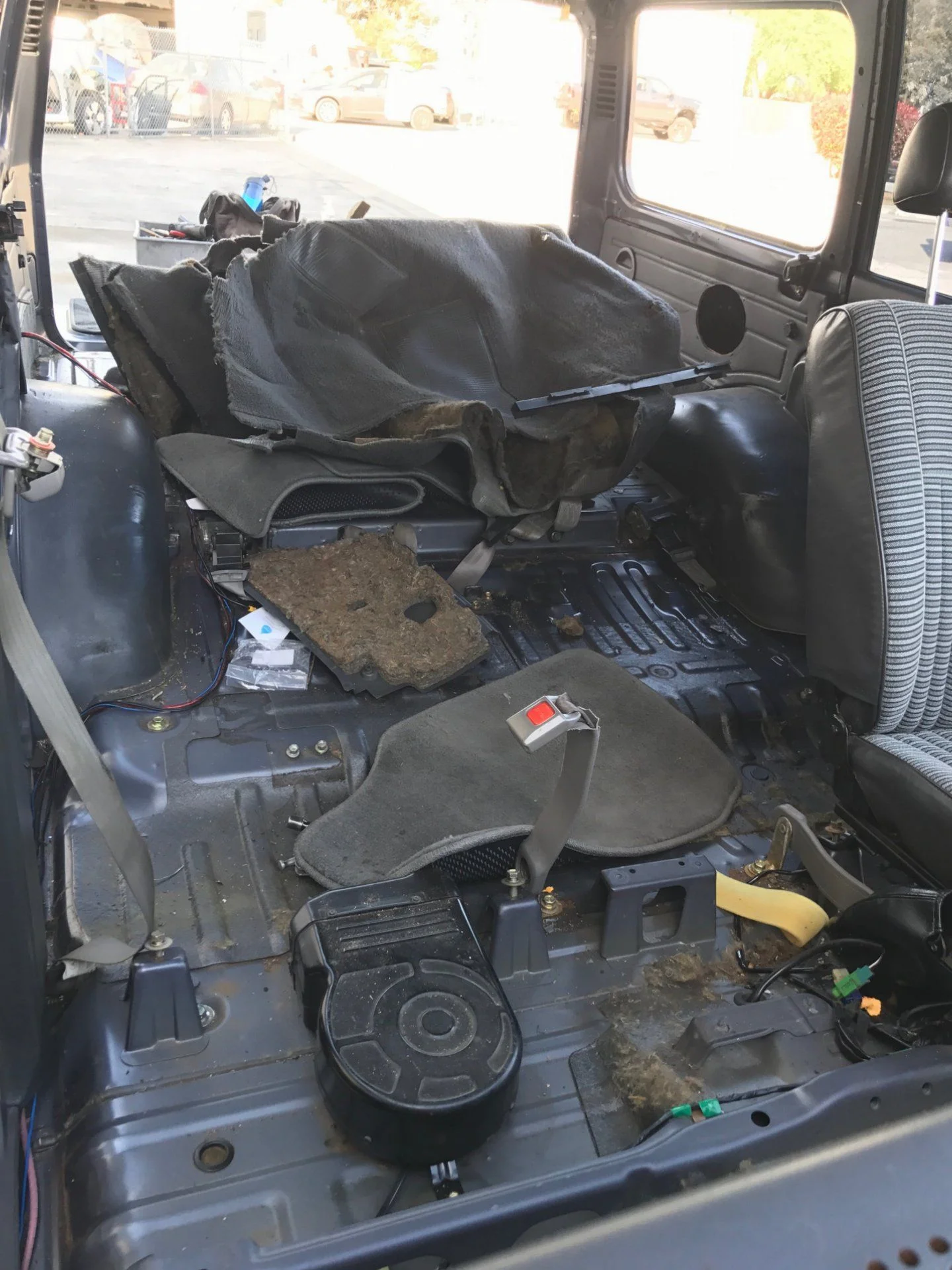

Thanks! I plan on heading over to see Georg once the body work is done. Here is a pic with the windshield out. My thinking is that water entered through the gaskets, evaporated to the roof internally and ate its way out.
Nice! I plan to do the same thing to mine one day.
Frequently, roof rust is due to failed caulking in the rain gutter bottoms (and other roof connection points). Be sure your new roof is well-caulked there, and then park the dumb thing indoors, out of the sun (unlike all the POs).
