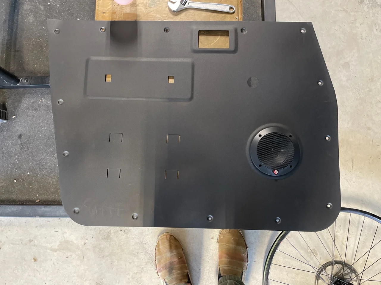

Got some beautiful Aluminum pressed door panels from orikawa today. Can’t wait to put them on. Company is great, great communication, quality product. Look forward to their other stuff!
Those tabs are for molle straps…. Looking for some low profile bags to put on there now. Speaker holes are 6.5 rear doors and 4 front. These Rockford fosgates are fairly inexpensive and have low key metal grilles so go perfect.

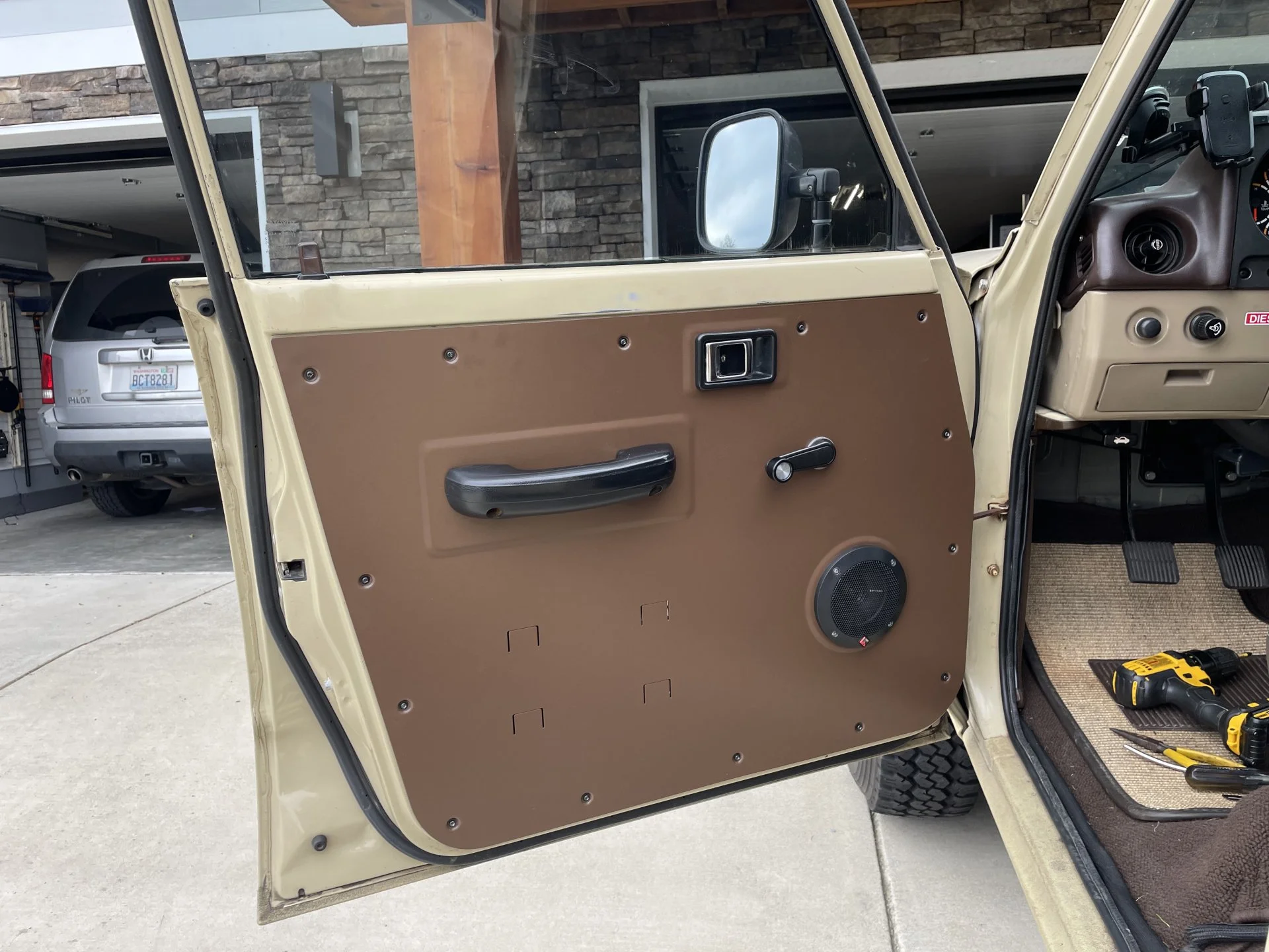

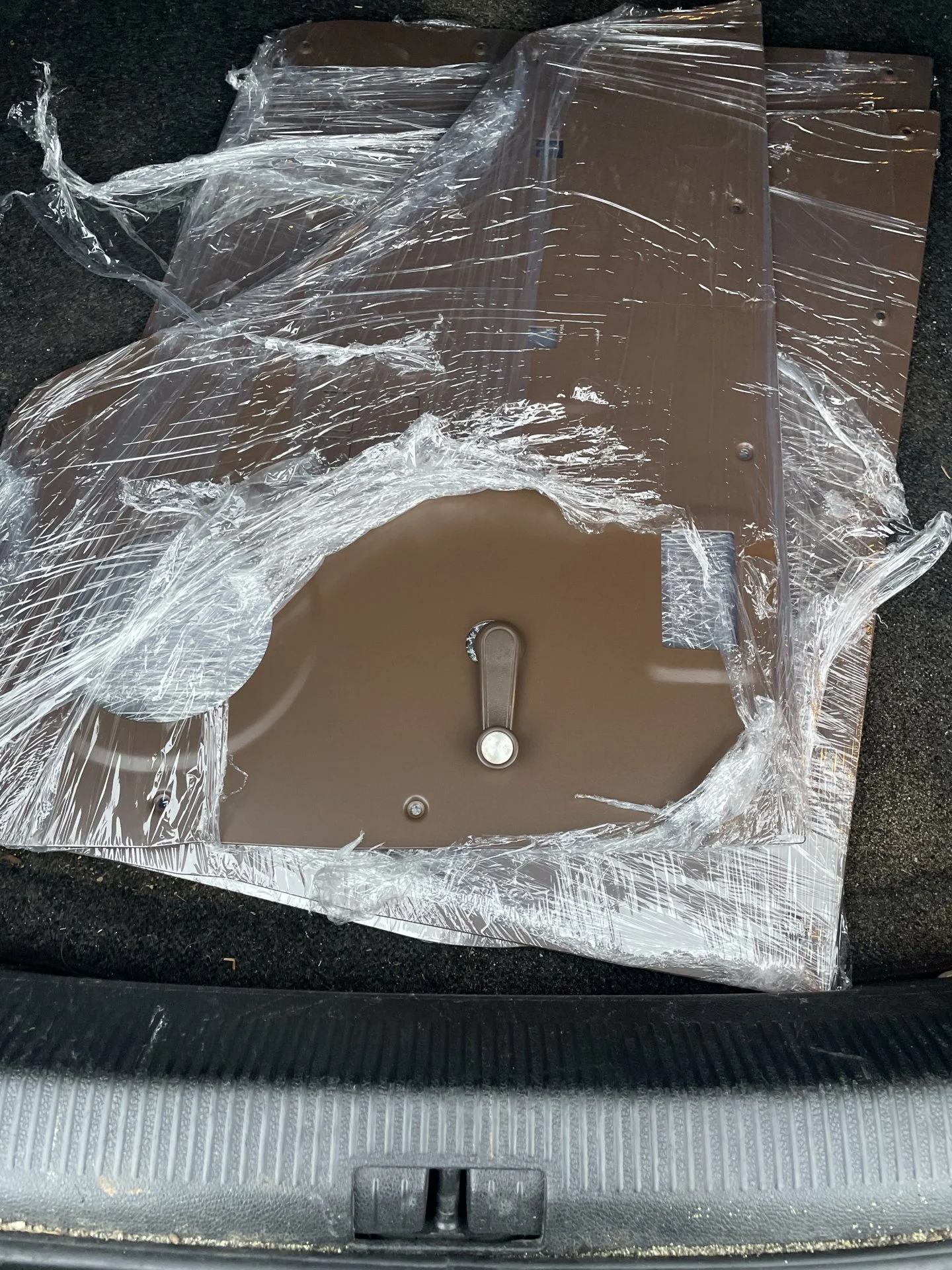

I started putting these in and realized f it. I want brown panels. With the black arm rest, speakers, mounting screws, and window cranks I think it will look way better than straight black. Went to the powdercoaters and spent an hour trying to match the brown interior. Prismatic powder Tacoma brown is about as close as I could get and is a satin finish. Shown next to factory brown crank. Excited to put these on…

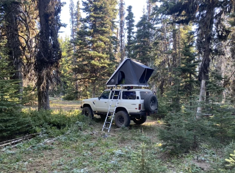

Journey is still underway. Got a 31mpg tank and a 28mpg tank so im continuously thrilled. Spent some time in Montana and Wyoming, so beautiful. Came out from a brewery to a puddle underneath the truck... a coolant hose had split on the bottom. Thank god I had extra antifreeze and tools.
Time to let the adventure continue. Top will be on this week!
Squaretop Mountain. Sweet. I’ve been on top of it a handful of x’s over the years. Great fishing at those upper lakes in the Winds. Very nice 60 as well. Just finding this thread so a bit late to the party.
