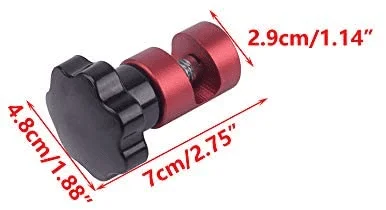

Get yourself a pair of these. We use them for the rear hatch on our trailer when we have its awning out. Gets too heavy when wet and will come down on my head otherwise.
But yeah, don't pay $30/ea LOL. Forget where we got ours but they were more like $20 for a pair. eBay most likely.
Strut Stopper
