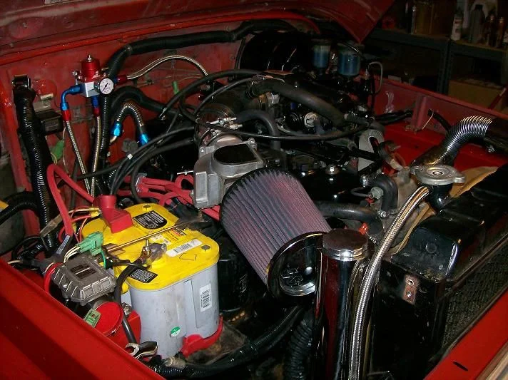

Here is a picture of my engine compartment if that helps you.
attachment.php
Plenty of room for a snorkel my problem is more room for the air box, but there is always a way around a problem.
4"intake.
