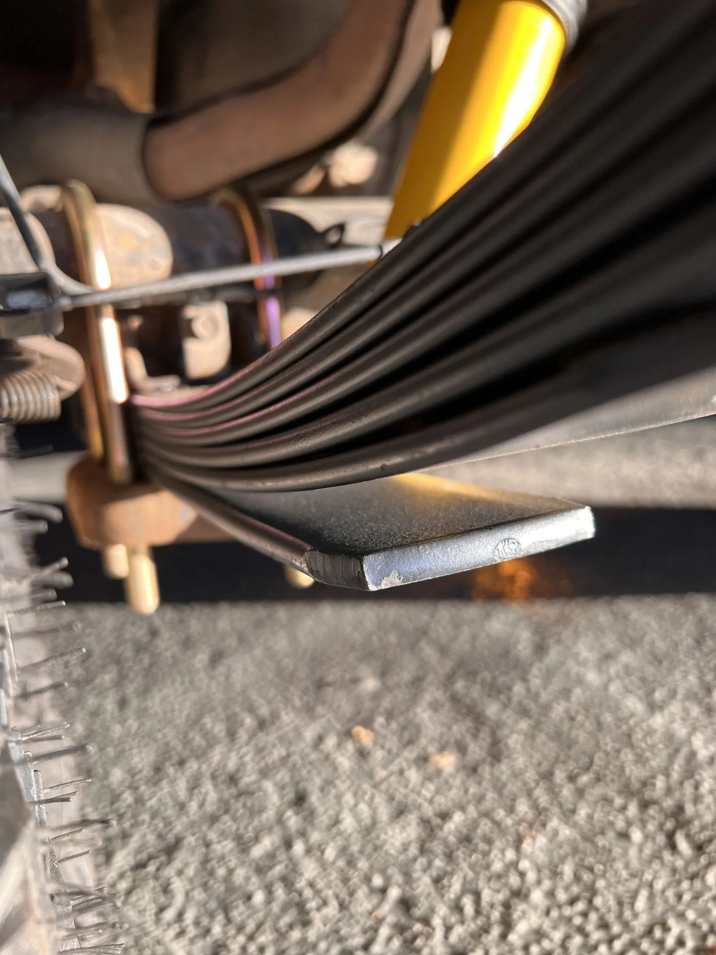

Hey @smtdvm I just did the OME 2.5 kit CS001F springs with 8 leafs in front. was surprised when it was stiffer than the original suspension setup. Full OME 2.5 all around with BTB anti-inversion greaseable lifted shackles. I spoke with BTB and confirmed the OME is correct Light/Medium which is the lightest OME makes they say. I would have thought it would be less stiff. This is only 2nd day of driving but it bounces you around and shoots coffee or whatever you're drinking (and holding with lack of cupholder) into your face/roof.
the question i have is, wondering if i did something incorrectly or how long you waited for yours to soften/break in?, BTB reviewed my setup on video and confirmed all is good/installed correctly. with the Zero toward frame side on passenger front and + toward frame not shackle side on drivers front. same on the back end.
How long it may have taken for your ride to soften up. I weigh 200lbs and if i jump on font bumper it probably lowers .75 inches temporarily but not much play. Granted with No-Sway bar I understand why they can't do super soft springs but this seems a bit much. or maybe I just need to be patient. not a strong suit of mine... ha.!

I would remove leaves starting with the shorter ones on the bottom until u get the ride u want. FJ40's have really short springs in the back, lift springs are even shorter resulting in awkward shackle angles. If u want a soft dialed in ride SOA with longer leafs in the back are the answer
Spoke with BTB guys and said 3rd from top in the front spring stack would be the suggested leaf to remove. i think ill have to try it and see if it changes ride height and if improves feel... i don have a winch on it yet. PTO sitting in garage may change ride later but cant imagine that much.. thanks!
