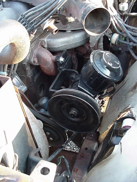

Test fit means I need to come up with a new PS pump mount for the 40...
I use a PS pump mount from Mark's Offroad. Power steering is now lower drivers side.
I can elaborate on this...
After I read Mark Whatley's article in the Toyota Trails about putting 60 series PS on a 40, I wanted to do it.
My 40 is an early '78 (09/77), so my block is not tapped for a PS pump mount. I also live in an area that does vehicle emissions testing for air quality, so I needed to keep the air pump. My solution to mount the PS pump used the exhaust manifold as part of the design - not perfect, but it worked.
More details here: FJ60 Power Steering Conversion for FJ40 while keeping air pump - https://forum.ih8mud.com/threads/fj60-power-steering-conversion-for-fj40-while-keeping-air-pump.84527/
