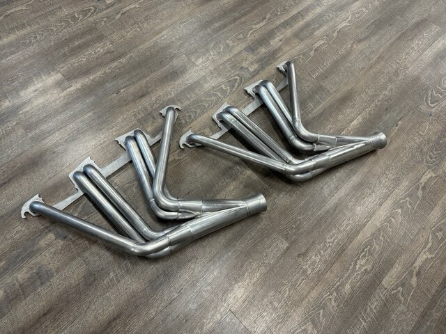

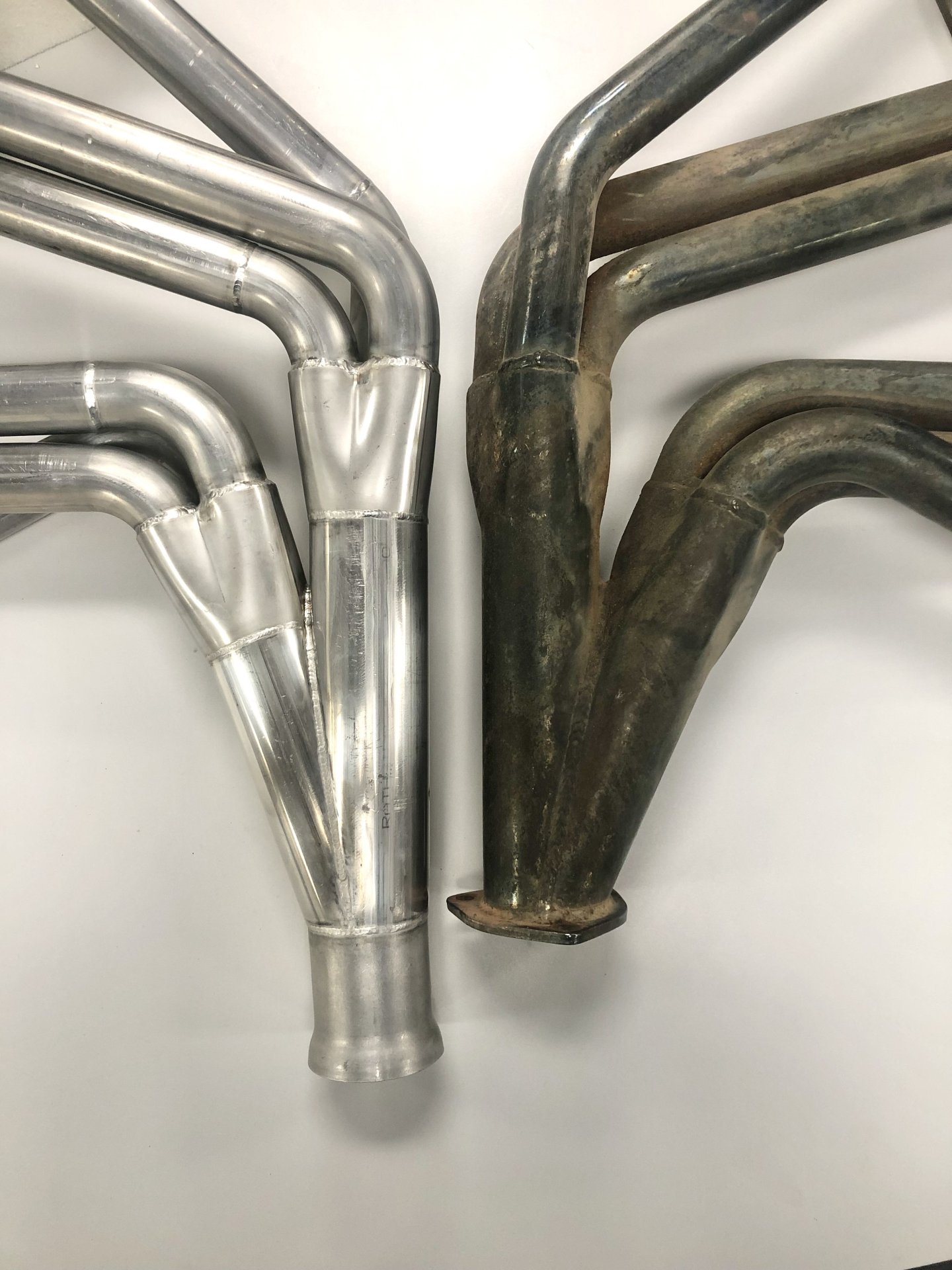

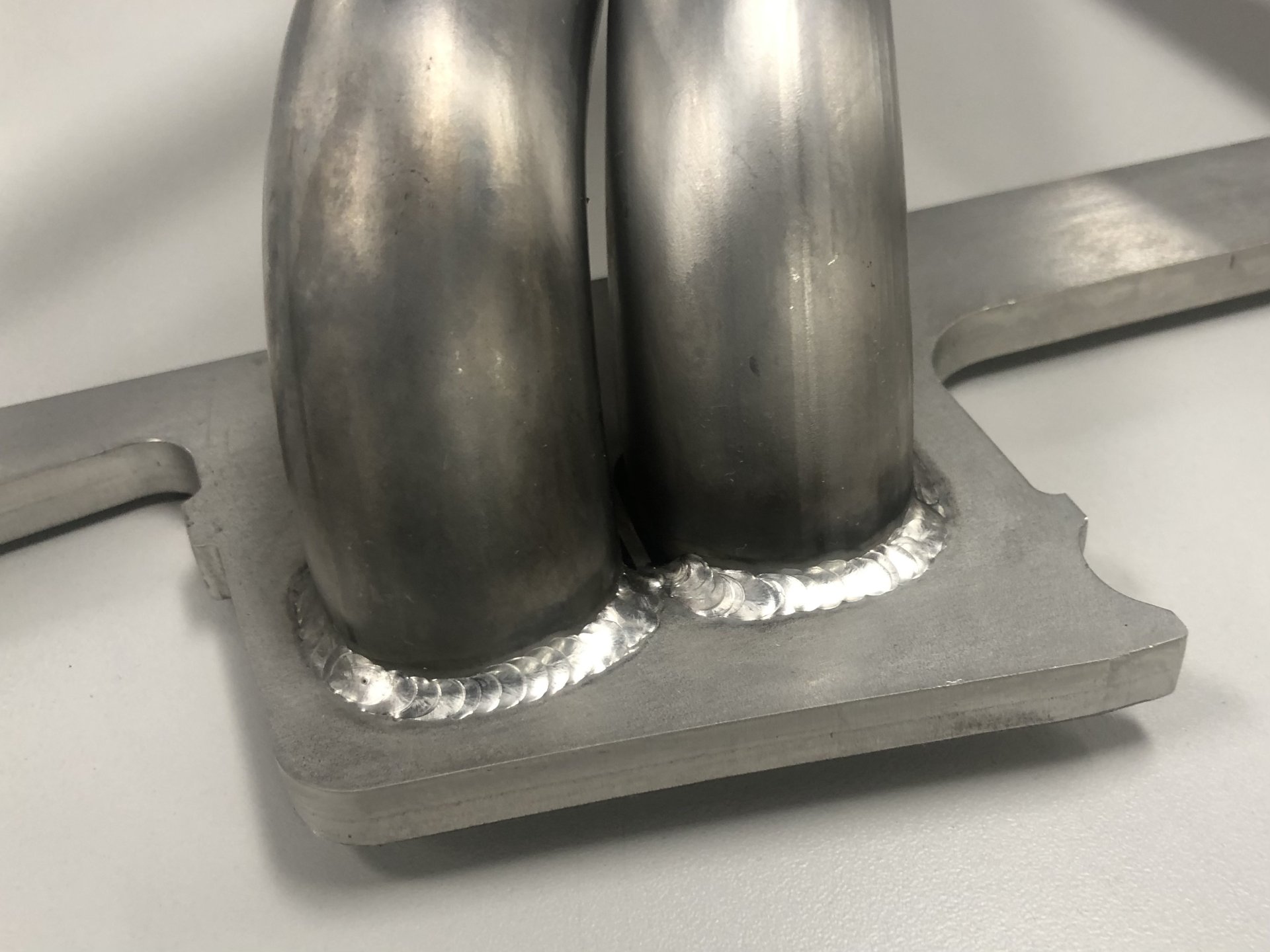

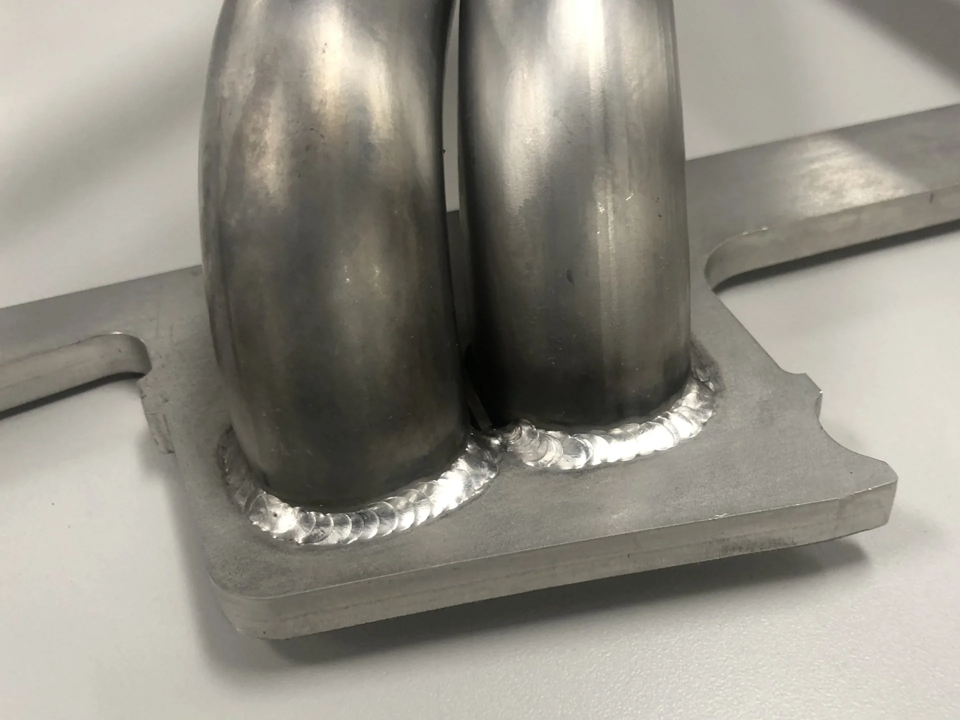

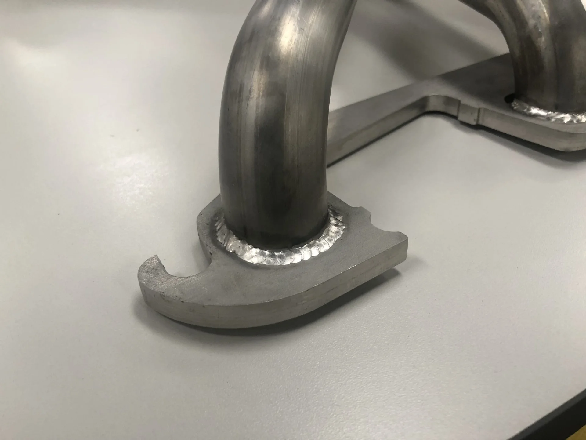

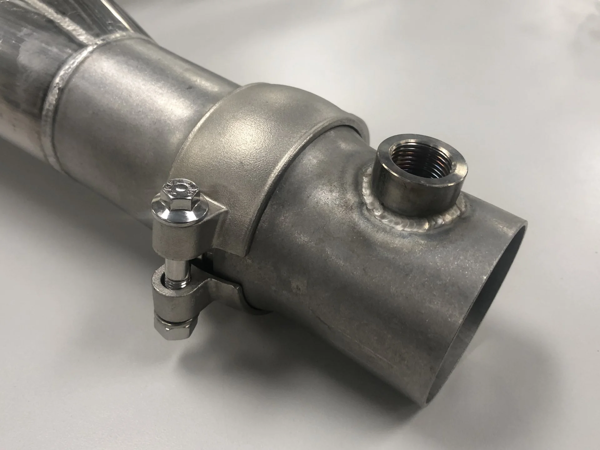

First two samples are being shipped to us.
If you look closely at the photo you'll see lines on the straight sections of tubing. They cut the tubes to shorten them and re-welded the butt ends back together. The tubes will be continuous in production variants.
The clamps and pivoting flanges with an 02 sensor bung on each one are not in the photo, but are being sent as well.

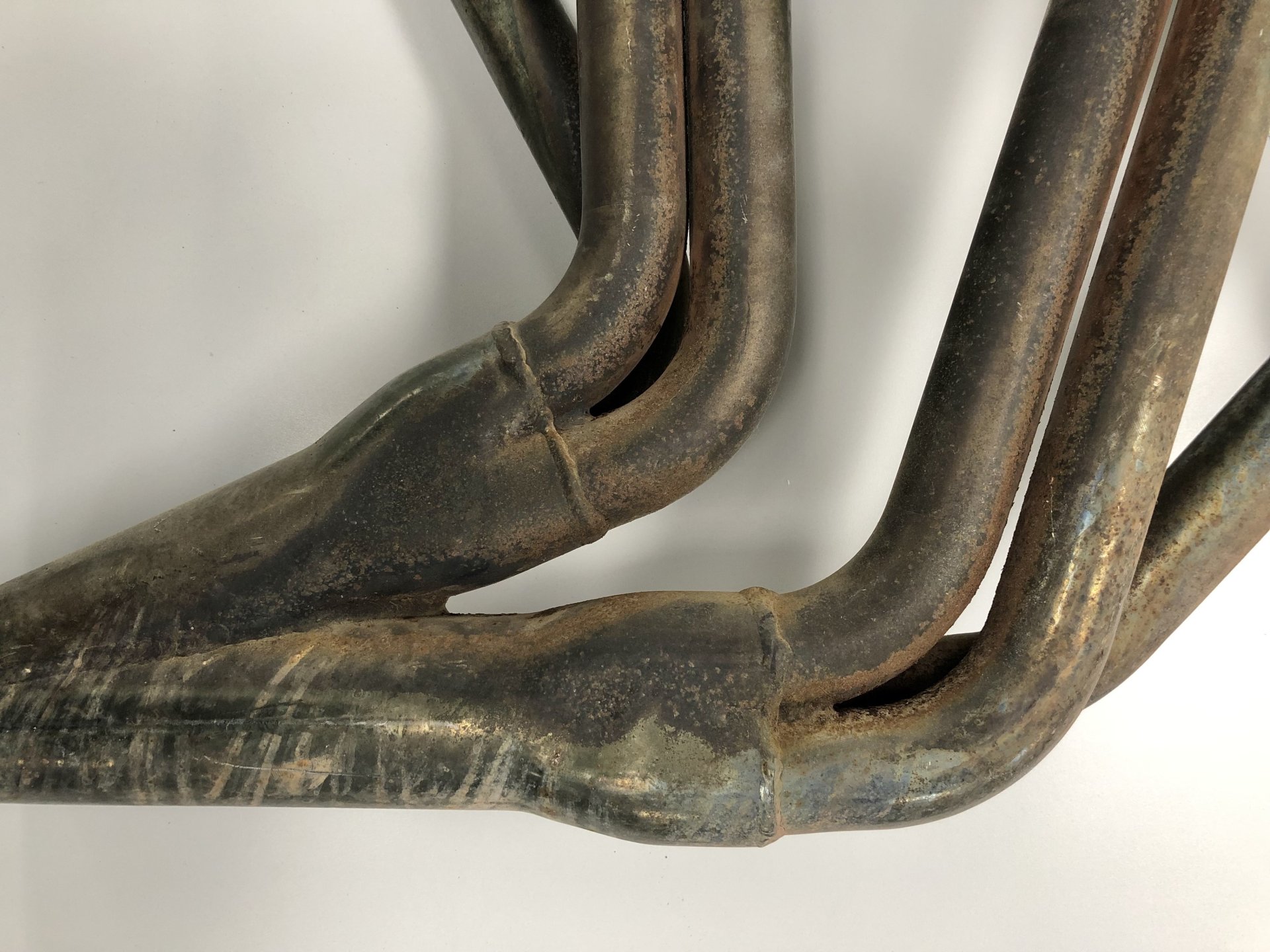

The vintage Mark's header on my shop truck has finally developed a leak inside one of the 3-->1 collectors, pretty much impossible to see or weld repair. I can't believe I hafta replace it after only 17 years of abuse. 🙄
