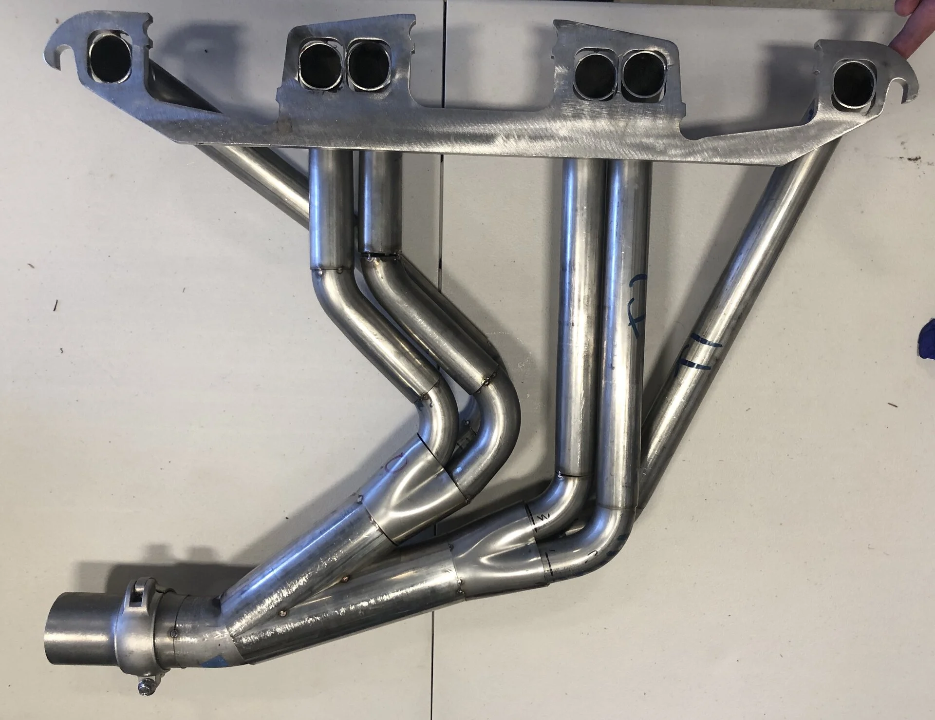

As much as we wanted to simply make a copy of the Downey/Mark's header, we just could not leave well enough alone.
@gonzopancho says it best here in this post - there were opportunities to improve the fit.
We are getting close!
Our manufacturer mocked up this latest version on a 40 (film at 11), and then sent it to our industrial designer for review. Our guy is very good. He used to work at BMW NA. He fit the tacked up v3 prototype, made a few notes, and sent it back.
What I will say is that the final product will fit very well, and is a beautiful piece...

The stainless (new) header is very, very close to the end of production / final design from Mark’s / Downey.
It will fit fine on a 40-series or 55 that has PS box moved "up-front": 60/80 box, Scout, Astro-van, Saginaw, ...

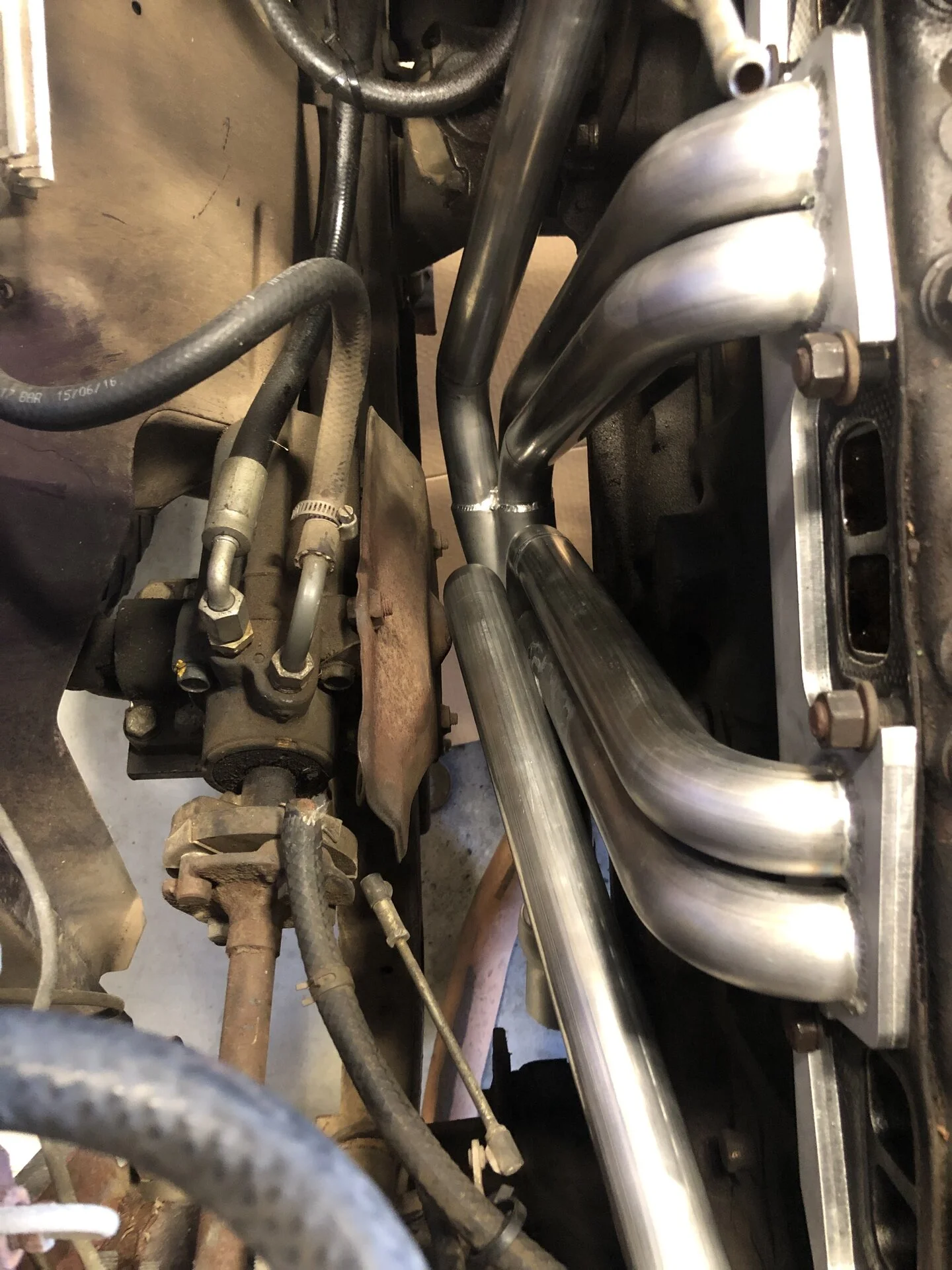

There is a small issue with the factory box, PS or not. Same concern with the conversion on @bottombracket’s fj40 (“Barney”), which runs a mini truck box on Georg’s bracket.
So we’ll tuck the #6 primary a bit more in production. You can see where the heat shield for the mini truck PS box and the header just touch. (The intake is not on the truck for a clearer photo.)
Georg (@orangefj45) has the second prototype and we’re currently waiting to hear from him before pushing the “Start” button.
