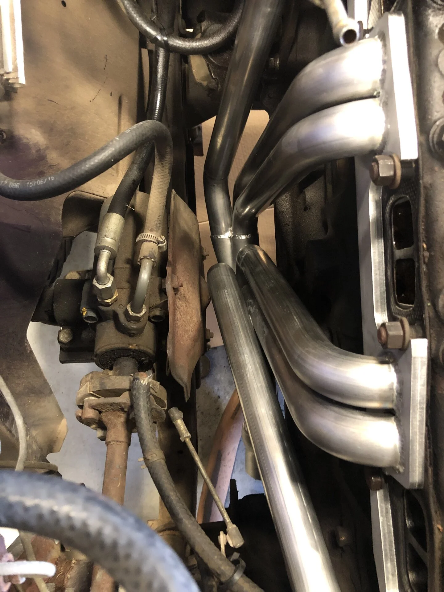

I know it’s been a year, but we want this right.
The stainless (new) header is very, very close to the end of production / final design from Mark’s / Downey.
It will fit fine on a 40-series or 55 that has PS box moved "up-front": 60/80 box, Scout, Astro-van, Saginaw, ...
There is a small issue with the factory box, PS or not. Same concern with the conversion on @bottombracket’s fj40 (“Barney”), which runs a mini truck box on Georg’s bracket.
So we’ll tuck the #6 primary a bit more in production. You can see where the heat shield for the mini truck PS box and the header just touch. (The intake is not on the truck for a clearer photo.)
Georg (@orangefj45) has the second prototype and we’re currently waiting to hear from him before pushing the “Start” button.
@gonzopancho thanks for letting Barney be the Texas test subject. Looking forward to the next steps!
