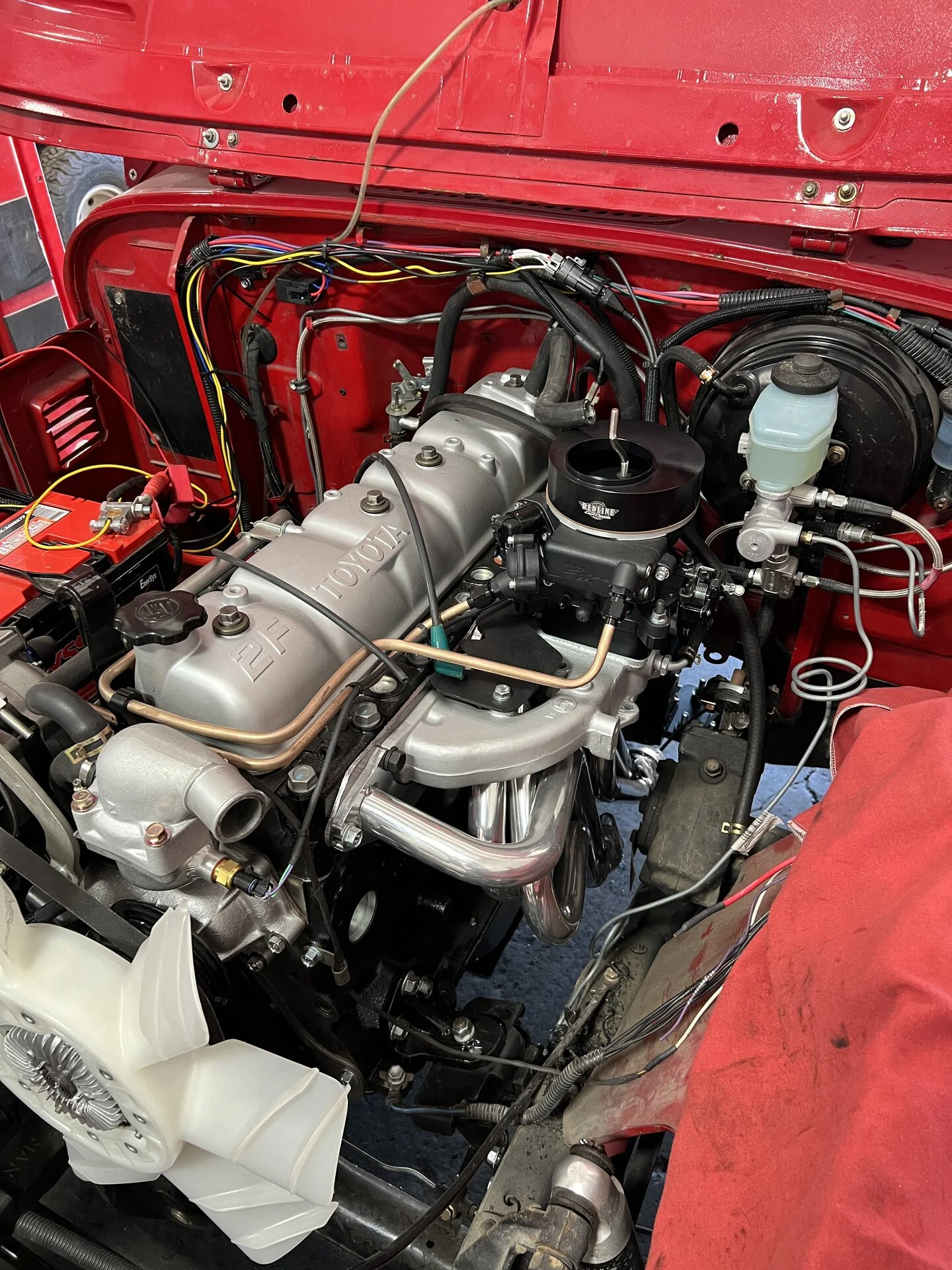

FJ40 Mark/Downey Header
The fit was pretty good!
We had a few changes which I believe are now locked in.
Flanges (laser-cut flanges) should be arriving this week.
We are getting close!!!

Hi @PabloCruise,
I would like to look at getting a set of the stainless "Downy-Mark's Offroad" headers from you when they are ready. I have a FJ40 I am having completed with a 2F (higher-output engine) from Yota1. It will have a Redline-Holley Sniper Kit and a Dakota Dash and a new H55F 5-speed and split-case. The with the stainless headers will be a perfect match with the 2.5" stainless exhaust I am planning. I'll post pictures to the IH8Mud group when finished, since I have resourced many of the ideas from here.

Wow, that is a good looking 40!
Thank you for your interest - I will add you to the list.

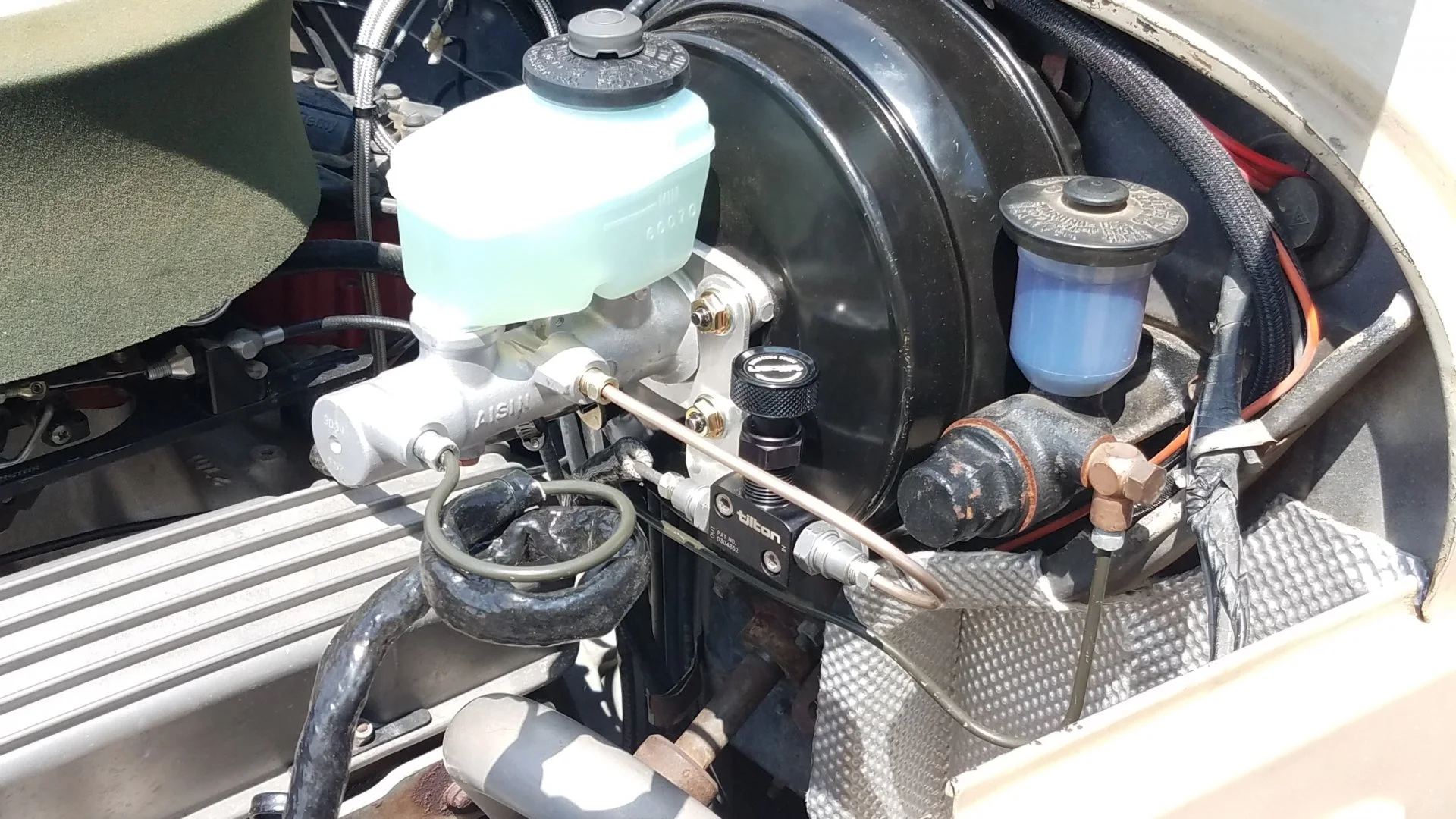

Quality work. Please explain the parts used, source, and the plumbing flow of your FJ80 brake master cylinder install. I have a new non ABS FJ80 brake master cylinder waiting in the wings for its install and see that you've gone in a different direction than I had planned. I currently have a proportioning valve for the rear brakes. Is that what the braided line attaches to on your pic?
@Blue77FJ40, I purchased the setup from Redline Cruisers, it is a 80 series unit. I needed the bigger setup and valve for my full front and rear disc brake conversion. I had drums all the way around and now it stops and slows perfectly. The tubing is horrible, I purchased it from SOR (Specter Off-road) in a kit. Nothing fit and the ferrels leak. I need to redo them but thanks for the compliment.
Got it. My rdb currently is on the stock two system '77 40 master with the adjustable prop valve on the left side. Sorry, no pics on it. I will be installing the '80 master very similar to below pic. I have the mastercool flaring tool along with a few line bending tools and will make up any new lines I need.
