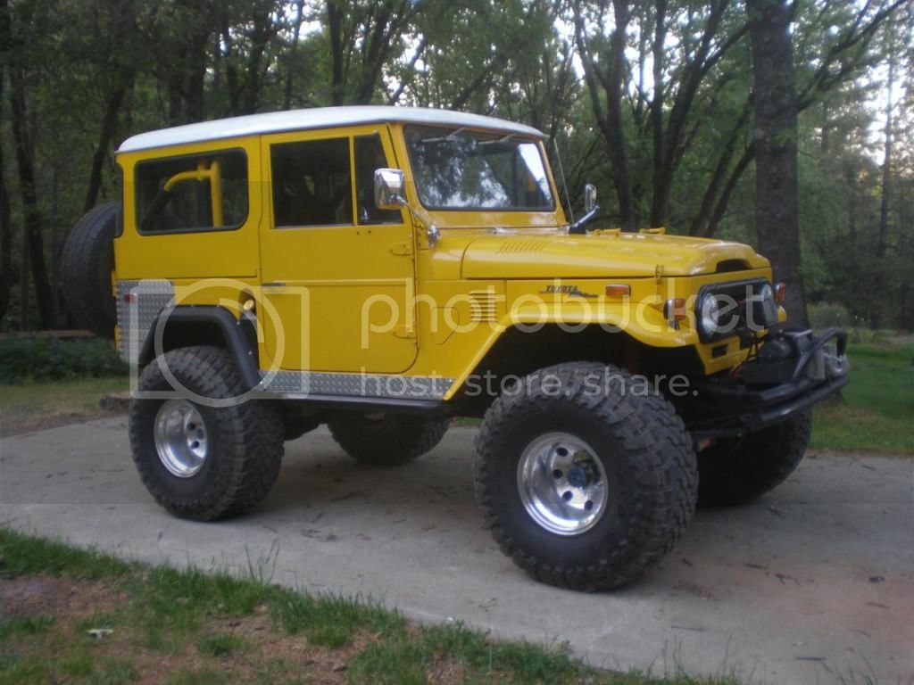

Body lift with 1.5" UHMW blocks and Energy Suspensions bushings.
Nice looking 40, is the spacer for the front grill UHMW as well?
how did you work the fenders?

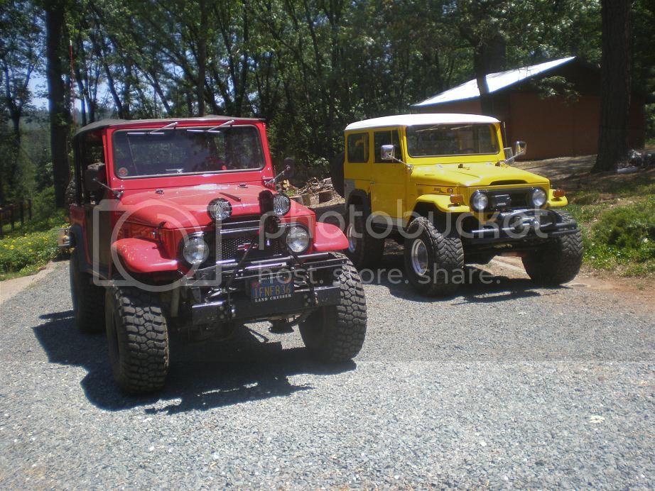

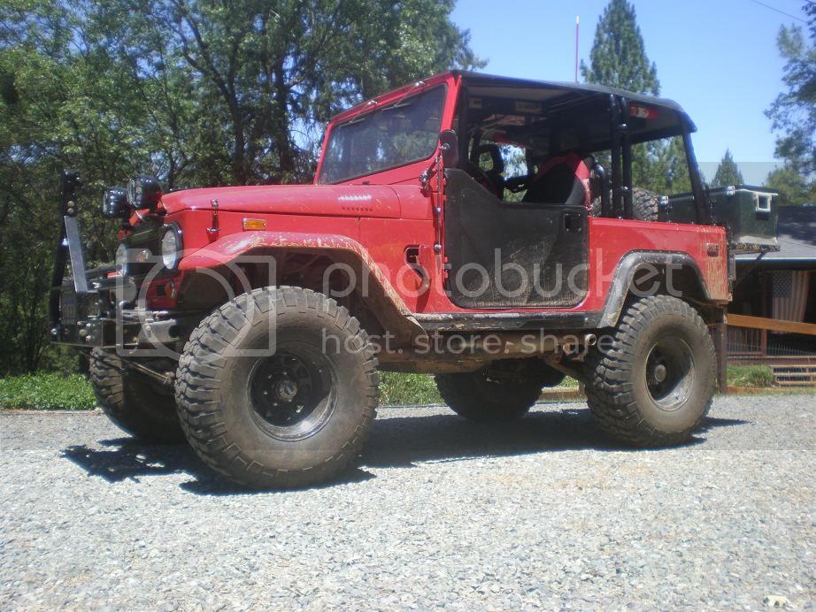

These are the rigs I have. The red FJ40 has a 1" body lift, 4" lift springs (SUA), and lift shackles which amounts to a 5" lift. 35" tires and 15x10 wheels
The yellow 40 has a SOA lift with stock springs on 37's (15x12 wheels.
So the red 40 sits a couple inches lower than the SOA 40. I just sold the Yellow fj40 on ebay. Think the buyer is picking it up on Wednesday.
The front spacer is UHMW wrapped with sheet metal painted black. The fenders and frame were drilled and tech screwed.

LRChops, any reflections on one vs another if you were to lift another one in terms of performance, time requirements, costs, ease of use as a daily driver, etc.? Thanks, Taro
I like the SOA but to do it right is expensive unless you do your own work. SOA puts more pressure on the rear end when wheeling up hills and there is a risk of axle wrap. Higher center of gravity which does not bother me.
The SUA seems more stable and is far less expensive. I like SUA with tall springs and shackles reversed up front. Handles better than the SOA for a daily driver.
I have both and I am keeping the LC with SUA. I run 35's with the 4" springs, 1" body lift, and tall shackles. Seems to work out fine, although it does not look as COOL as the SOA. SOA by far better for rock crawling and clearance issues.
SOA with the right springs should work out.
