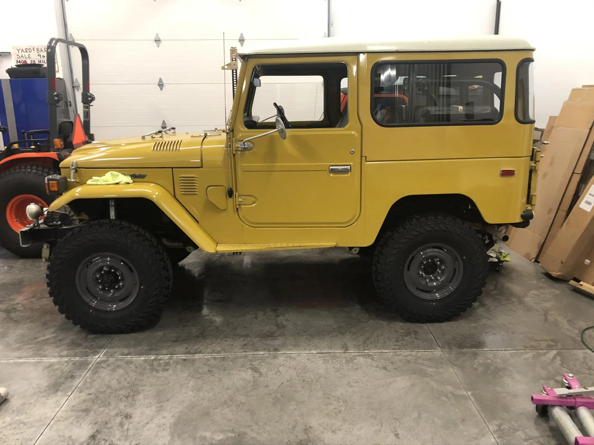

Thx for compliment. Probably going to sell it as I never drive it.
Yes, but do you look back at it when you park it and walk away? If yes, don’t sell!
