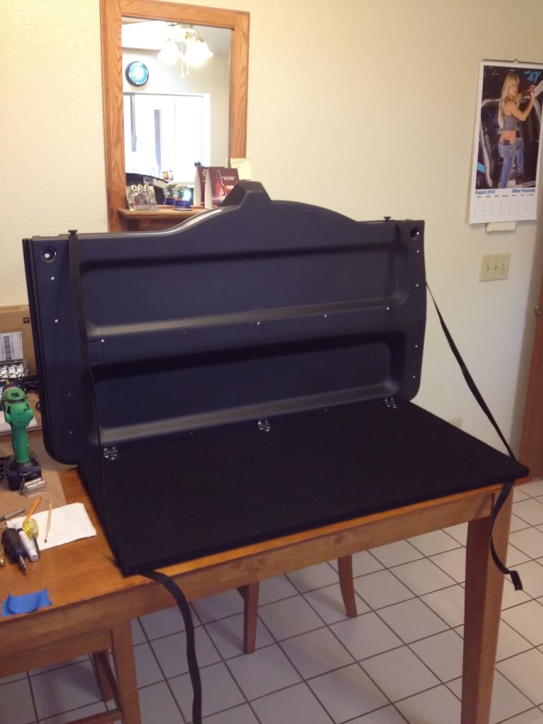

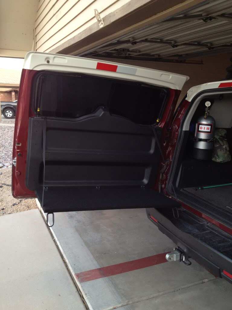

Just finished my table for the rear door.
Been working on it this week, the kitchen table has been my workshop (way to hot in the garage...)
Almost finished.

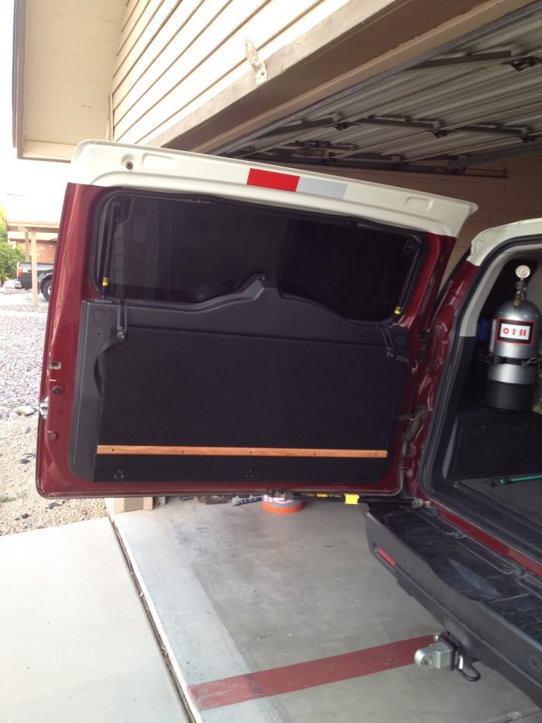

Installed it this morning. The oak strip is to hide an additional seam cause I fawked up...
All I need now is some 1/4" plugs to fill the holes from the cargo netting...
Materials list:
3/4" Birch marine plywood 39x19
Black speaker box carpet
1" webbing
Nylon hinges with SS pin
Kolpin rubber straps
Black plastic knobs to attach webbing
Assorted screws and what not...
