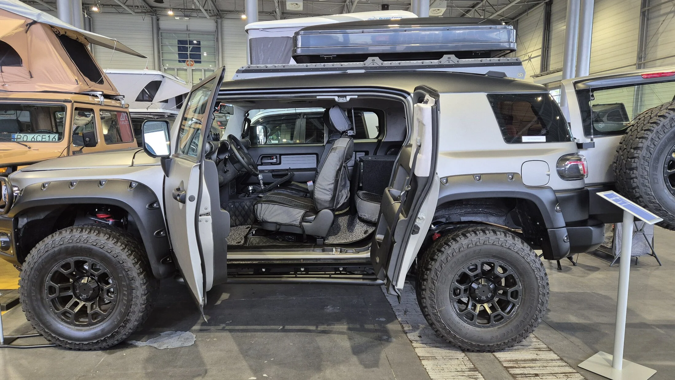

Hello guys,
I have some issues with FJ Cruiser 2010, namely too much fuel consumed. Yes I know, drive slower....I have LC100, LC200, 4runner....and other.
I know this is very old topic. However I have spent over 2 years building and moding my FJ. today I was drivind 130km/h and avaraged 30L/100km [80mph/8mpg].
I have no modified intake, but a snorkel. My engine is 30k km old [replaced recently/old one was doing same bad milage] . I run 34" tyres, roof rack and tent. Weight about 2400kg.
I had a 4runner with same setup and it was 18L/100km at 140-150km/h. Same engines, same tyres. LC100 and 200 also performes about 18L...
My car is bought as a near junk, rebuild and engine replaced. Can the ECU have been modded that it influences the MPG!?
Thanks.
