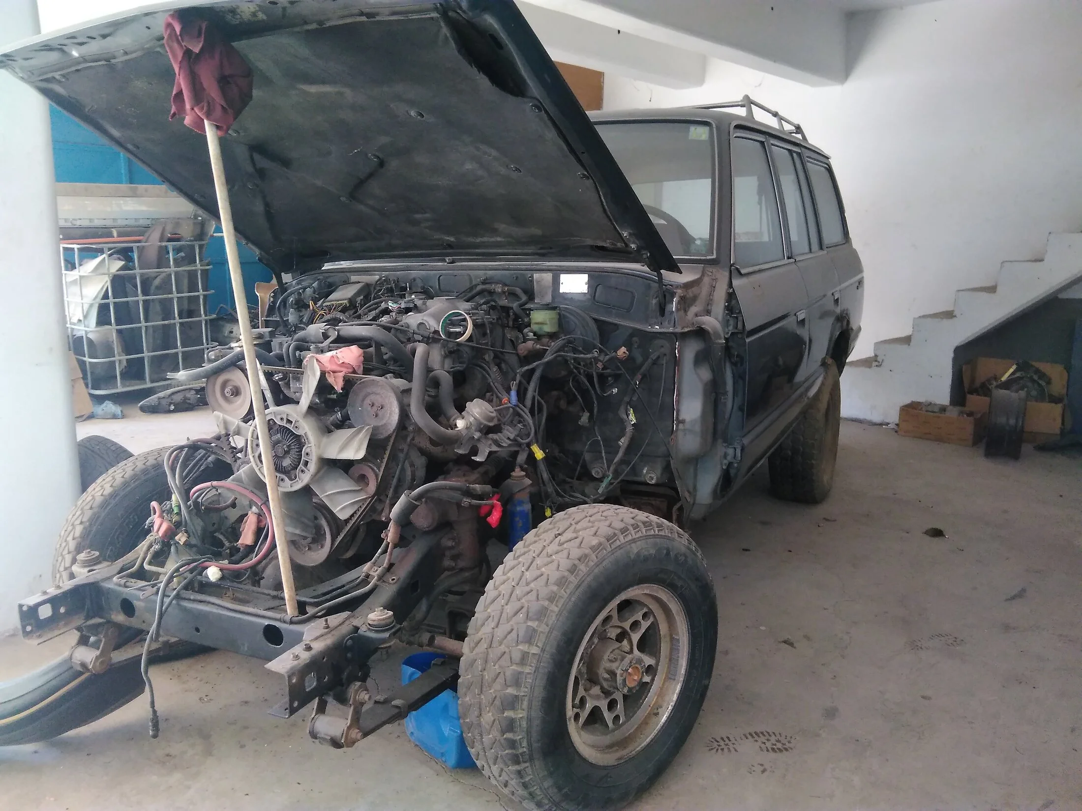

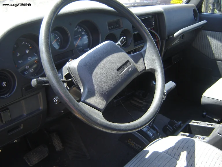

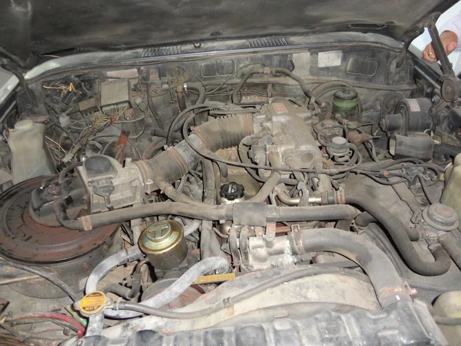

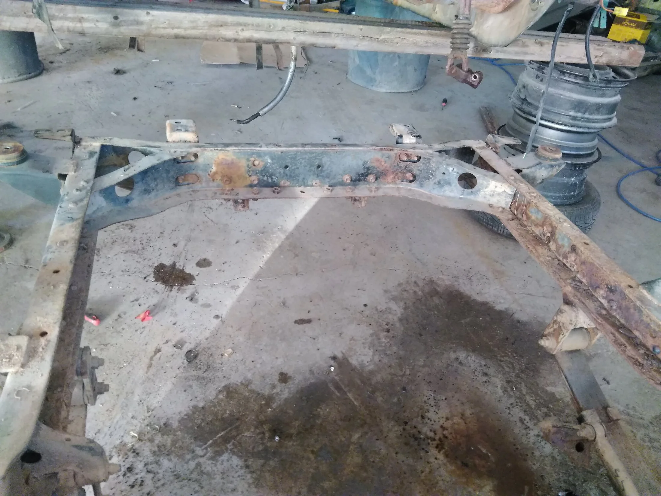

this car came to our hands and started the restoration.

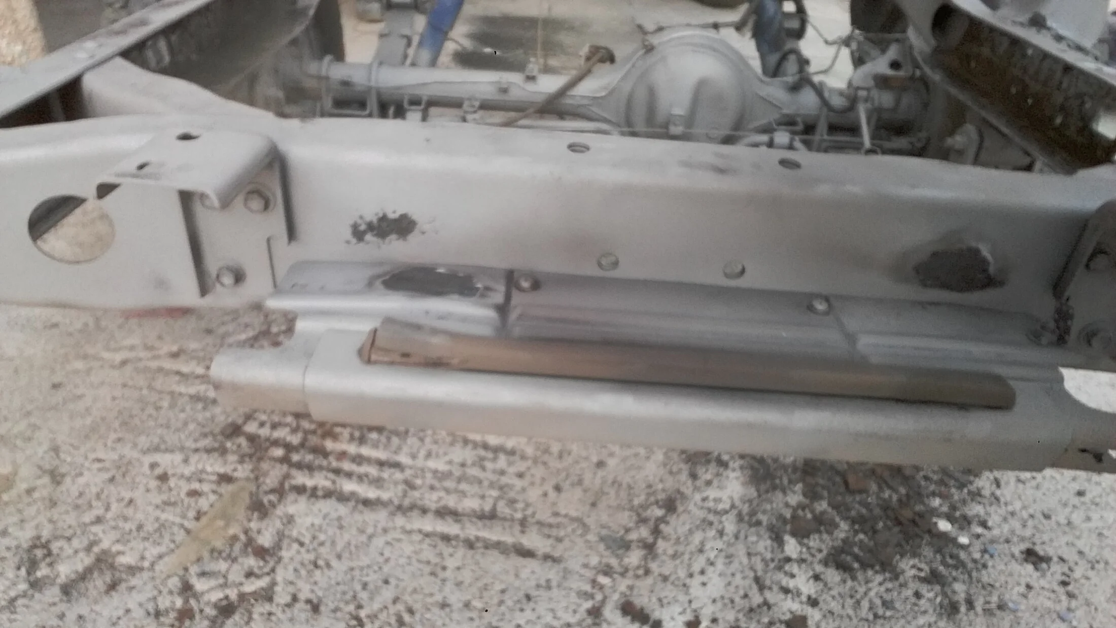

the previous owner use the car to pull trailers with excavators and JCB's and the space at the back it was a nest for a rottweiler...

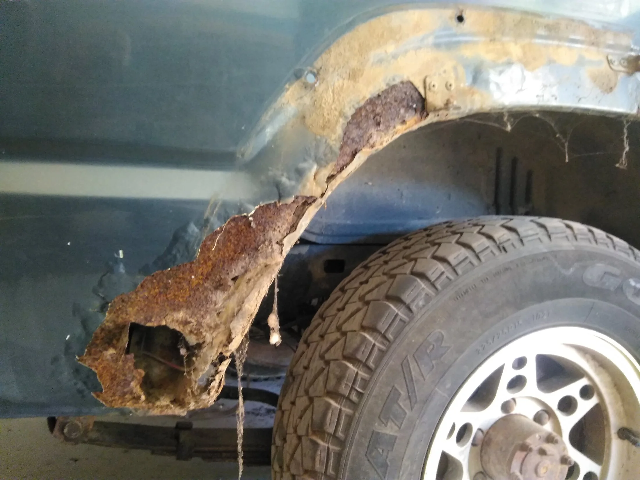

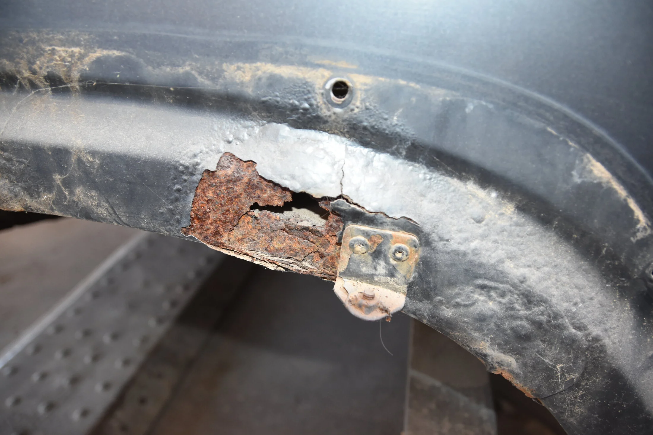

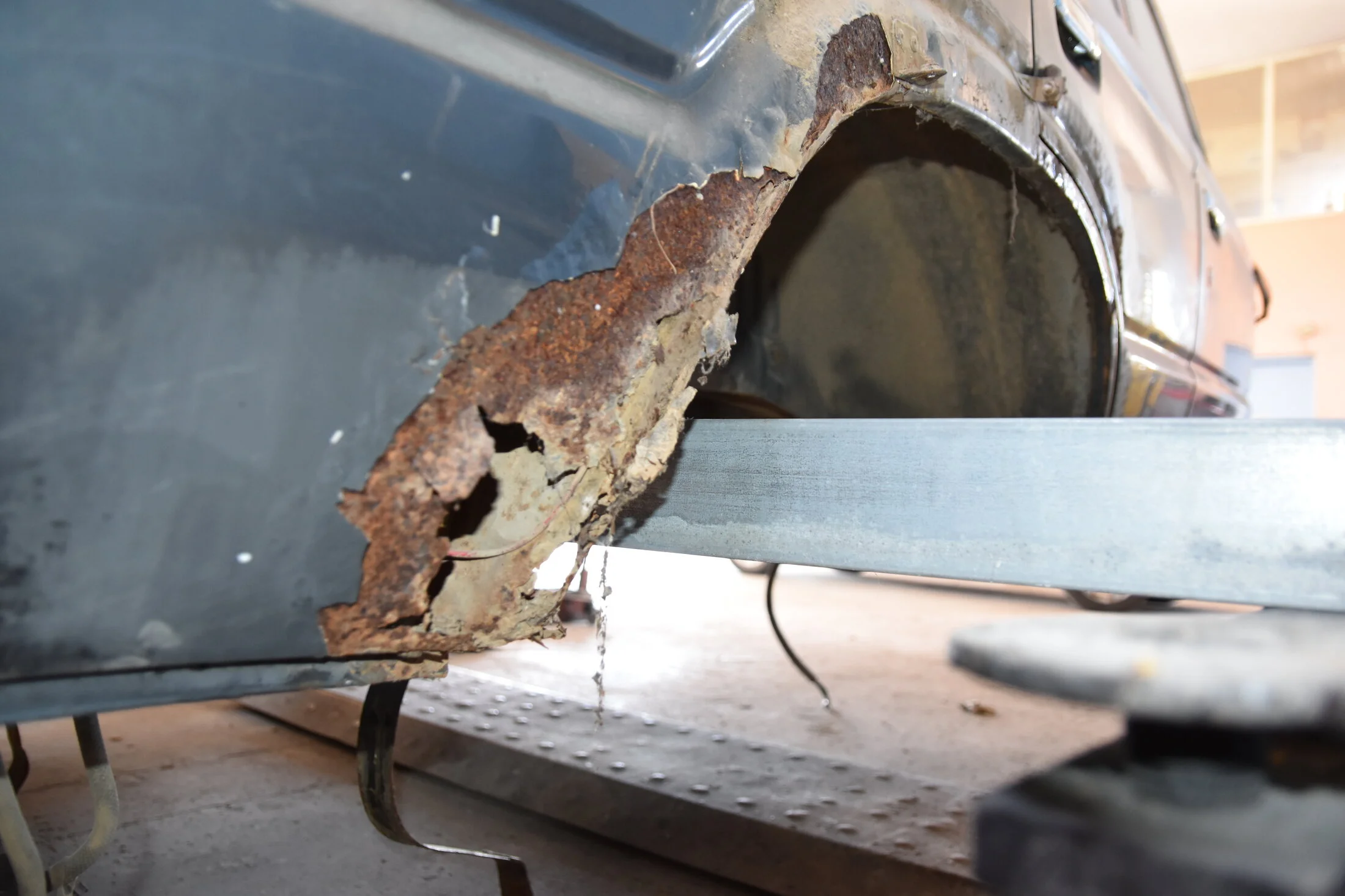

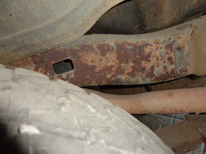

the car came from austria and the rust with the hidden corrosion is more than obvious.
gasoline with 300.000 klm.

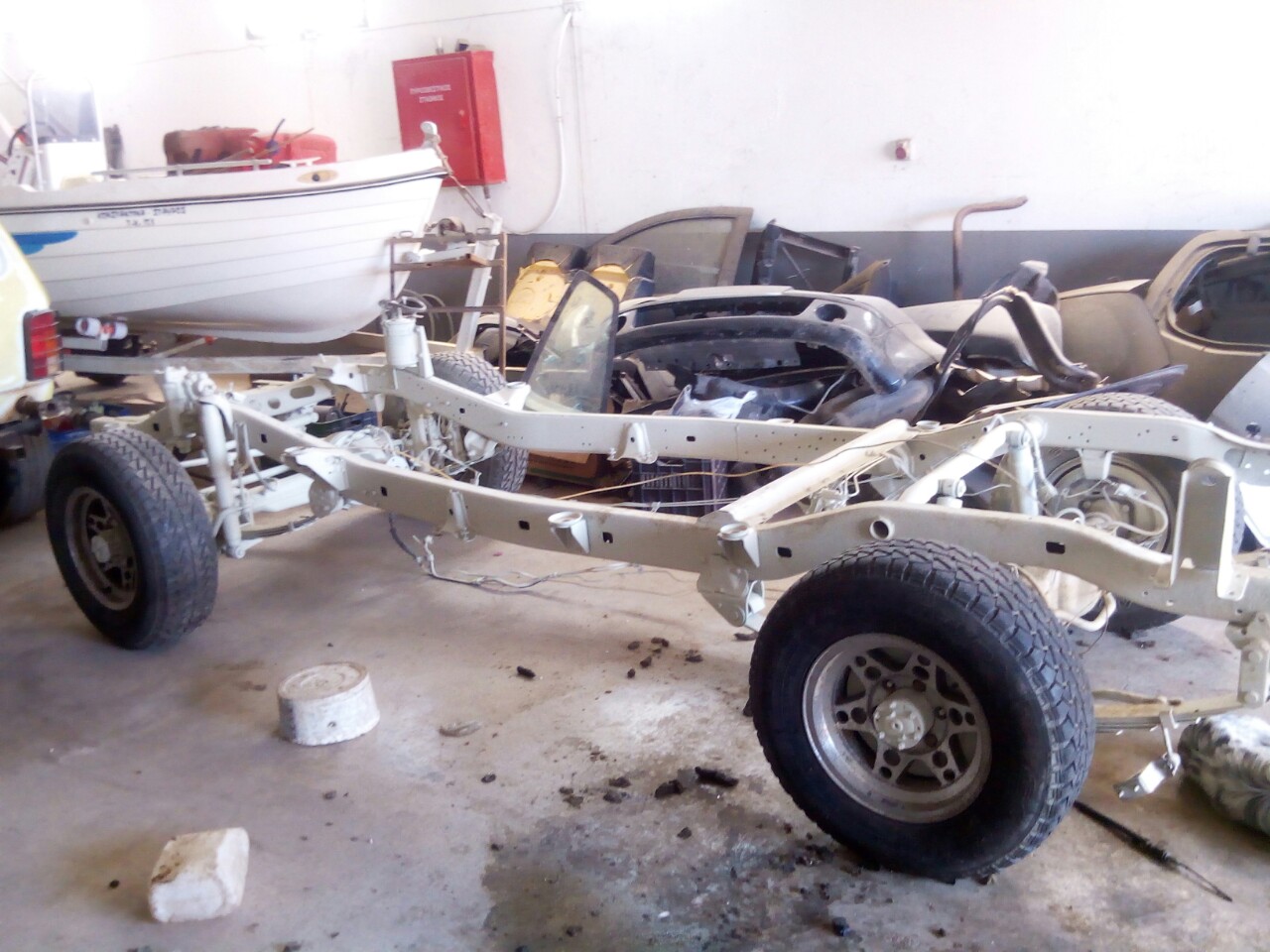

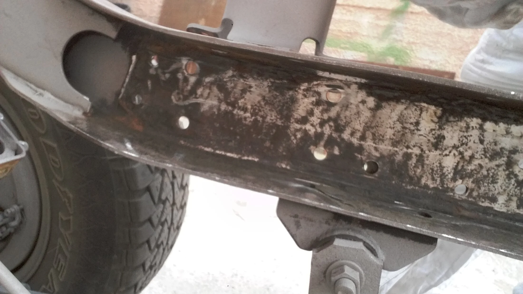

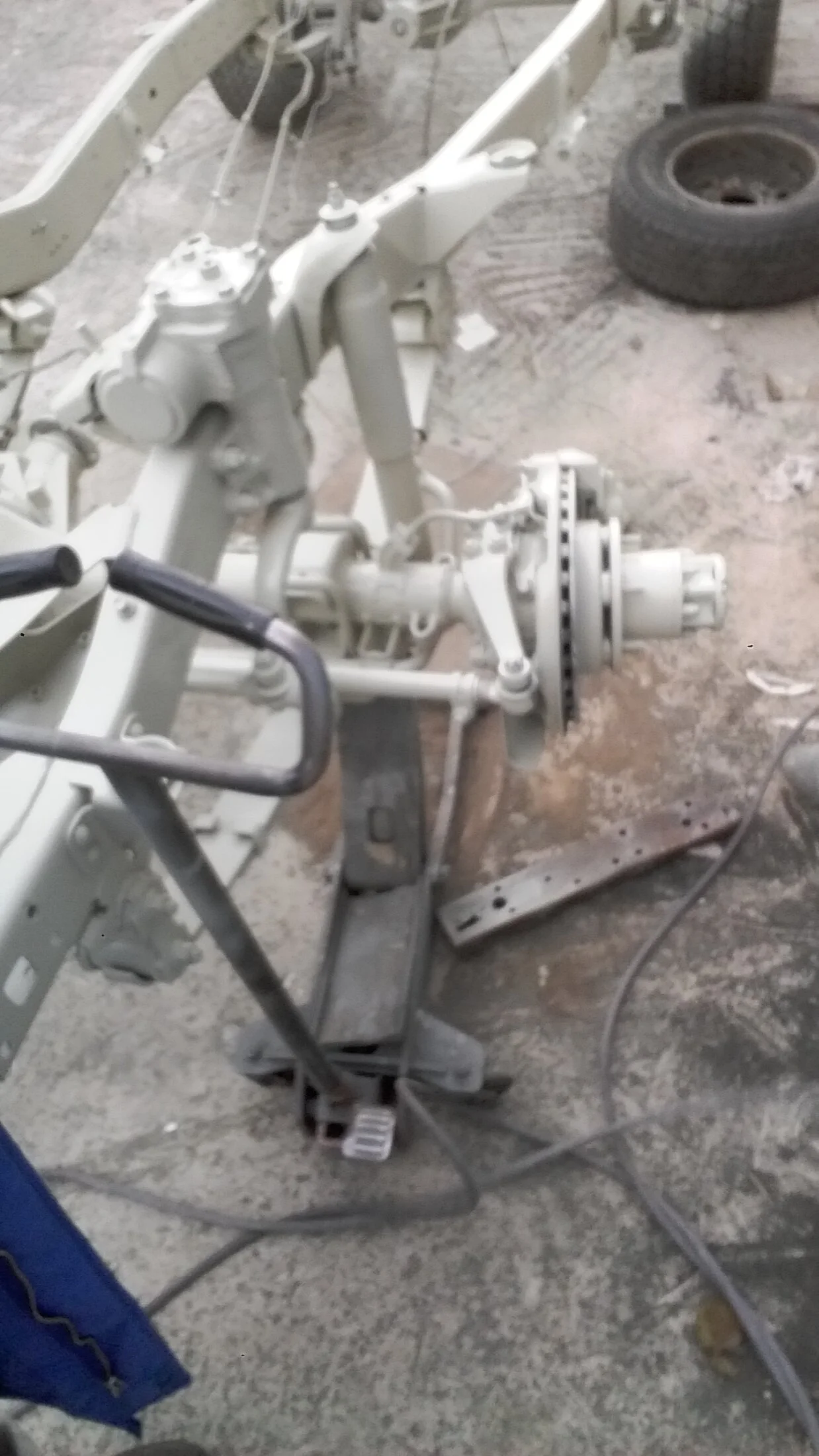

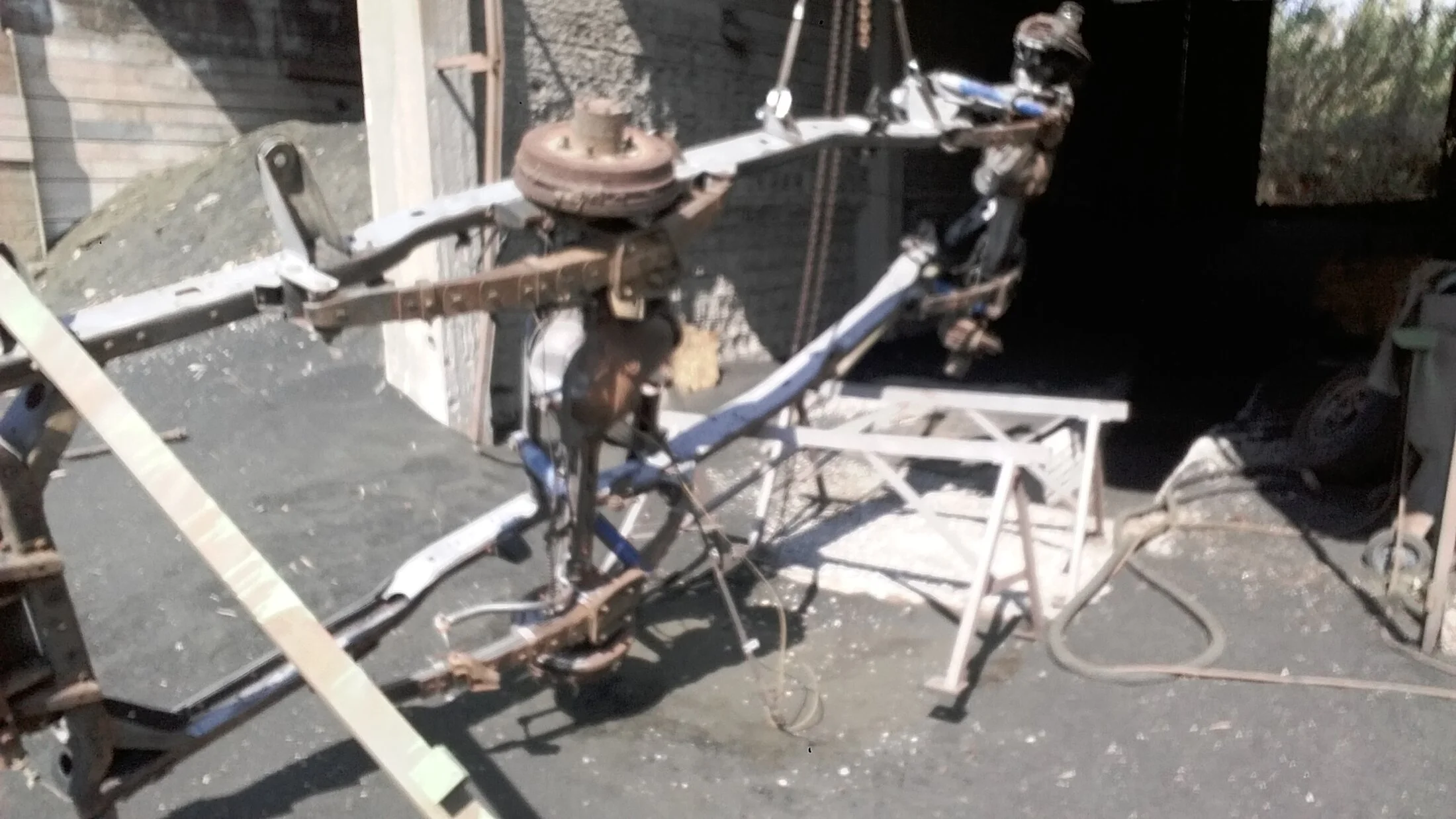

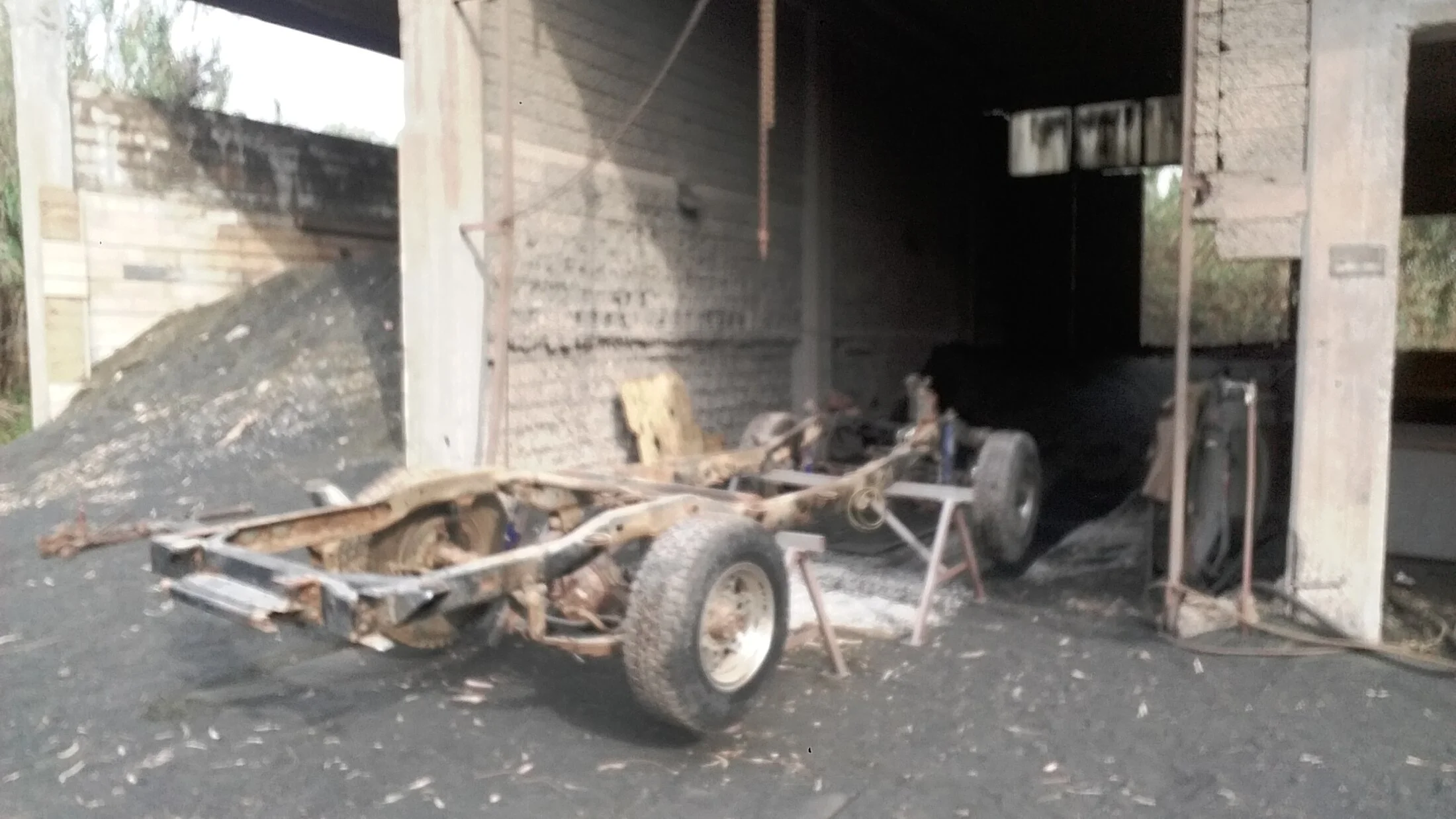

the chassis is ready for sand-blasting.
excessive corrosion to the rear part and needed to replaced.During sand blasting the man almost lose his consciousness so i put him to the table to refresh himself with some juices and continued his task. It was a great opportunity to "hit" the details to the hidden places .cost for sand blasting 110 euro

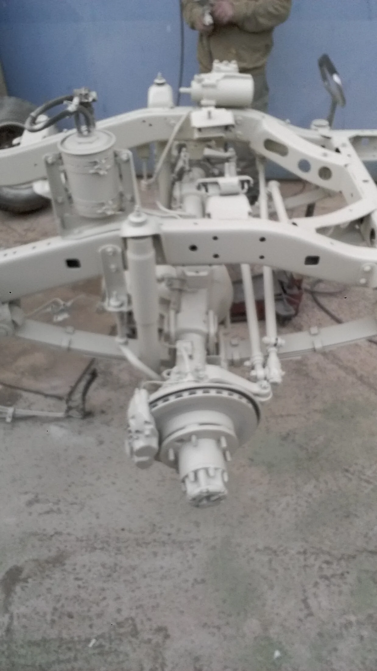

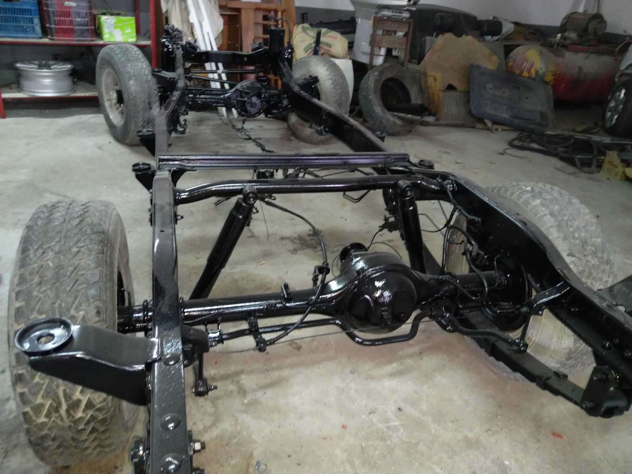

immediately after finish sand blasting ,in less than 30 minutes starts the primer first hand

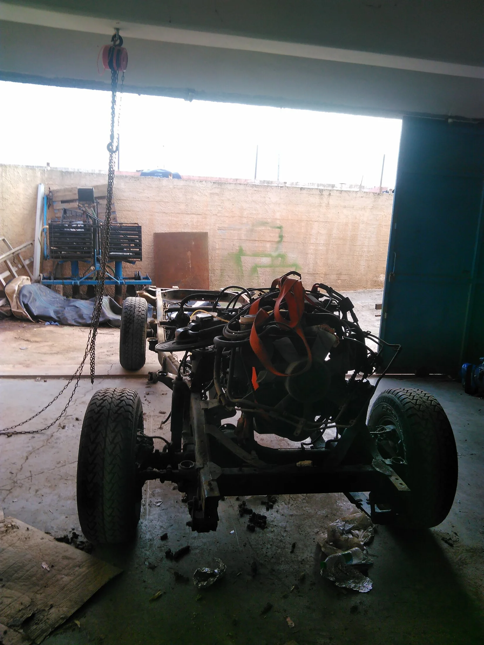

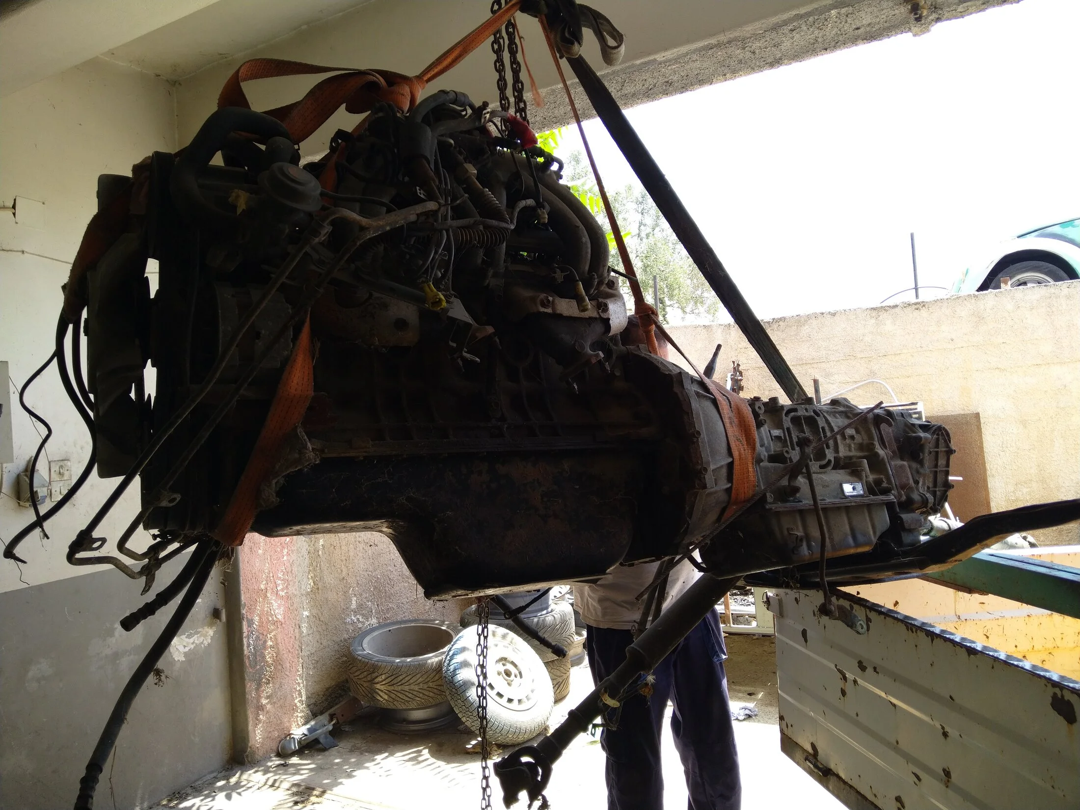

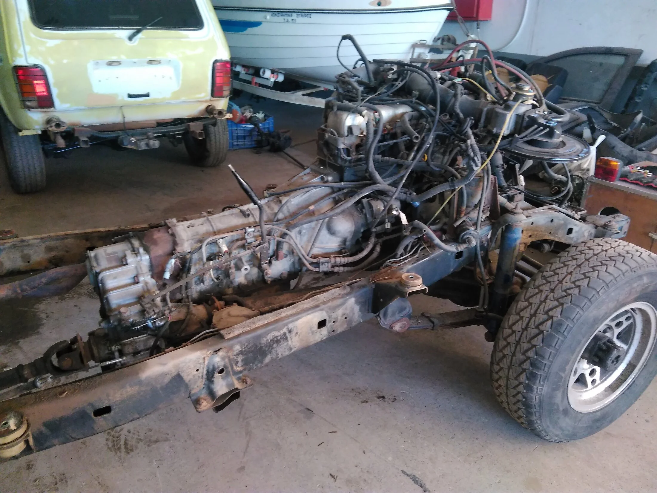

now its ready to install back the engine with the gear box

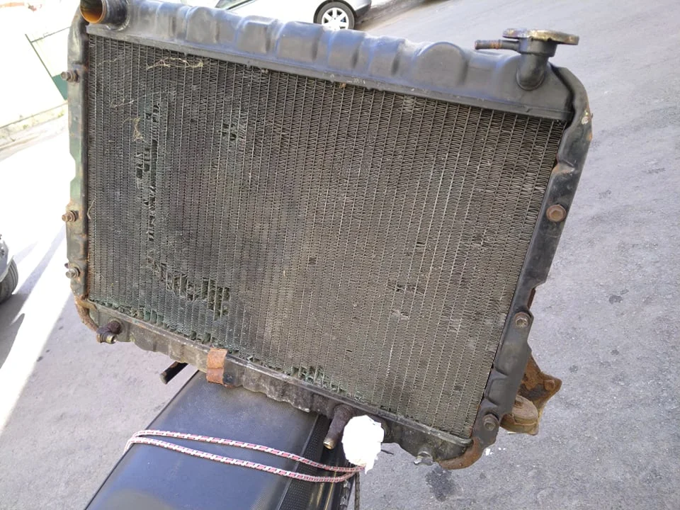

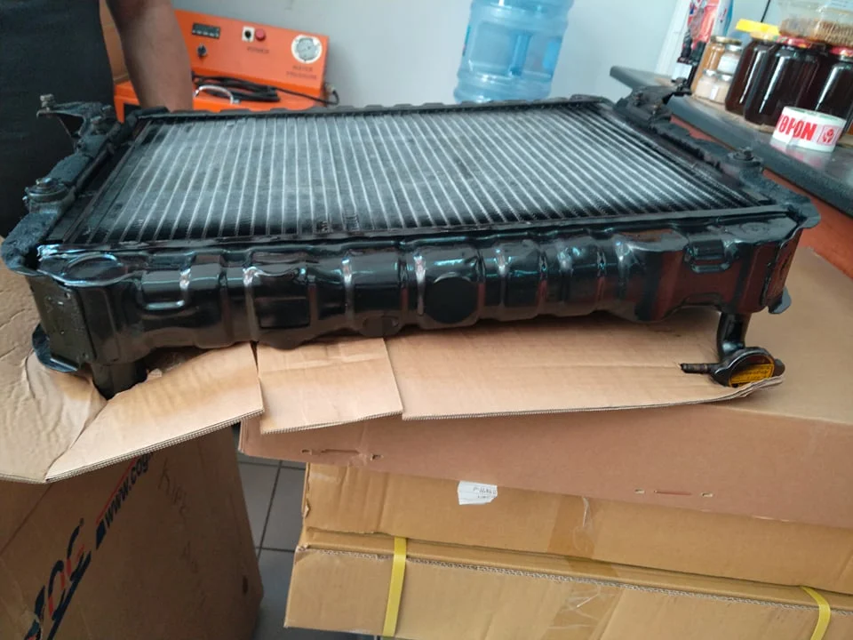

meanwhile the original radiator went for reconstruction. 545 euro it was the cost.

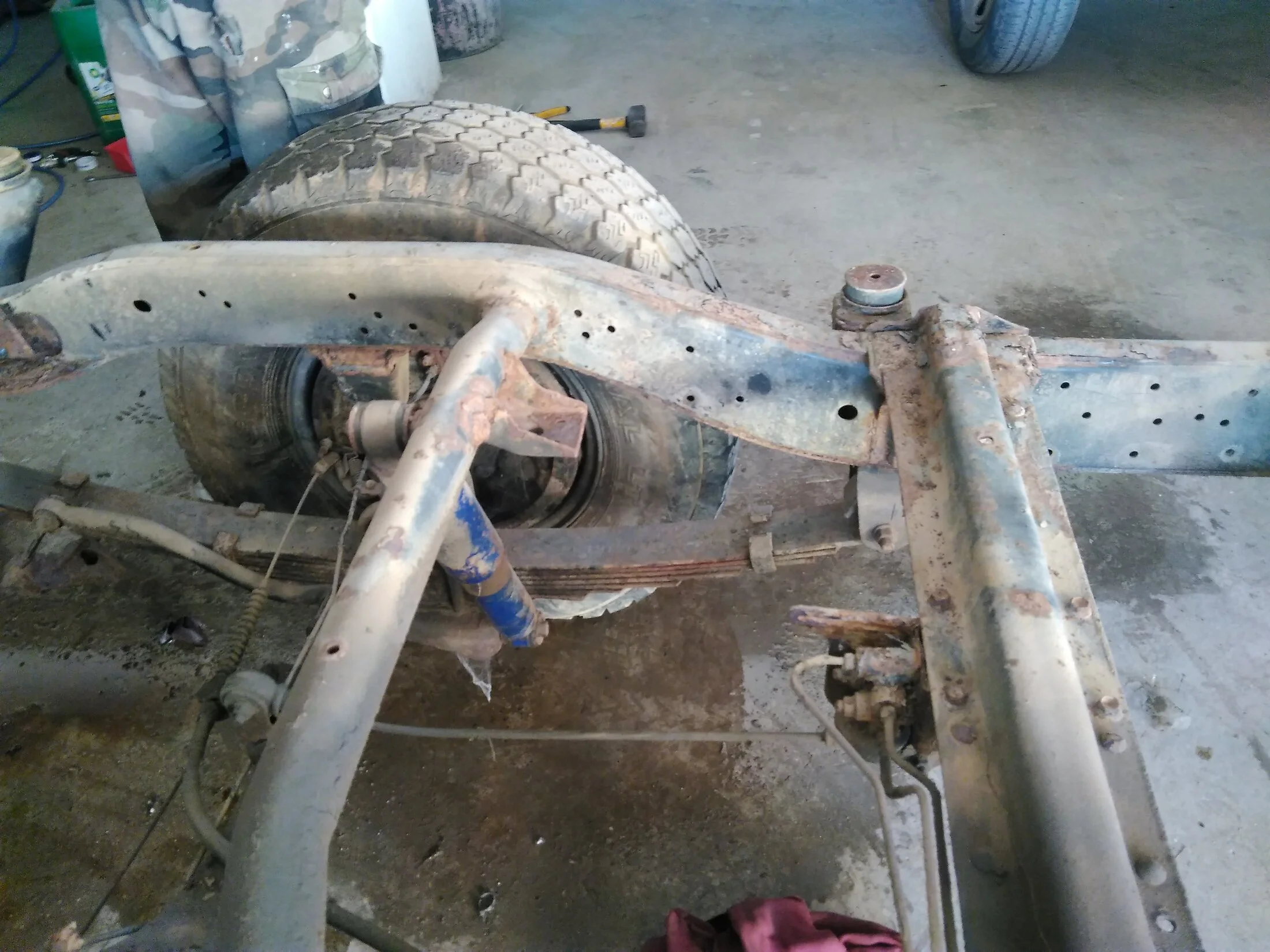

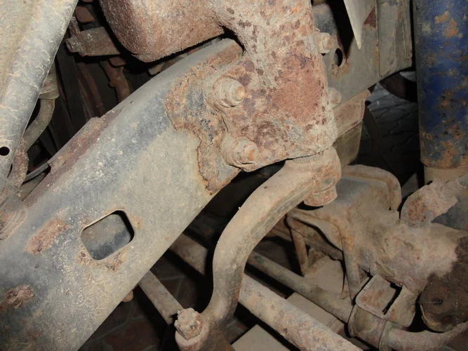

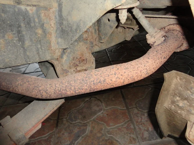

my FJ not have any welded pipes under the seat of the Ubolts ... as my friend's HJ61

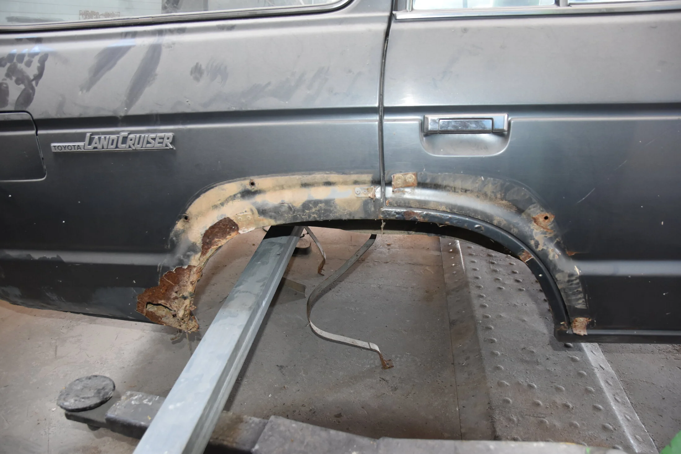

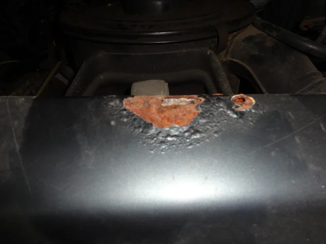

started the repairing of the cabin externally

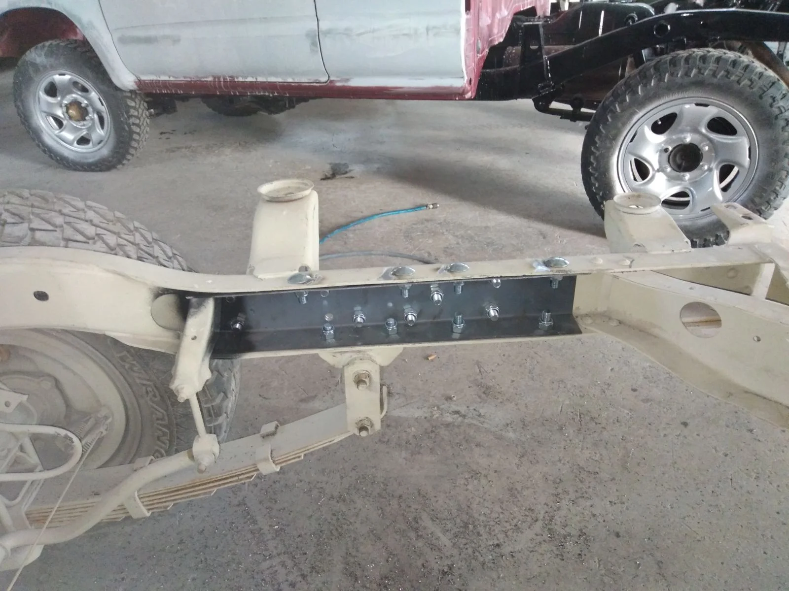

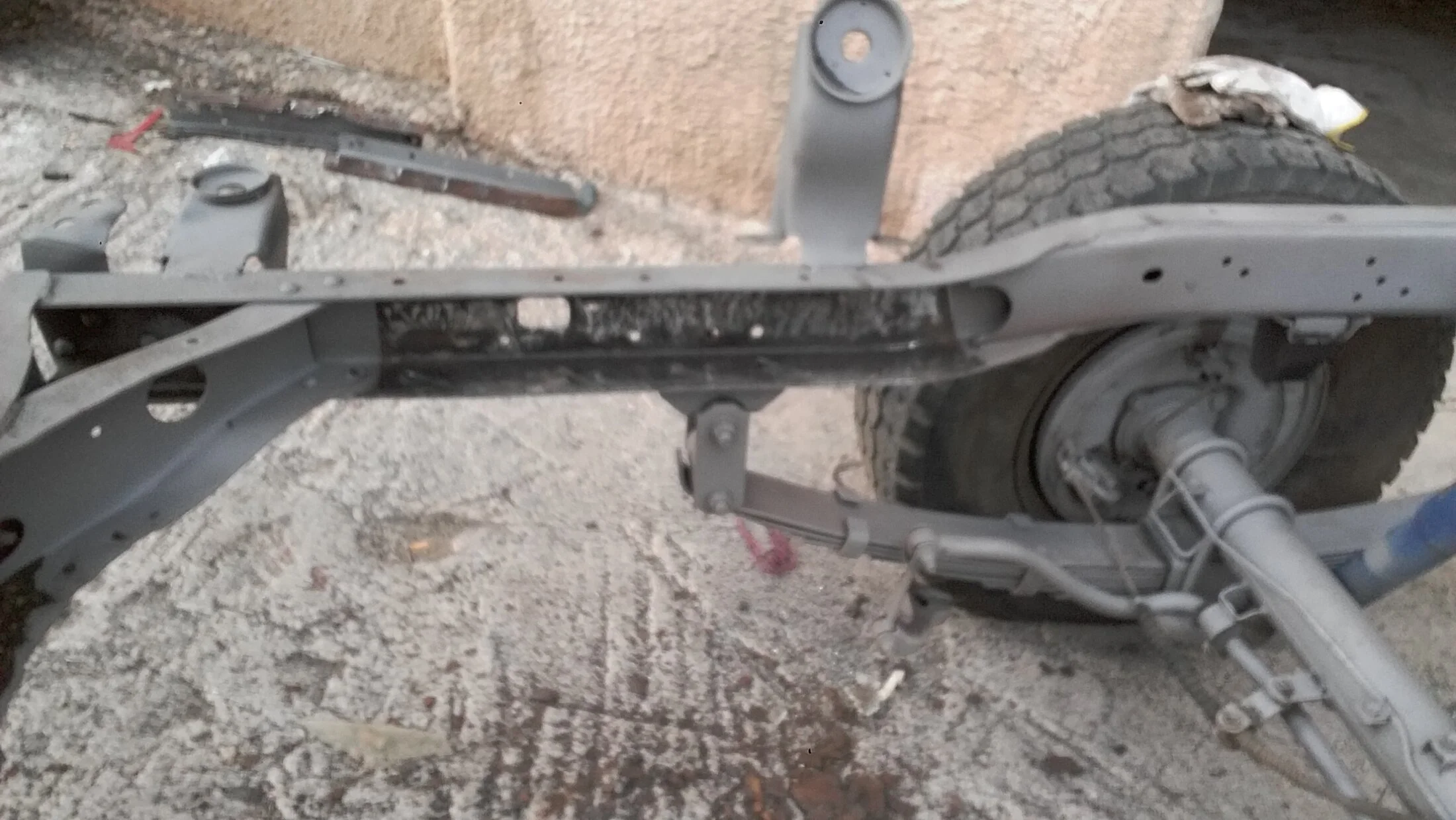

engine went back home.. and at the rear where the excessive rust destroyed the chassis from the inner side renewed the 2 C Channels -pieces with new bolts.

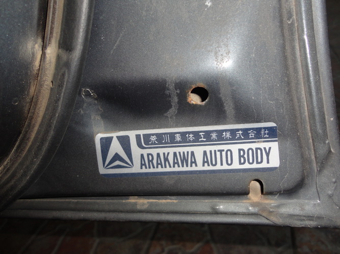

The FJ61 was a Japan only model. I assume that is a 3F/3F-E in which case it should be an FJ62 on the identity plate.
