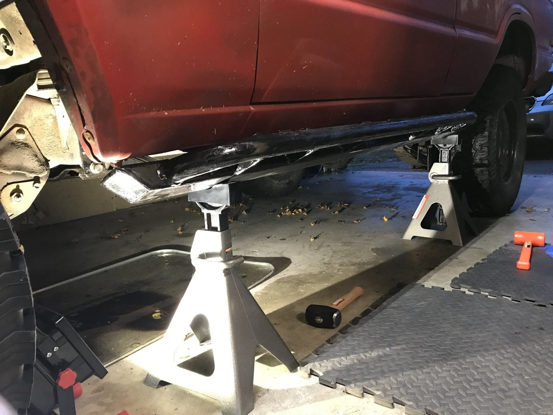

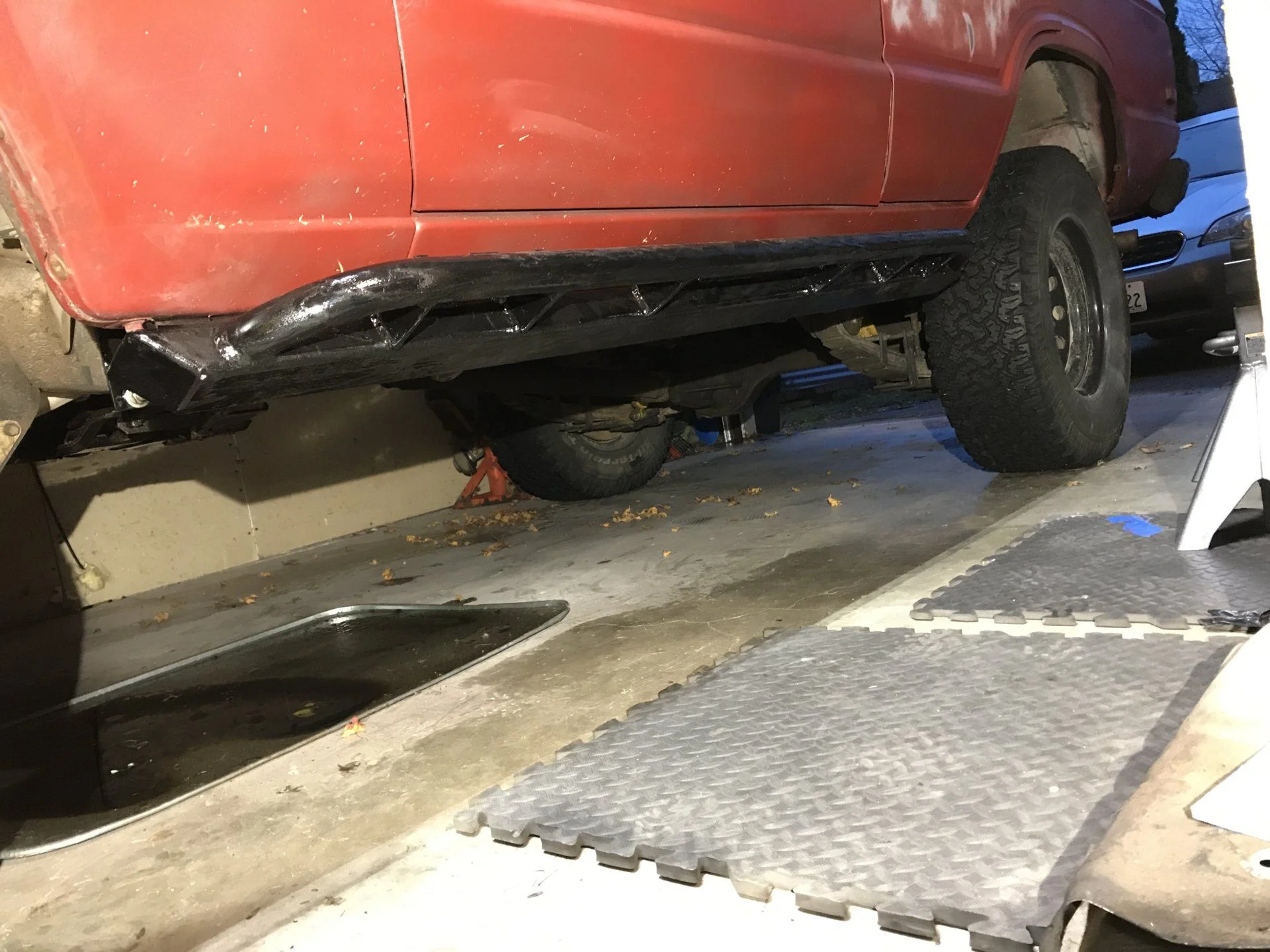

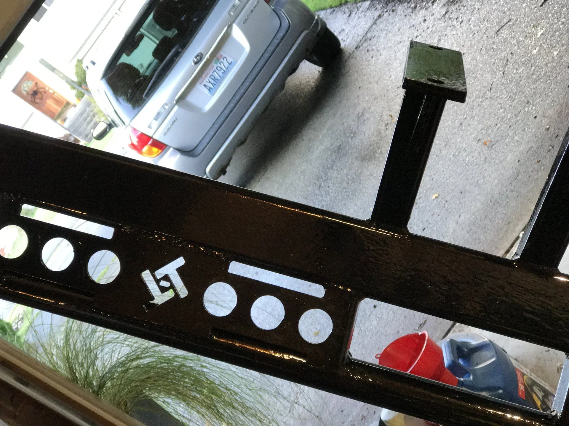

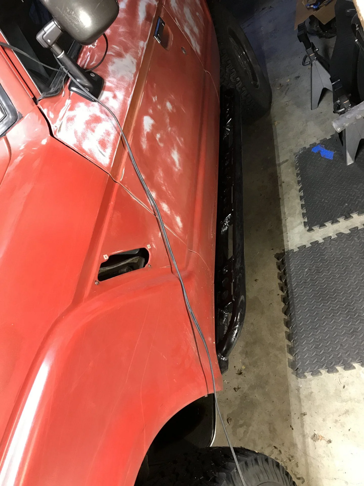

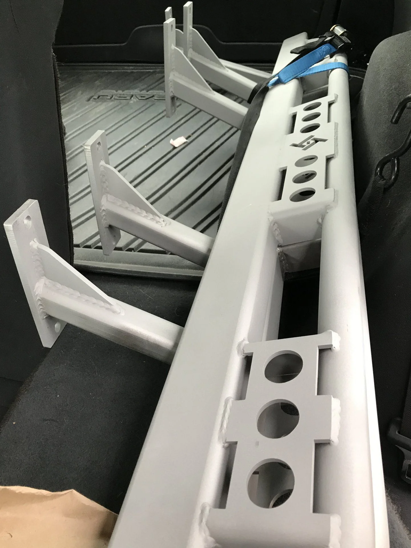

Ordered a set of @reevesci DOM sliders, (beautifully built I might add) over the summer finally got around to paint and mounting the drivers side.
Really easy install (driver side only so far) if you were wondering. Wishing this had been put higher up the list before.
Coated with Magnet Paints "Chassis Saver"
They tuck nicely in close to the body.

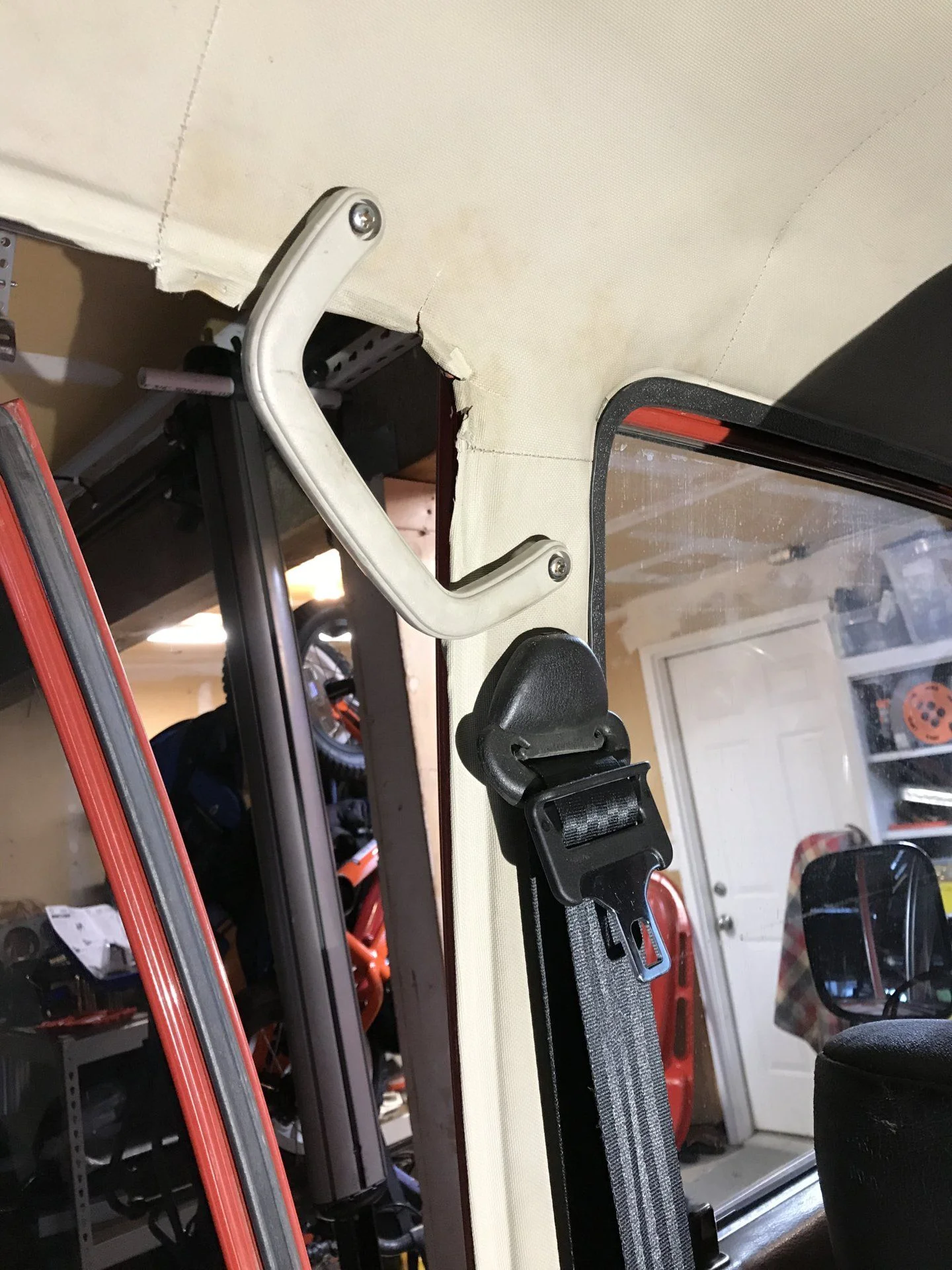

Mounted the drivers side A/B pillar handles on #FitzJ60 that I've had sitting in a bin for a while.

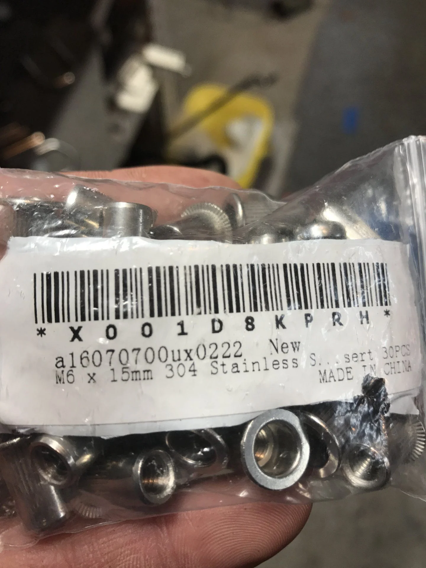

Didn't look very hard to see if the A pillar had threaded inserts, just drilled and used stainless M6 nutserts for mounting.
Rear B pillar was pulled from a HJ61 part out in Kamloops, BC. Crusied up with @red66toy for his FF rear axle and I picked up the rear split seats, also picked up a 38mm transfer case I need to re-build and swap to manual actuators, and swap 3:1 or 4:1 gears in.
I flipped the rig in the garage and hope to get the passenger side done this week.

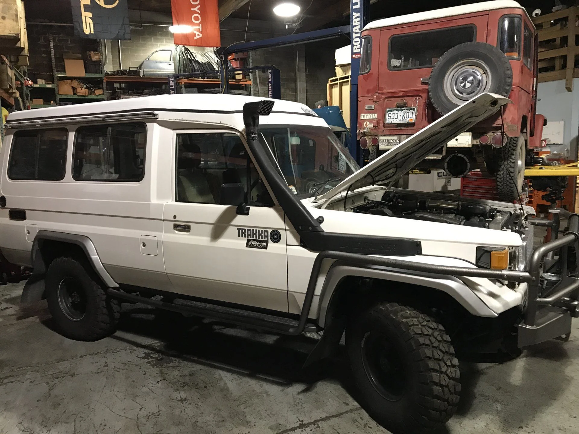

Fella who owns NitroGears new rig.

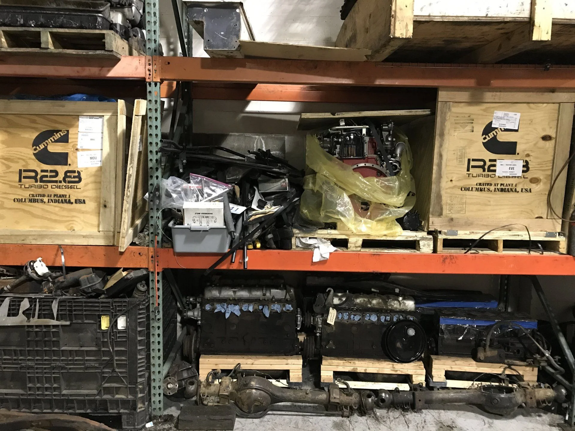

Some lonely looking R2.8's

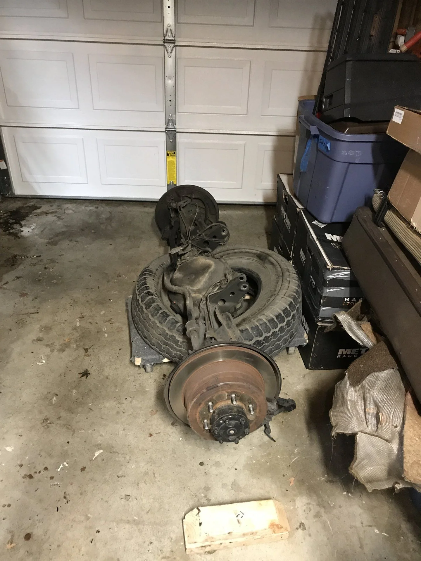

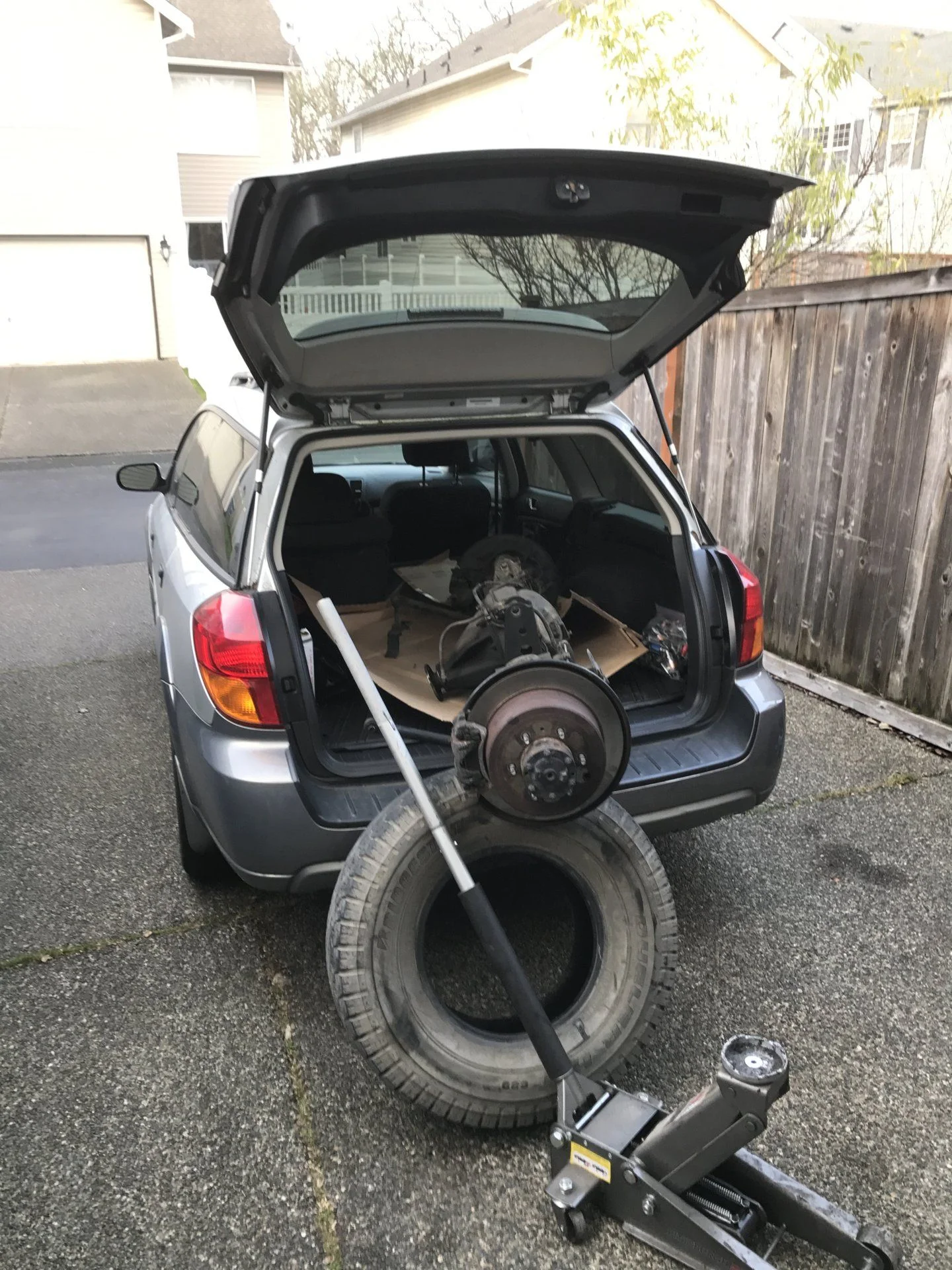

Picked up a FzJ80 rear axle.
Staying with SUA and will be working to remove all the accessory brackets

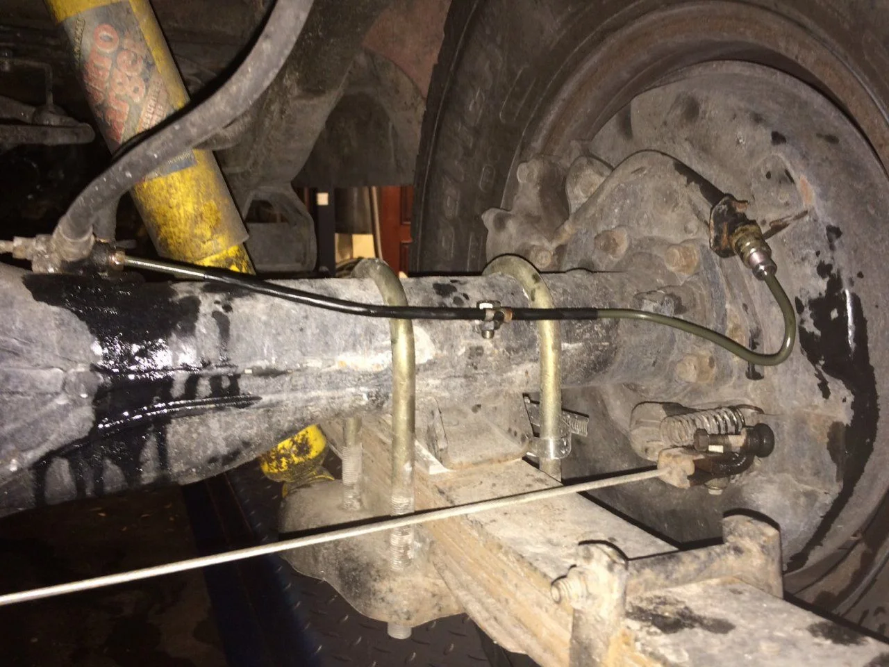

For the guys running leafs and 80 rears, did you stay with the 80 rear brake lines or make something different?
Great upgrade. One of my favorites I've done. I'll dig back through my thread and find what I did for my brake lines.
I drilled and tapped a hole in the top of the housing to reuse the 60 series T-union and soft line (on the 80 series the T-union is on the other side of the differential). The 60 passenger-side axle hard-line is pretty short to use on the 80 axle, so I did this, if I remember correctly it's a prebuilt straight length from an auto parts store. for $10-15 it sure beats cutting, flaring etc.
And for the other side I used the 60 line, probably with some tweaks here and there. I made all the tabs to hold the line on, they are pretty crude, I'm sure there are more elegant solutions. I also needed to make a tab for the parking brake.
